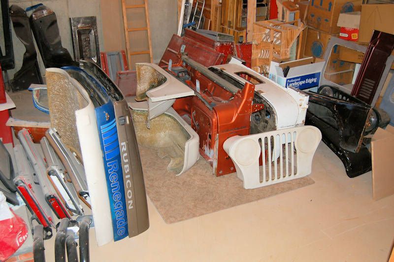

So in this project thread I'll be building a bolt-on "CJ Grille Conversion Kit for the TJ/LJ", with the necessary custom fiberglass body panels to make the installation of a CJ grille on a TJ or LJ look like it came from the factory that way.
I've collected a bunch of CJ and TJ hoods, fenders and even the front sections of both CJ and TJ tubs to provide materials for this project, this photo shows just some of the pile of raw materials that I've collected for this project:
I've done a detailed design and developed a build plan for dealing with all of differences between the shape, lines, and dimensions of the TJ cowl and the CJ grille/hood so that everything lines up properly, and I'll cover the design and technical details of the project in this thread.
