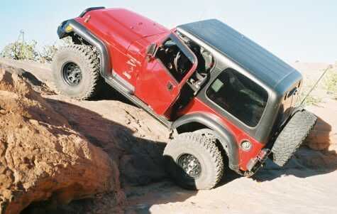

With a carbureted vehicle you don't have to come even close to being vertical to have problems with the float bowl on a carburetor.
Most carbureted vehicles that I've been on the trail with would have problems at this angle:
