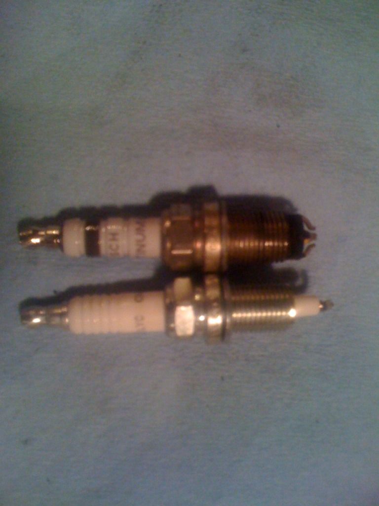

Here is the difference in plug depth and you can see that it's burning rich.
*note* I am getting the same codes and symptoms with the new plugs.
