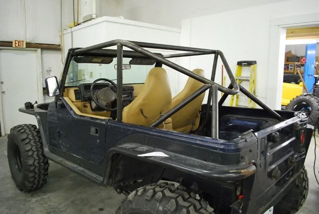

Since we are crazy drivers here, we would like to live another day after a nasty roll. It was time for a roll cage to be constructed. It is going to be made out of 1 3/4" tubing with mostly .120 wall and some .95 wall.
Here is the start of the cage. TJ's look pretty cool without cages don't they?
That is where it is sitting today. We are working on finishing the cage and then we have a few more things to do before we wheel it again. The front springs were meant for a 4 cylinder with no winch, and we now have a 4.7 motor with a heavy front bumper and winch. The front suspension needs tweaking, along with a bellyup/sye and it will be hitting the rocks again.
