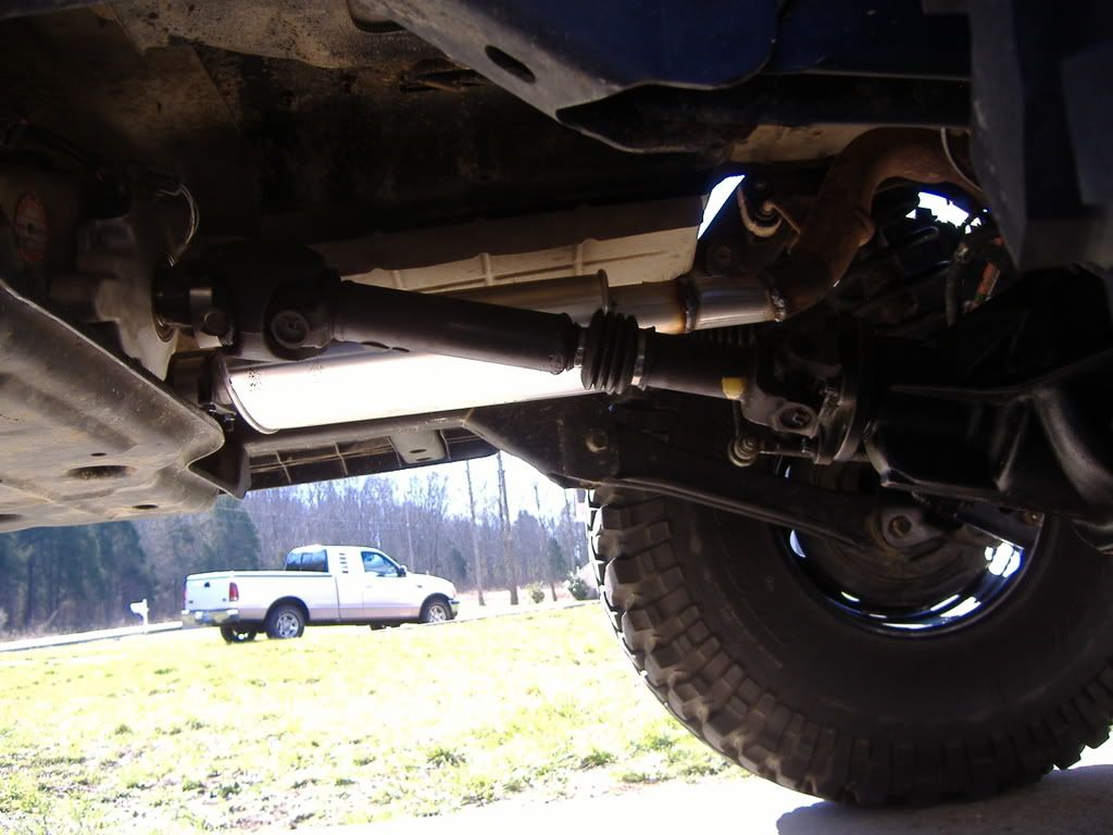

I pulled a CV shaft out of a ford explorer and had it shortend to the correct length. Total cost $130 after replacing the u-joints.
