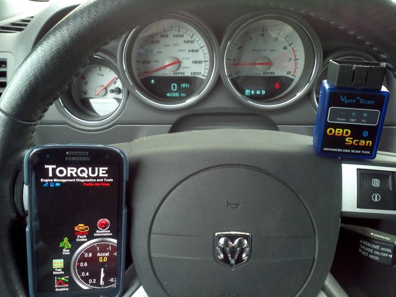

A $20 Bluetooth adapter and the free Torque App for your Android phone. Does everything Scangauge does plus a lot more and looks a lot better doing it. And look mom, no cord.
Exactly. Got the Torque pro for like $7, and works great.
