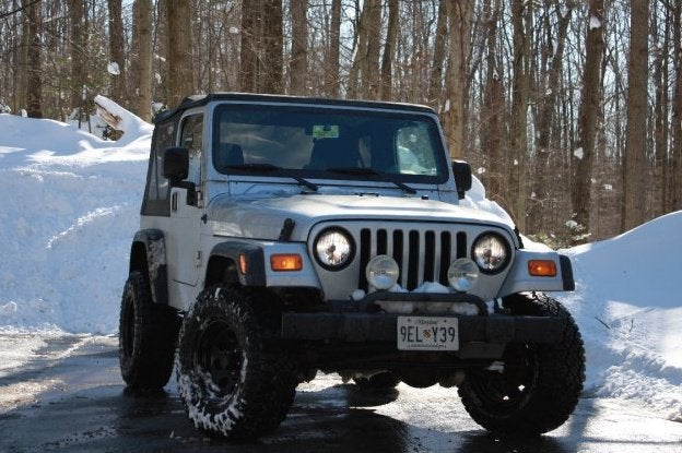

I have an 06 TJ like you, soft top and the I6. I initially netted 3 inches when I first put it on. It has now settled to 2.25 inches. I'm very happy with it. Get the MML and drive the Jeep first to see if you have vibes, if you get them, throw on the MML. I still have vibes with the kit, and the MML . Combo of D44 and the auto makes the DS real short. You'll like the ride of the BDS, not to stiff, not too soft, reduced nose dive on heavy braking too.
Here are some pics, I'm running 31s. Gonna get a 1.25" body lift and run 33s. This was before I had the MML so I still have that stupid t case drop.

Idk why i still have vibes to be honest, if I take the MML off my vibes will be worse (actually, I don't know that because I haven't driven the jeep with the springs settled with out the MML yet, just dont feel like taking it out). They are tolerable for now as they are minor now. Regardless, When i come into money I'll be investing in an SYE and double cardan rear driveshaft. The adjustable track bar was want and need for me, my stock one got twisted up and I needed a new one, so I killed 2 birds with one stone.
My dad bought me those bezels from 4wd.com as a present to me for my Jeep. You can just paint them though, just scuff up the stock ones and paint em with some krylon fusion and bam, black bezels.
