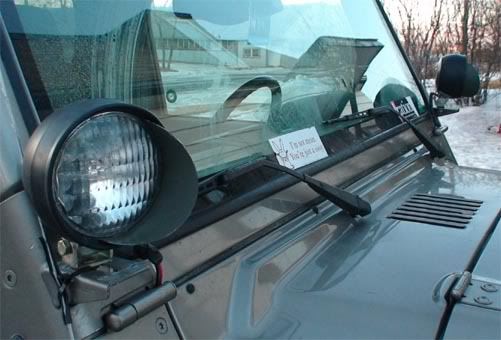

If your using kc hilites windshield brackets, just zip tie your antenna back behind the light through the mounting slot. It will keep the antenna in place and won't bug anything.
Slightly hard to see in the pic, but you can just make out where I have it zip tied through the bracket and also shrink wrapped to prevent grinding on the bracket.
