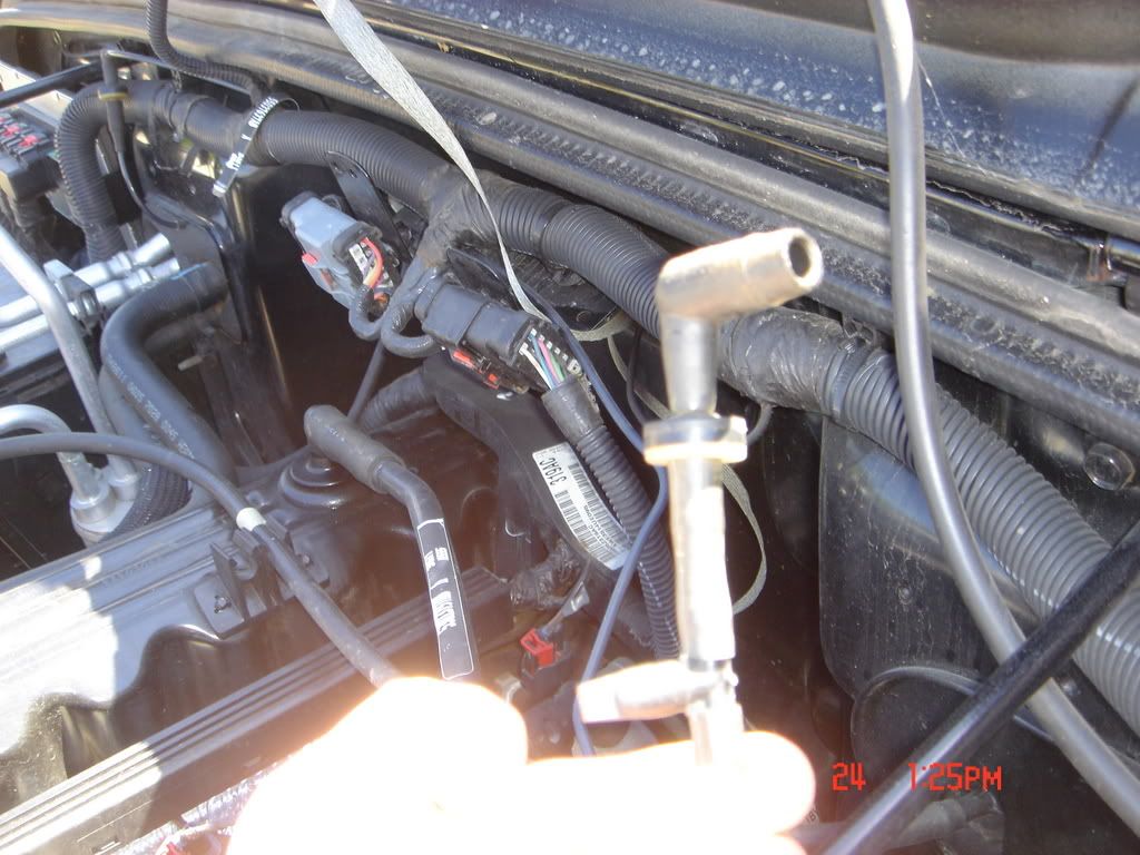

Originally Posted by The Keith View Post
if it's disconnected from the manifold, you're cruise control won't work either. Mine keeps slipping off the nipple there...
pics? This is exactly whats happening to me...
-2003 Rubicon 4.0L with 5 spd- RE 3.5 SF lift, OME shocks, 33X12.50X15 Good Year MTR's, Mickey Thompson Classic Lock II's, Rokmen Mercinary front bumper, warn winch, Alloy USA axle shafts, Warn Rear bumper with tire carrier, Poison Spyder Customs Rocker Gaurds, Rubicon Express Chromoly Tie Rod, Rubicon Express steering stabilizer
xulcuz is offline
post #5 of 224 Old 03-02-2008, 11:18 AM
Scotch740
Scotch740's Avatar
Join Date: Apr 2004
Location: Charlottesville VA
Posts: 2,334

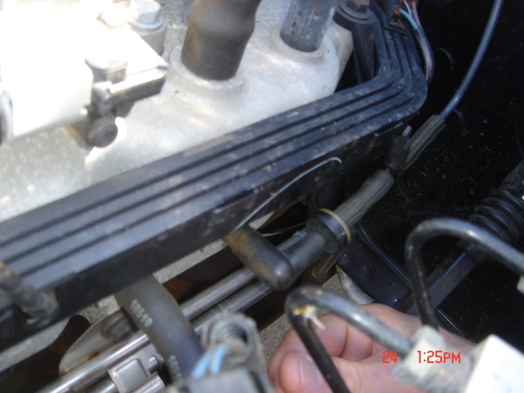

This is on the driver's side of the engine.
Scotch740 is offline
THANK YOU! I have been only having me heat on defrost all winter and it was really bothering me! Im a newb and never new that was even there but thank you again so much. The fitting was really really lose so Im gonna tighten it up tomarow! I just wish i would have discovered this before winter......
I have to say thanks also, this was exactly my problem.
