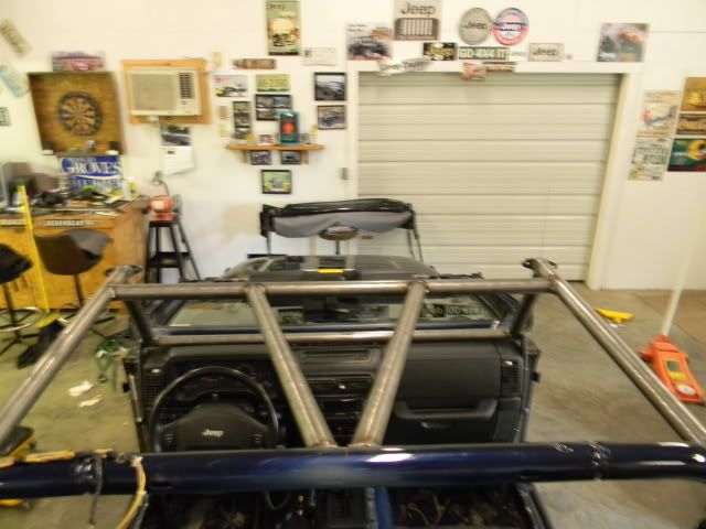

BTF sport cage
Cage fit very well, and no problems with install. Still have to add some grab handles.

Thanks for pictures of a BTF sport cage. Can you take a picture or two of the A pilar where it meets the flat stantion bolted to the dash.
Sport cage is next in my list of mods.
Thanks.

mrfast
mrfast's Avatar
Location: Missouri
Posts: 197
Thanks, and I'll post some more pics tomorrow after I get home from work.
