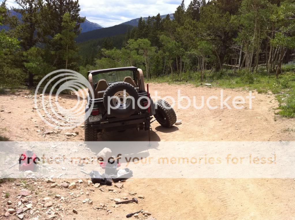

I was on the trail Saturday and wouldn't you know it I almost spent the night.

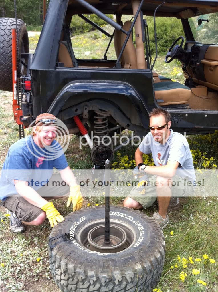

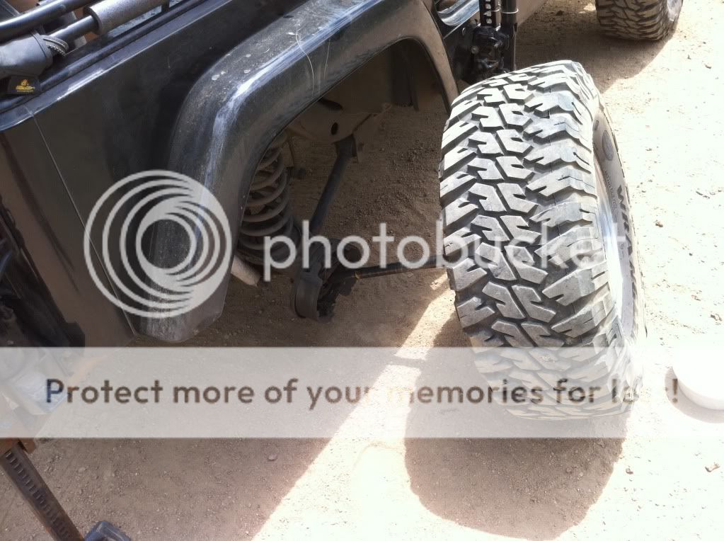

As we were about to head down from the top of the hill my wife asked if the wheel is supposed to be sticking out that far. I replied, "what are you talking about." By this time she is yelling stop, and I quickly rush to park the jeep. I jump out and walk around the car. What I find is my tire completely fallen off with the axle shaft attached to it. I have become another victom of the Dana 35 rear end.
Not to put all blame on the axle, I did break it trying to tow a buddy who's engine died. It made a loud pop like someone shooting a 45 off. I could feel it right away once I unlanched from my friend. I knew something was wrong.
So here is my questions, I have a 97 wrangler with 33's on a 3.5 rubicon lift. I have a detroit locker in the back with 4.56 (also another aid in breaking the axle). It looks like all of my rear end is completely in tack. The shaft broke midway down. The bearings on the side of the axle are mangled and the break pad doesn't look so good either.
