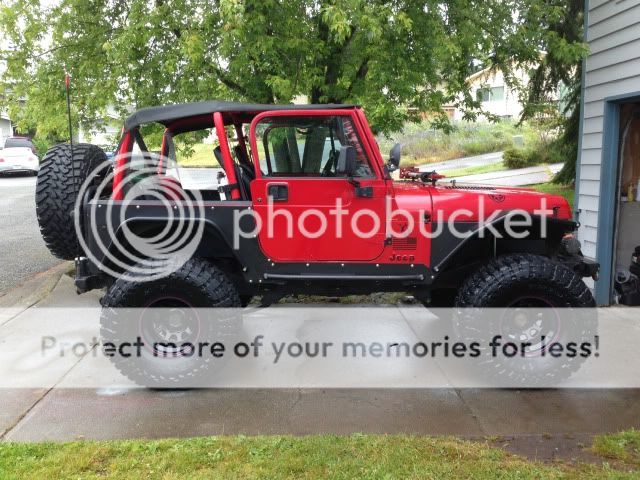

I can find within this forum a lot of 8.8 build with 37 and larger tires... but none with a D35 in the time I just spent looking.
This one is 37" and 8.8 rear...
https://www.jeepforum.com/forum/f12/h.../index219.html
