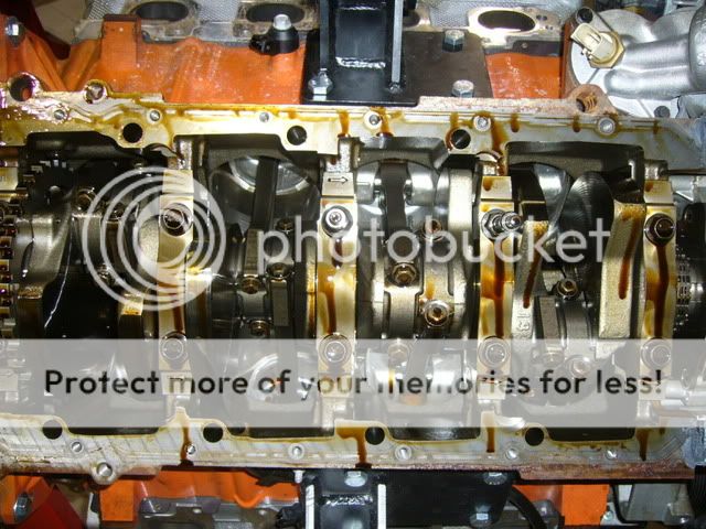

ok as promised.. more pics
6.1 getting ready for the stand with stock SRT8 cast oil pan
factory pan off.... oooooohhh pretty inside

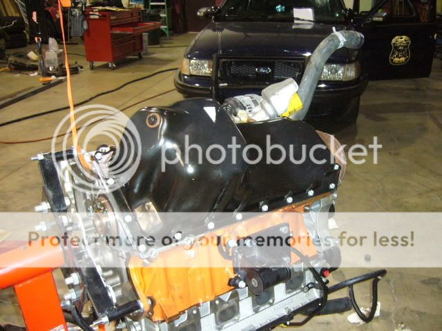

new 5.7 pan installed
6.1/5.7 hybrid mounted up to the 545rfe trans, new flexplate, dust shield, starter etc...
