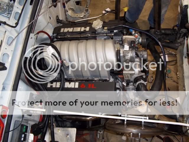

ok got a new camera, however...left the owners manual for it at the shop.. so pics tomorrow.
further progress...
after some prep work, got the drivers header on and o2 sensor in
got the hydroboost mounted
brake distribution block mounted
NLVP purge valve mounted after fabing up a bracket
new gas pedal mounted
heat loom on the wiring where it should have it
picked up the new oil pressure sender.. now have to get a square head socket to get it out
installed, removed, installed, removed the cooler plate and swapped things/fittings about 10 times trying to get the best routing on the hoses.
chassis and body grounds in
changed my power feeds around alittle bit
messed around alittle more with the snorkel and piping.....
have to drop the fuel tank to get the new harness in... the tank has to come down anyways because i ordered up the genright rear shock kit and i want to reinforce the frame where im doing the french cutout. by the time im done it will be stronger than stock and take all the beating without worry.
going to send some of the extra stuff back and need to order a longer shaft for the steering.
as it comes together i see alot of small-tricky-little things that are going to have to be fabbed... just like the nvlp bracket and clearancing the stock brake bracket to fit on the new MC.
then its going to be fab time on the lift, steering and brakes... hmm axles and tires would be nice.
thinking about some full corner aluminum armor with the wider openings [2.5" all around.. does any one know if the stock flares can be adapted to this. thinking about having the armor color matched to the jeep
going to pull the stock rear inner fender plastics and leave them off. ill spray the wheel wells black though for asthetics.

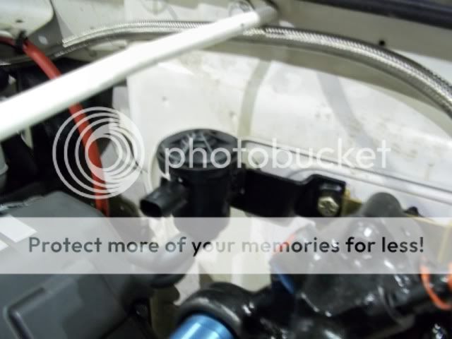

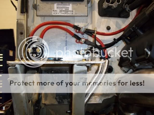

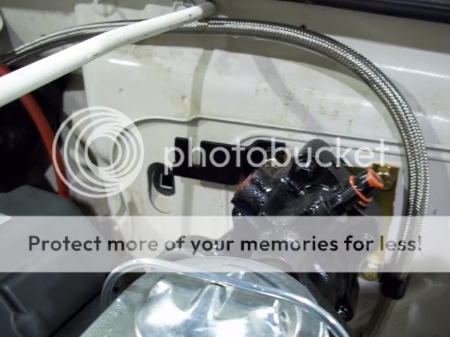

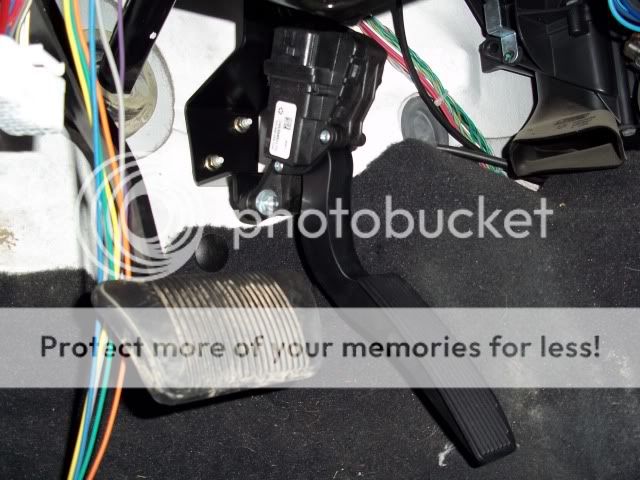

ok...have pics....
new 1600 series ps pump
new power/battery tray... the batteries are going inside the jeep. going to stuff them behind an insta-trunk.
new pedal assembly in
new nvlp purge valve braket and install
hydroboost..
little top down teaser....

nvlp system is plumbed

thanks
not yet on the corners... think im just going to wait until i '''neeeeeed'' them
full hydro baby... took a break to jump on here. tacked the valve mount in and mocking in lines now. cooler plate is in, hopefully for the last time pulled a kilby steering skid thats been on the shelf for a while and got everything to fit in the 'stock steering' location. im happy with that result
need to get more trinket stuff fromt summit for securing the lines and starting the brake plumbing. going to send back the deep trans pan.. theres no way without serious fabing of the skid plate and i dont want to do that or have that look right now.
ill post more pics later tonight...
