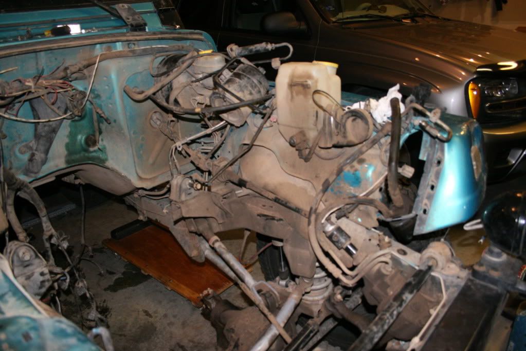

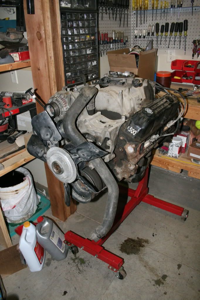

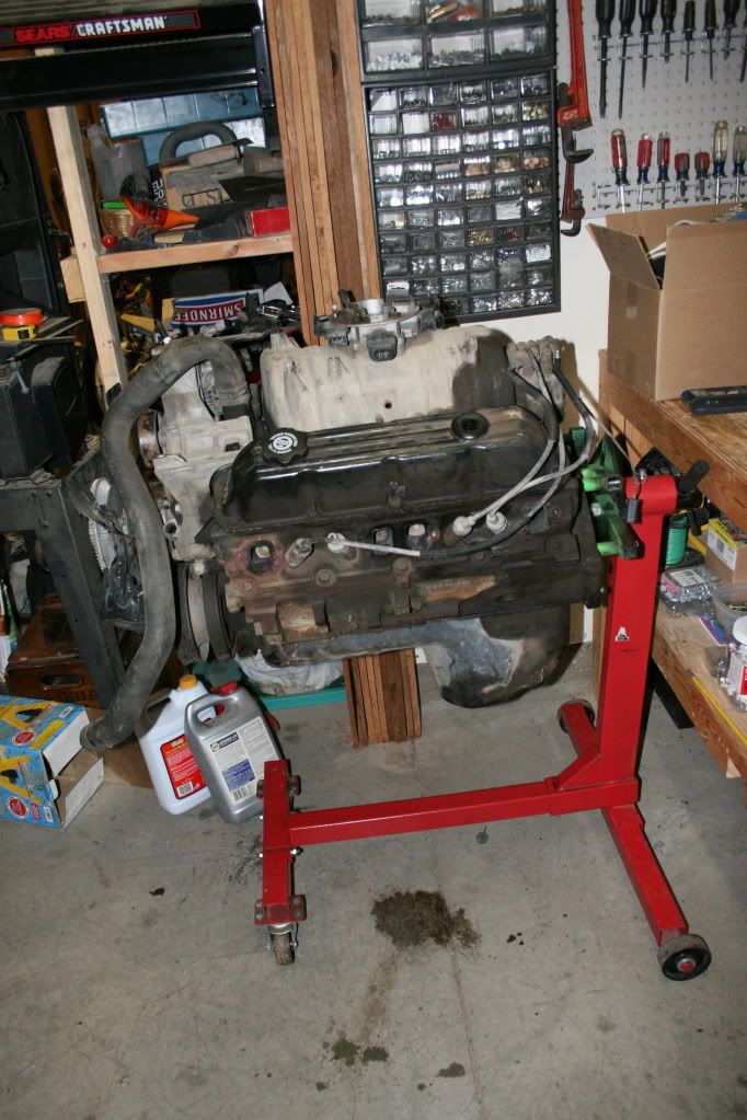

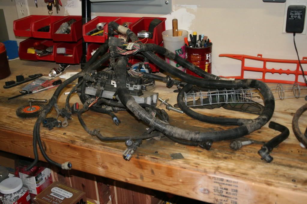

Picked up a 318 out of a 96 Dodge for 200 bucks
Complete with harness even!

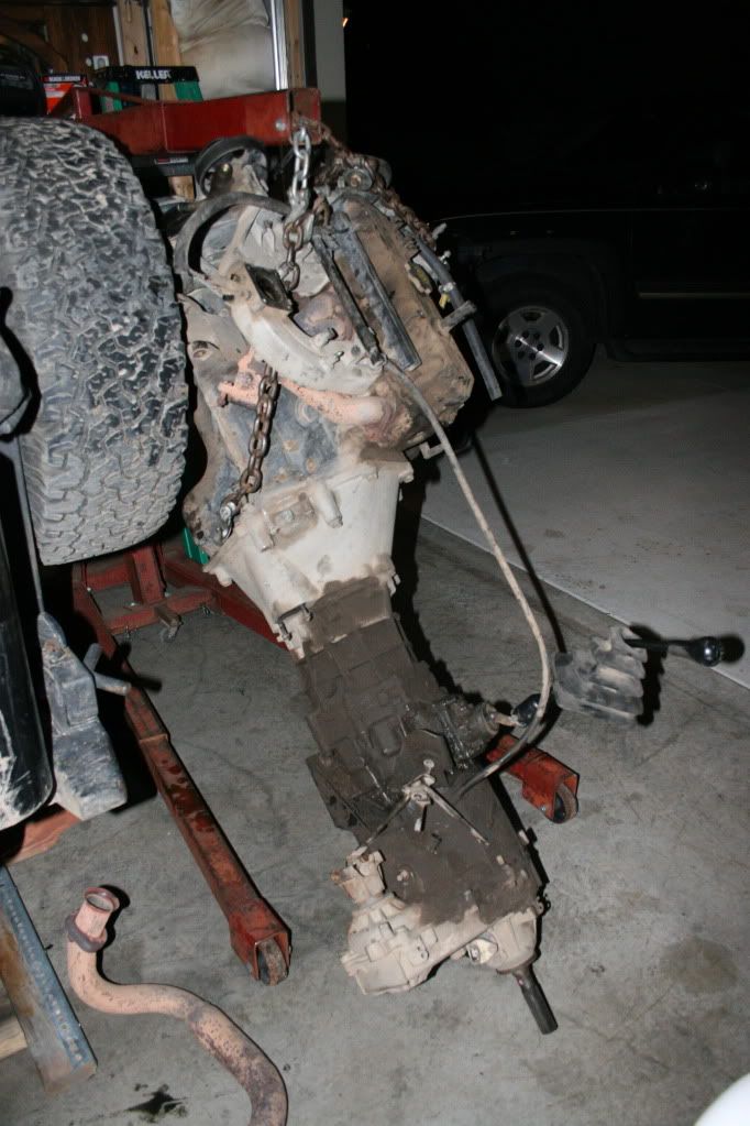

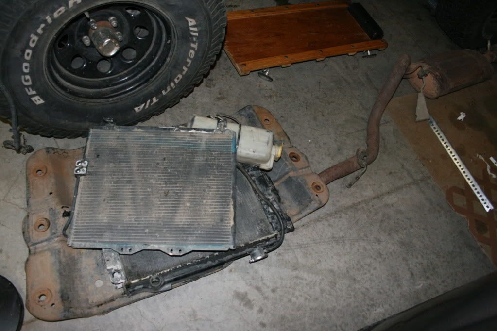

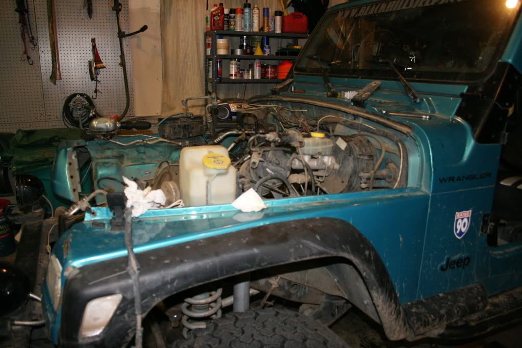

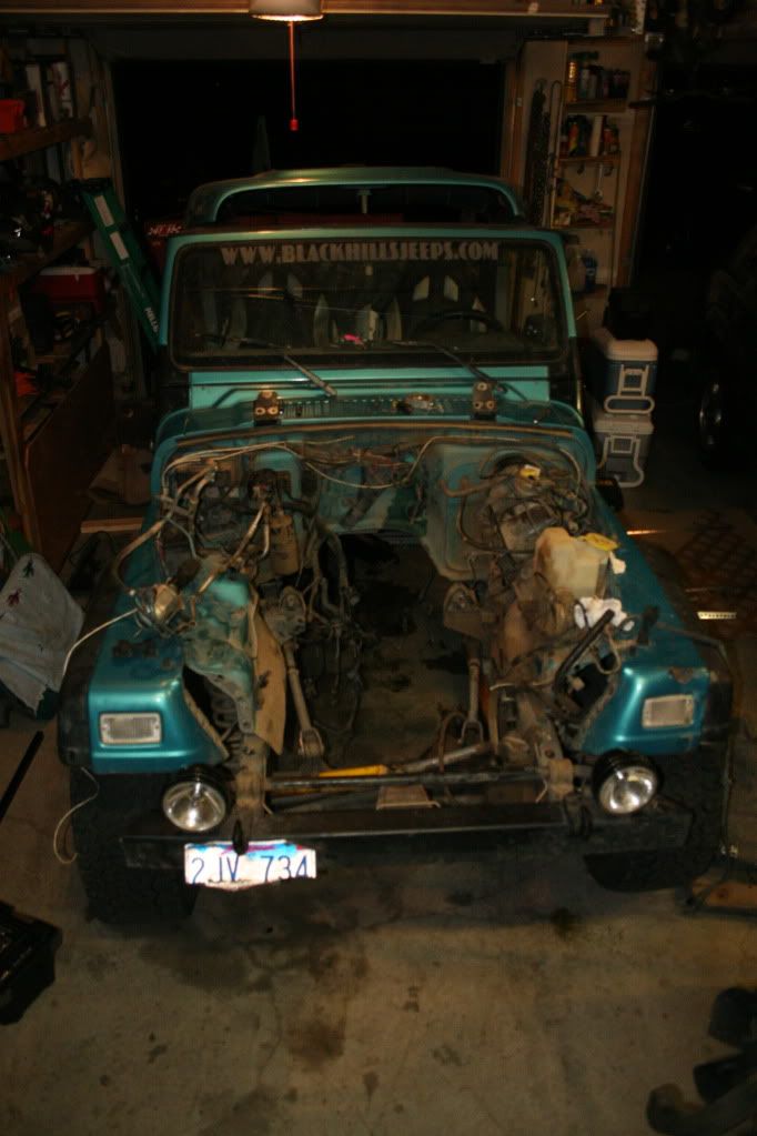

Then I pulled the tiny little 2.5 out of its hiding place...AX5, NP231, and all
Exhaust is overrated. Will probably keep the cat and scrap the rest.
No need for the radiator anymore

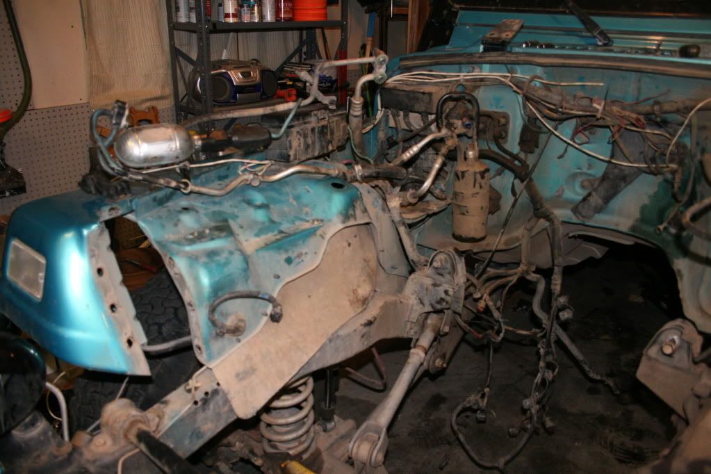

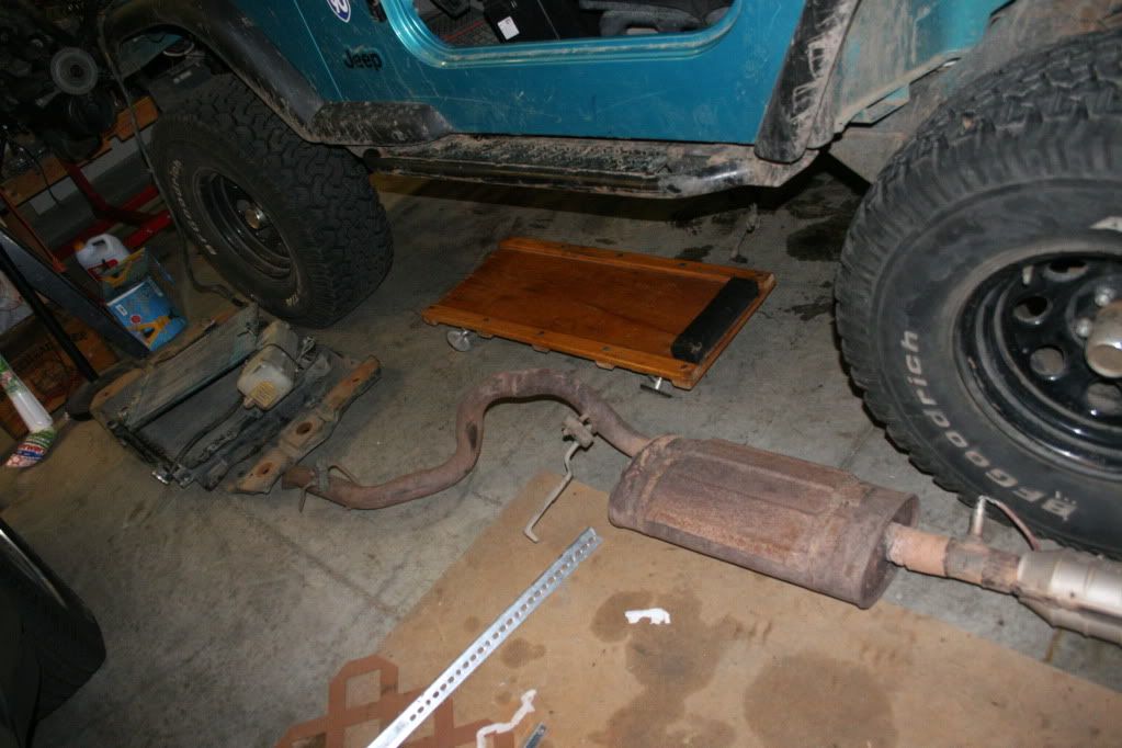

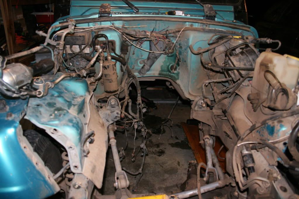

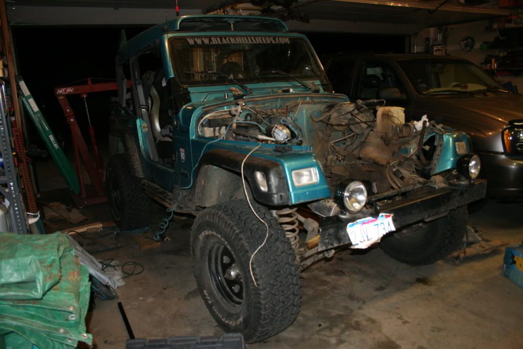

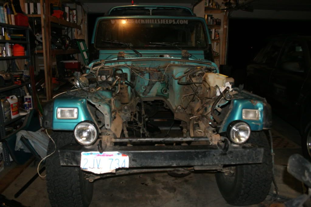

The Aftermath

Motor work...
Previous owner said he was driving and the oil pressure dropped so he shut her down and towed it the last couple miles home. From what I've read, it could be as simple as a clogged pickup or something easy. I'm going to pull the pan and probably replace the rod and main bearings.
Cracked heads seem to be a problem with the 318/360, so I plan on pulling the heads and getting them checked. I may have a simple port/polish job done on them while they are out.
Cam shaft. Its highly likely that I will replace the cam, but we will see what the funds allow.
In order to keep the tcase in the stock location and retain my driveshafts, I'll be using Summit's block hugger headers so I can scoot the block closer to the firewall. I plan on building my own motor mounts. The AA mounts are nice, but I'm on a budget and 150 seems a little steep.

Wiring...
Wiring could be a bit of a tedious task, but it shouldn't be bad. I'm in touch with a couple people that have done the swap, and it sounds like the wiring appears more discouraging than it should be. I have some experience wiring things up, so I don't foresee it being a problem at all.
