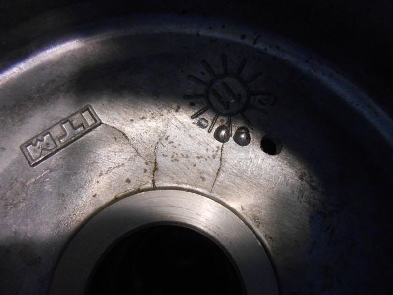

post #4646 of 5561 Old 09-17-2013, 09:59 AM
OverlandZJ
1994 ZJ
Join Date: Oct 2012
Location: Bristol, Pa
Posts: 1,090
Originally Posted by Wytex View Post
I'm about to install the SG mod on a new OPDA before a cross country drive. Looking for feedback from others using this modification. Any issues? Thanks.
Hey Guys.. quoted my best bud on this post. He has an 06 LJ Rubi with very low mileage, then we found out about this issue.
It's an Overland type rig build and will be doing cross country trips often, we followed input in this thread and bought a new Mopar OPDA and the SG mod. My bud started the SG mod and I stopped in this past Saturday to assist in completing it.. then I noticed this. Would you use it, or would be buying another Mopar unit be advisable?
It is not cracked through to the bottom and the SG mod screws for the upper bearing do not fall on a crack.. i'm only really concerned with the bearing area cracking through with use. We figure either it happened tapping the bearings in or it came this way from the box.
His plan was to complete the mod and carry the new OPDA along on his trip, bit short on time to install it and have it set correctly at the local dealer.
OverlandZJ is offline
post #4647 of 5561 Old 09-17-2013, 10:18 AM
Bigbob
Bigbob's Avatar
Join Date: Jul 2005
Location: Bakersfield
Posts: 3,822
More than likely this happened when he removed the bushings. If you don't support the housing correctly this can happen. You can't use the floor of the housing as support to hammer or press on the thing. My original OPDA, (which is still in my Jeep) has been removed and disassembled multiple times and I ended up cracking it. I seriously doubt it'd be an issue for him. If convenient, I'd vee out the cracks a little from the outside of the housing and sand down/ruff up the area and put some JB Weld in there. Also, if his SG Mod bearing holder fits real tight, (as most do) into the housing bore he will want to clearance that a bit as well so it fits in loose. On all the units I have built I make it so the bearing housing actually has a bit of a giggle/wiggle in the way it fits. This can compensate for any housing misalignment.

post #4649 of 5561 Old 09-18-2013, 11:26 AM
Bigbob
Bigbob's Avatar
Join Date: Jul 2005
Posts: 3,822
Just a note: This pic is a excellent example of the factory imprints on the floor of the housing. I suggest these get ground off for the SG Modification as that bearing holder hits them and may not sit flat. Interesting enough, not all OPDA's have these imprints. I always grind them down.
