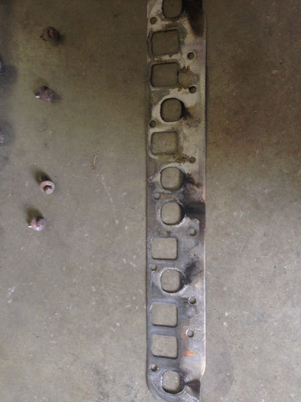

Here's what I'm talking about. I found out there was a metal one on there in the first place. This is a Felpro 93094 metal/rubber gasket. It's leaked on all exhaust ports.
At this point in time I'm really considering going back to the 1 piece manifold if the Y pipe isn't too expensive. My other alternative is to get a '98 copper gasket, seal that one to the Felpro, put high temp RTV on the head, gaskets, and manifold, and then hope for the best. I tried to get pictures of the manifold on the head to show the gaps but I couldn't.

Going back to the 1 piece manifold. Ordered a Ebay ceramic coated header and new Walker front pipe. Total was $170. They'll be in hopefully by the end of the week. I'm taking Yates advice and hoping the ceramic coating prevents it from cracking.

Well got it all bolted up and it works perfect. Still a small tick but I'm going to assume that's the lifters. Also the ceramic coating burned off so it's only a matter of time until this one cracks. But until then, I'm finally happy it's fixed.
