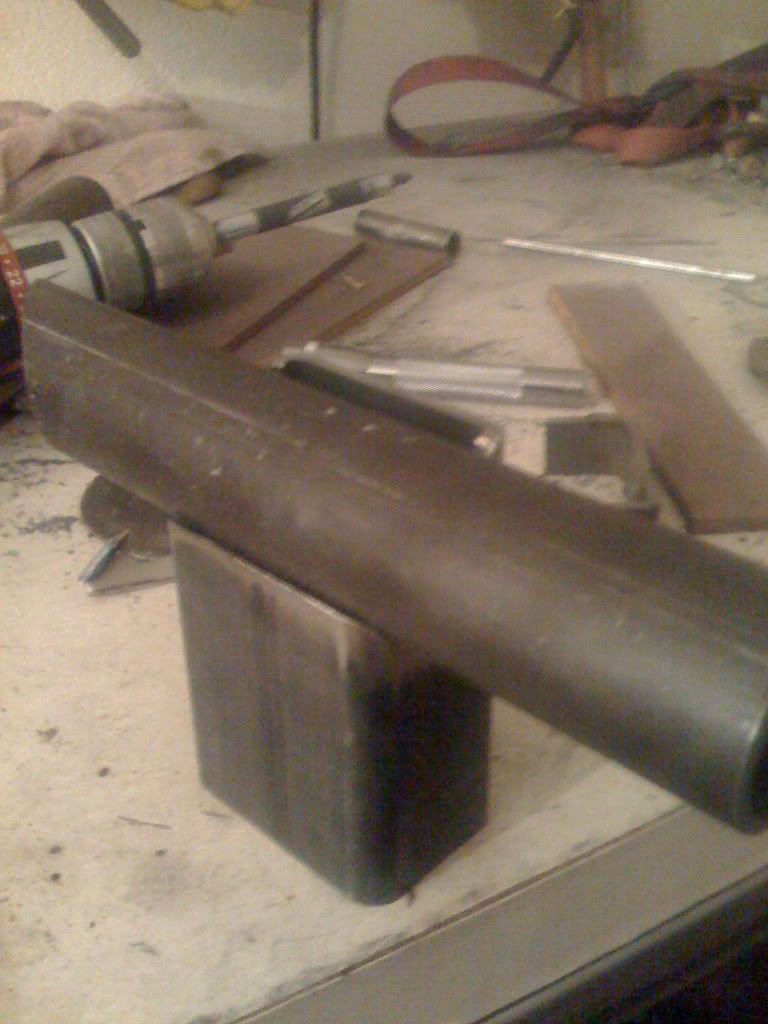

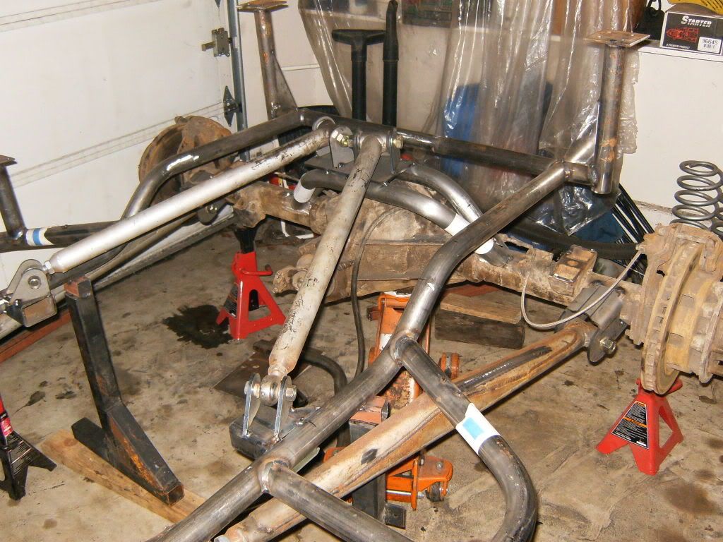

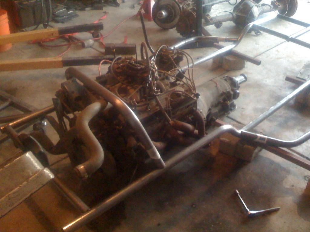

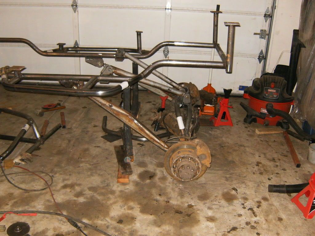

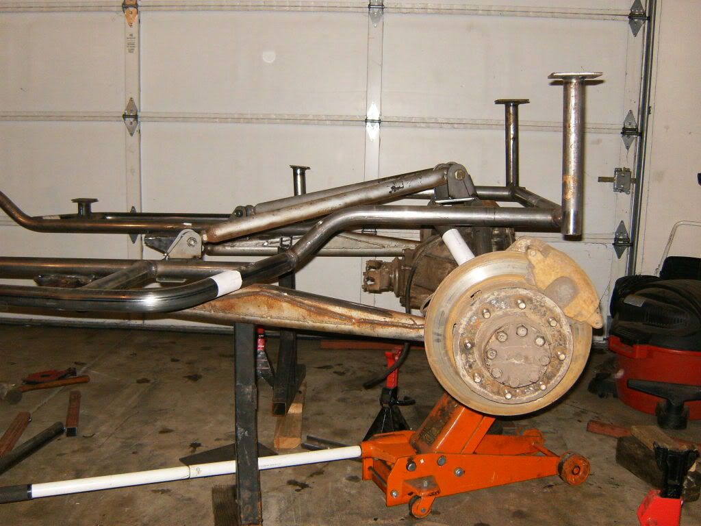

hi all, this is my first post. i've just been poking my head in here and though you guys might appreciate my build.
It's an early flatfender reproduction body going on a tube frame.
zz4 chevy crate motor
700r4 tranny
????? t-case
14 bolt rear
dana 44 front
37-38" tires
four link rear/radius arms front
enjoy....

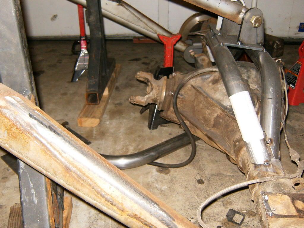

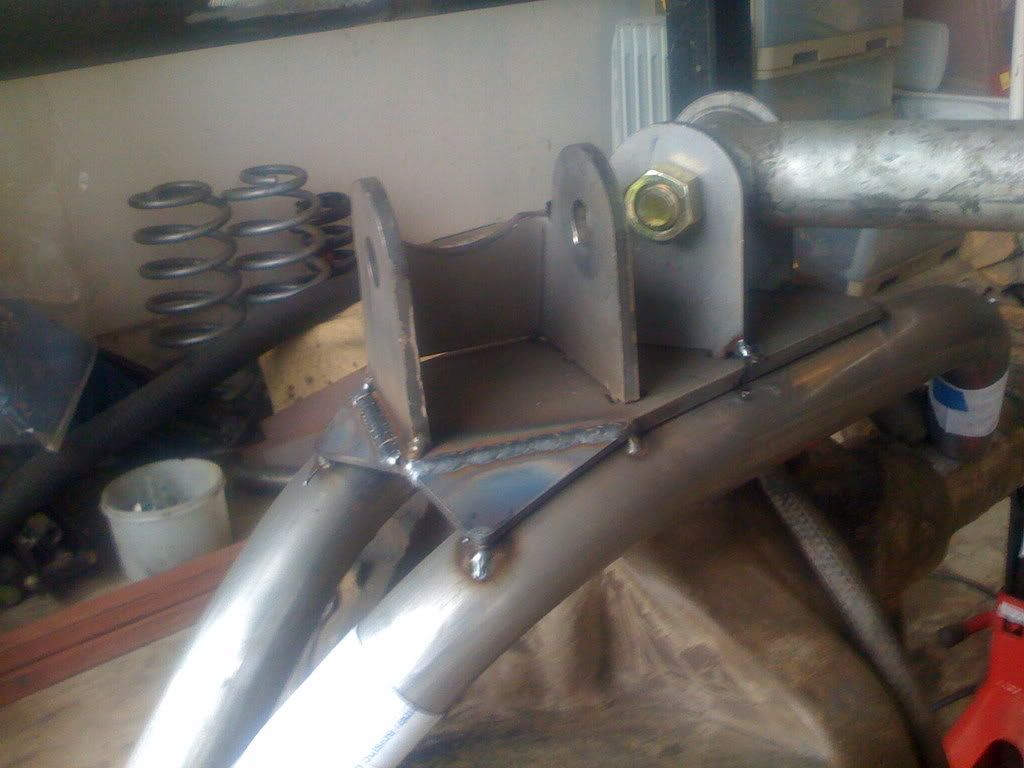

wow, nice work, I really like the lower link design for the rear. Looks like it would take some abuse.
cibholder03 is offline
post #9 of 28 Old 02-28-2009, 01:56 PM Thread Starter
BALTERBUILT
2009 CJ2A
Location: santa rosa
Posts: 28
thanks, yeah they were originally used under a fullsize blazer truggy with unimogs (my old rig)> they are 1 3/4x.250 wall DOM with 1 3/4x.120 wall 4130 chromoly for the upper triangulation with 3/16 plate between and 3" ballistic joints

Nice!
What are you using for the upper link joints at the axle end? They look like regular poly bushings? If they are, they probably won't last long if the rig is flexed up frequently. They'll get "squished" out and sloppy pretty quick.
BESRK is offline
post #11 of 28 Old 02-28-2009, 05:27 PM Thread Starter
BALTERBUILT
2009 CJ2A
Posts: 28
yeah they're regular poly bushings...however i've built numerous suspensons with them and never had a problem. The ones you see on this project were on my old truggy for two years before and it got driven to the trails wheeled and driven back and they are still nice and firm. what kind of experiences have you had with them where they went south?

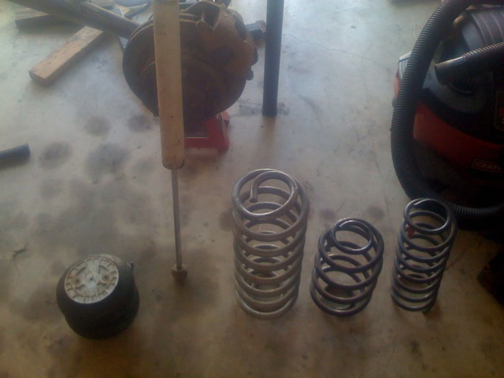

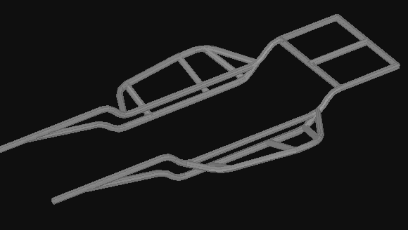

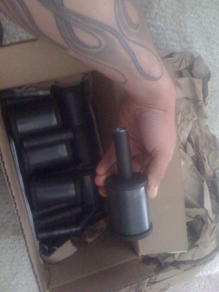

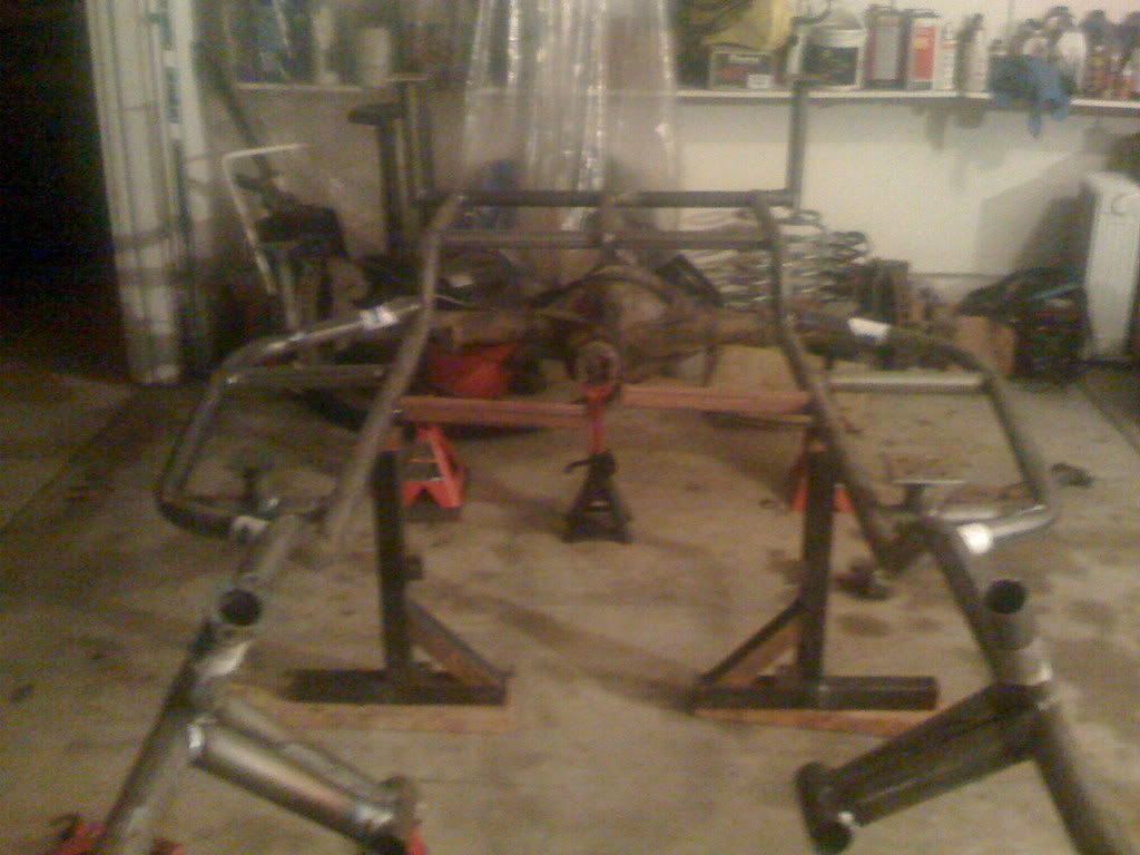

here are my springs otpions, decided to stick with the airbags, i moched them up i'll post pictures after a little felxin to see if i will get enough travel...
got my bushings from adam at 4xInovations, great dude to deal with awesome deals

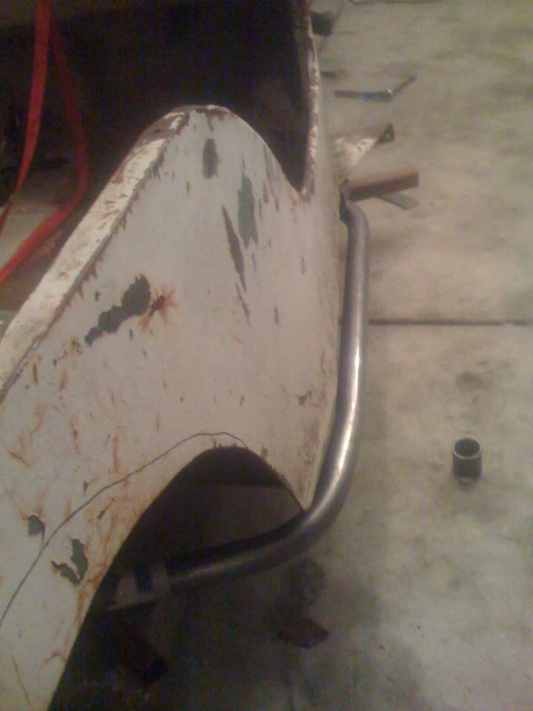

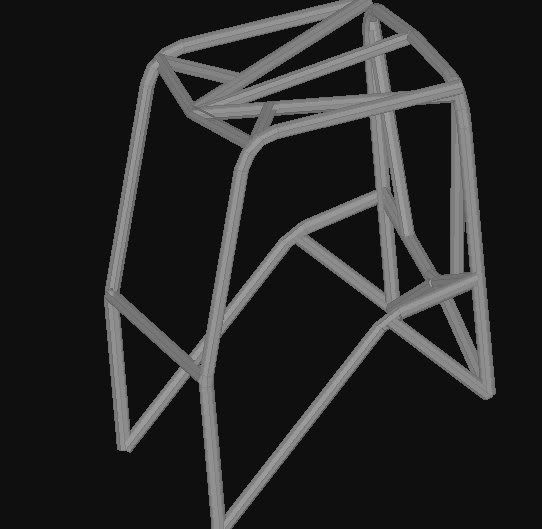

and finally i was messing around and came up wit ha couple different cage designs, i was kinda liking this one
