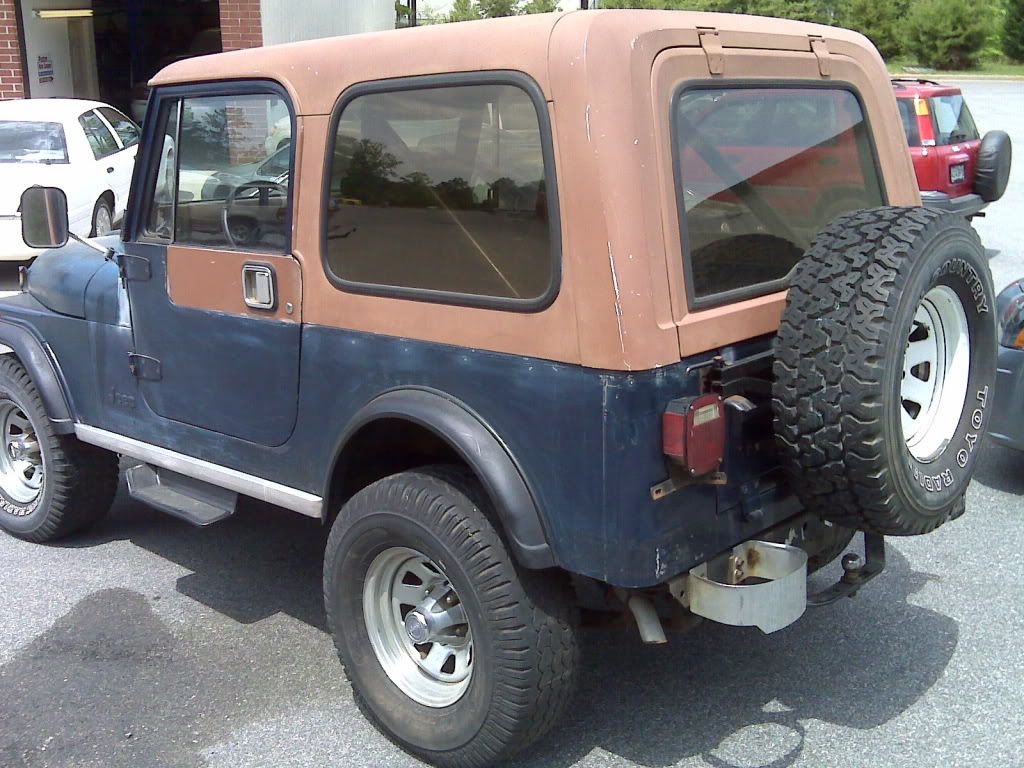

The chrome ones pictured are 15 x 7. I can tell be the distance on the second step up of the rim where the face folds under. If it was 15 by 8, this area would be larger. To confirm, take one off and use a rag to find the numbers on the back side of the rim. It will say "Made in Canada" "15 x 7" and a date stamp.. XX XX 82 or 83. DOT......long number.

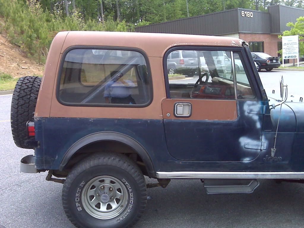

DirtyDevin's spare tire looks like it's mounted on an older 15x8 NT wagon wheel by the looks of the second picture.

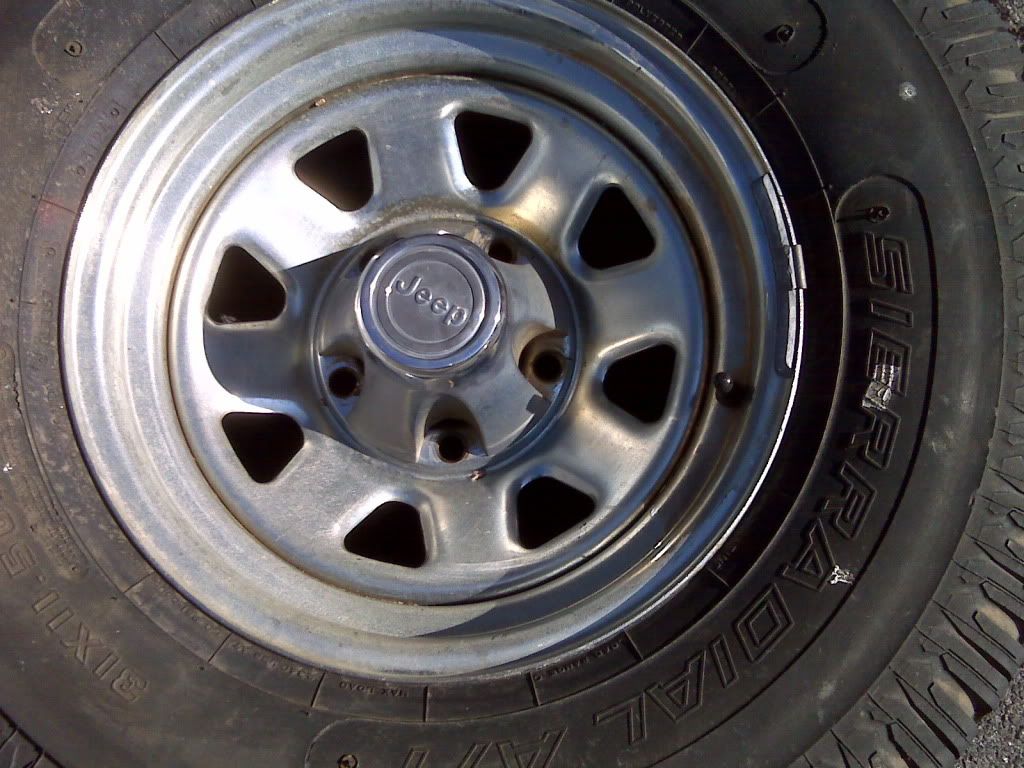

Looks like mine are 15x8. I had assumed these were not the original rims because they were not drilled for center caps and my Jeep is a Laredo. A post above mentions that 1980's, which my Jeep is, were not drilled for center caps? If not, how were they attached? Am I searching for center caps specific to 1980?
