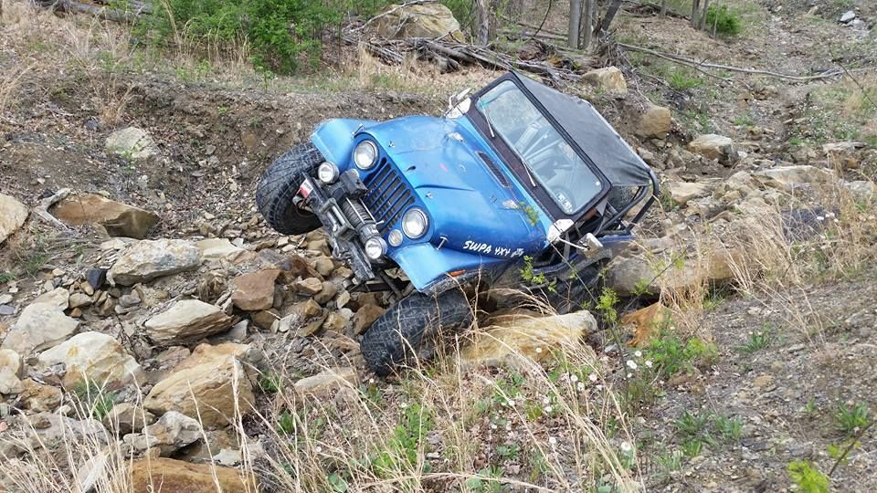

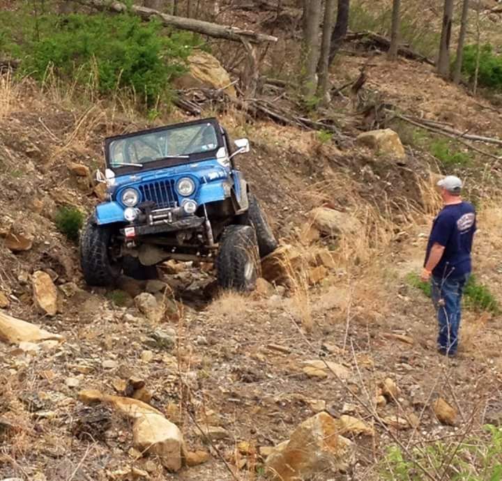

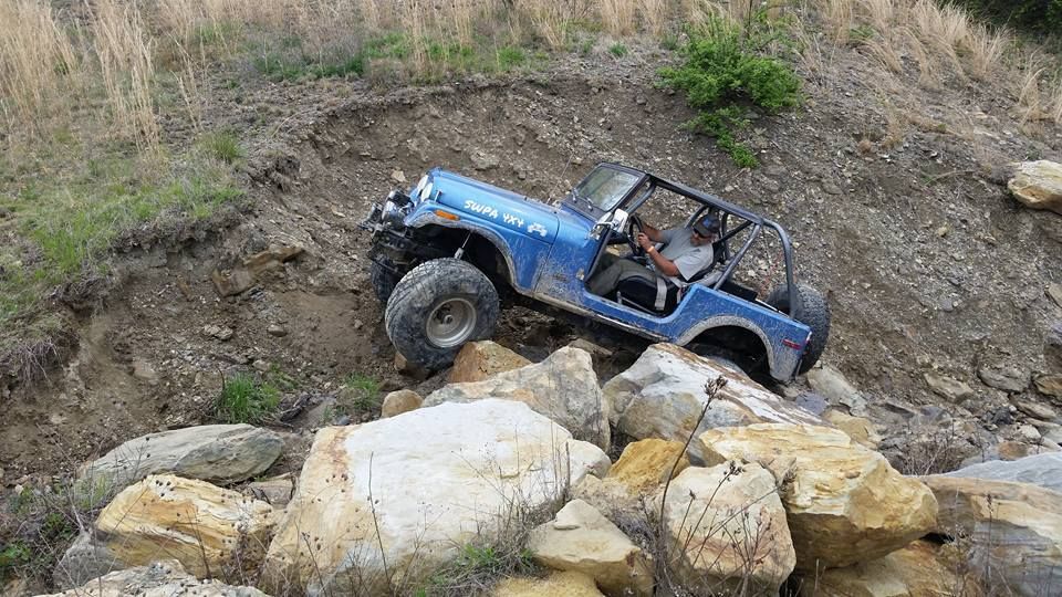

Darn Moog u-joints. I don't remember taking out the Spicer, and replacing it with a Moog. Must have been a last minute repair job before a wheeling trip, as Spicers are hard to find locally at the brick and morter stores in my area.
Fixing the damage from yesterday's trip. 1 new Spicer U-joint, a new outer stub, and press my ball joint back in (it lifted a hair).
Had the front tire drop in between two undercut rocks, and it wedged tight. A bad decision with the winch line, and BANG!! Re-hooked to a different angle, and it lifted the tire enough to climb. I should have known better.
Fun day of wheeling though.
