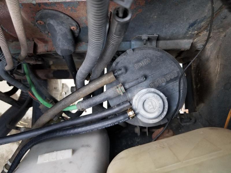

Here we go - 1984 CJ-7, I6 (258 / 4.2L), stock, California emissions Vapor Canister:
A couple people found this:
https://store.delorean.com/p-6675-carbon-canister.aspx
It's about $65 - full canister. I've sent them a quick email asking to make sure this is a direct replacement. Waiting - will update.
This is why I'm looking:
This seems like the perfect time to remind people that replacing vacuum tubing can get tricky when removing the old from the 30(plus)-year-old plastic connector - and expansive.

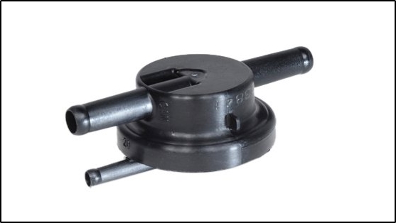

Someone posted this as the correct Cap (ACDelco 214-552 GM Original Equipment Vapor Canister Purge Valve).
Lists it for about $30.
Anybody have any luck with swapping out this new Purge Cap Valve thingy with this new one?

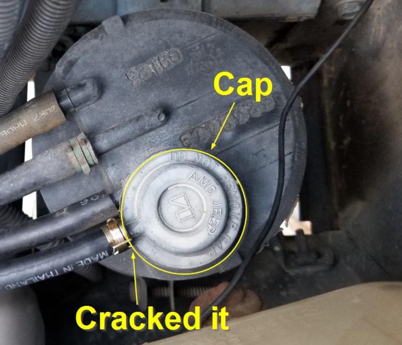

Have you tried repairing the nipple on the cap?
I accidentally broke off the same one a couple of years ago while working on the clutch rod assembly which caused a vacuum leak. It cracked open at the base of the nipple. I went to an Ace hardware store and purchased a small brass tube that I inserted into the nipple after drilling it out some so it would slide in beyond the crack. Then we used a solder iron to melt the plastic around the crack to seal it shut. Cut off the extra tubing and put the vacuum line back on.
Its very solid and more rigid than before and cost a few dollars to fix.
If the cap is cracked, use a good super glue to seal it shut and then use a soldering iron to melt and fuse the plastic around the crack. Sorta like welding plastic and can be very effective in repairs. Used this method on more plastic parts than I can count and it usually works.
Pain in the ***...
Mine didn't break all the way off so, using your idea, I'll JB Weld (auto plastic flavor). Will probably 'seal' it through meaning, once it's cured, drill through newly sealed connector.
If that fails, I'll do exactly what you suggested.

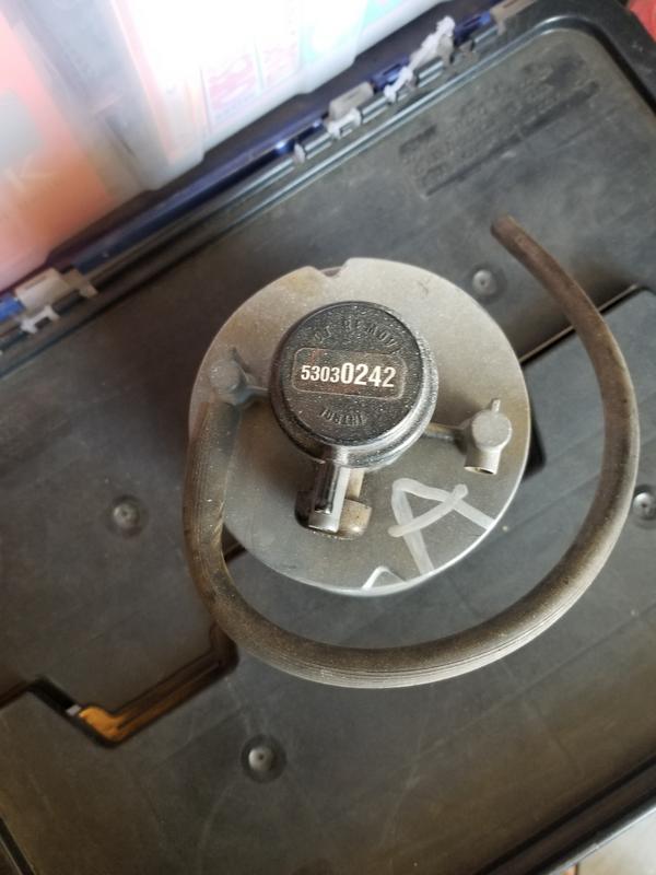

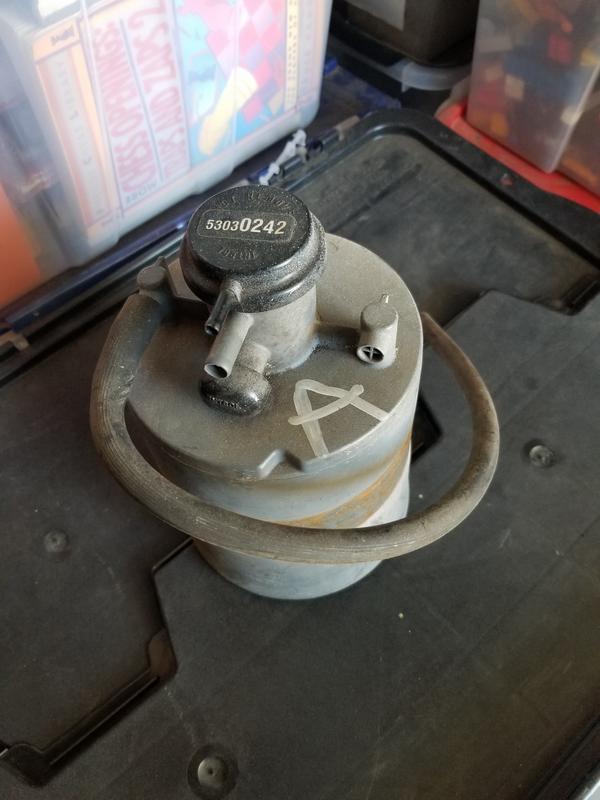

Not sure of the other's guys measurements but mine is close to 4-7/8" diameter (across the top). So, that makes it (2 Pi r and all that...) around 15.3" circumference - right?
I was trying to assemble a MPI kit (Hesco stuff) and have a later year canister - can't remember what year but it looks exactly the same - used.
I might just punt off the repair and just replace it with the 'new' one. I'll fix the old one and put it aside so when my kids clean out my garage of all things Jeep, it will give them one more reason to posthumously call me a hoarder.
