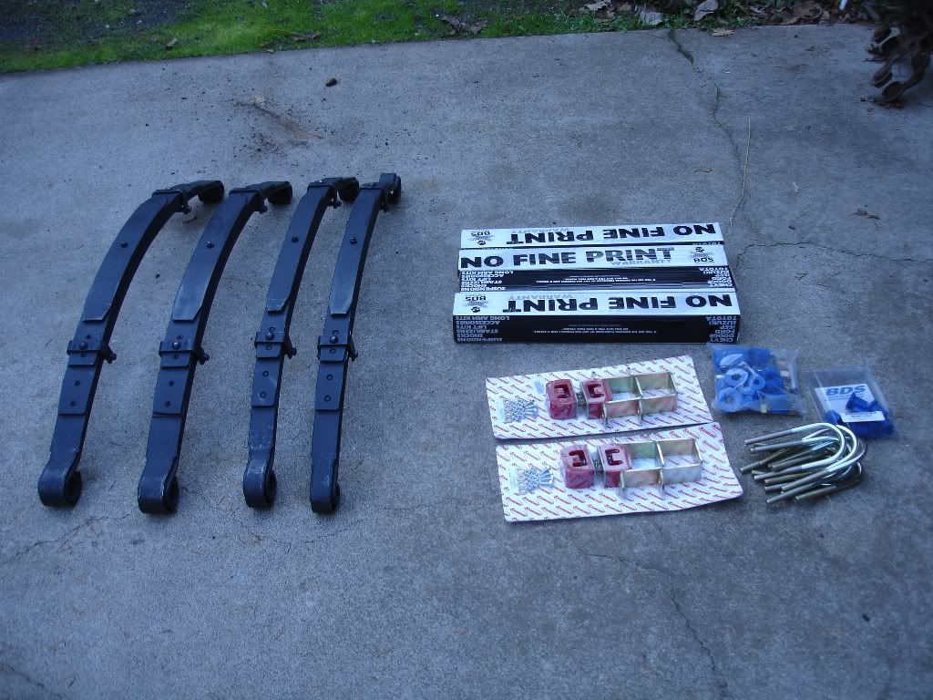

Here's the kit
I also ordered some Rancho bump stops

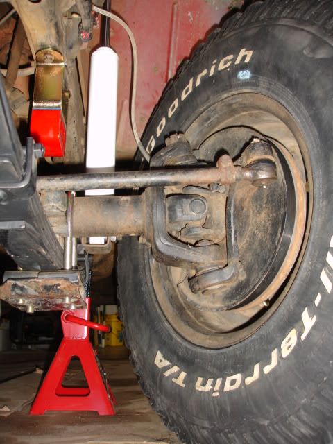

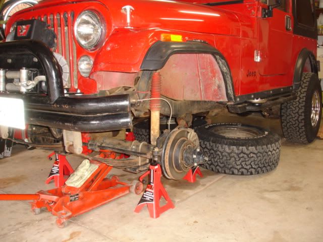

Got the CJ up on the jack stands and ensured the thing wouldn't come down and whack me!!

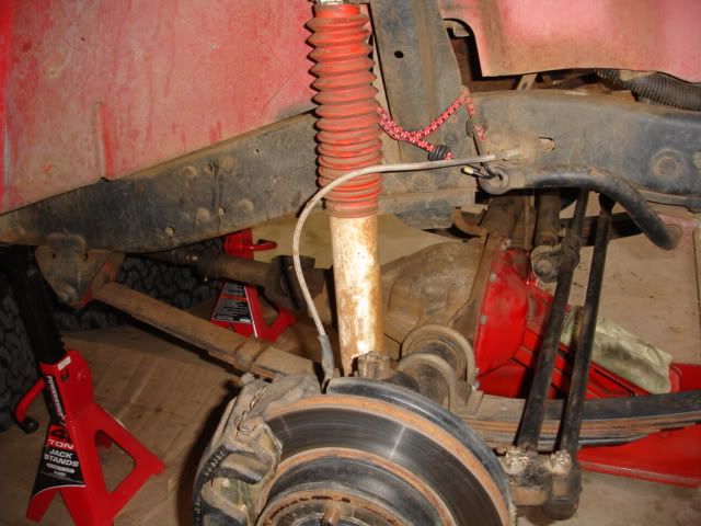

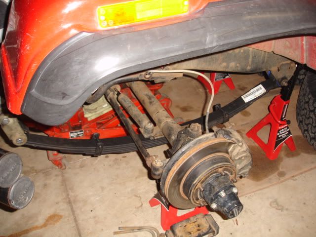

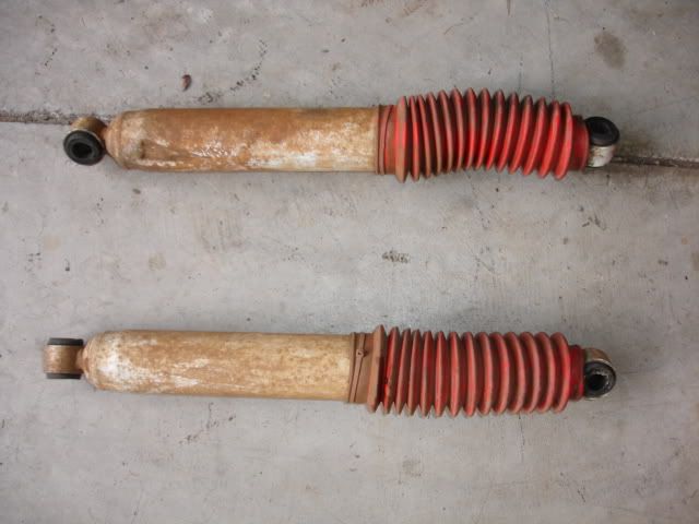

After removing the front tires, the first order of business was to pull the old shocks.
I already had the sway bar tied up from a wheelin trip last weekend

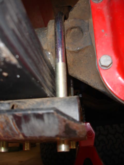

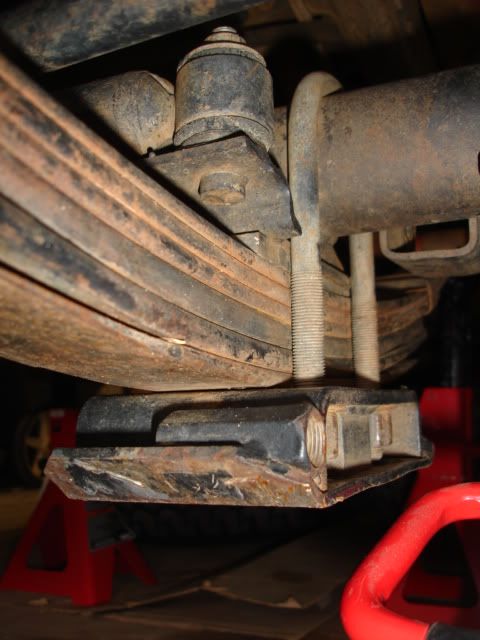

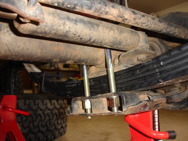

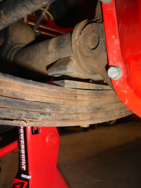

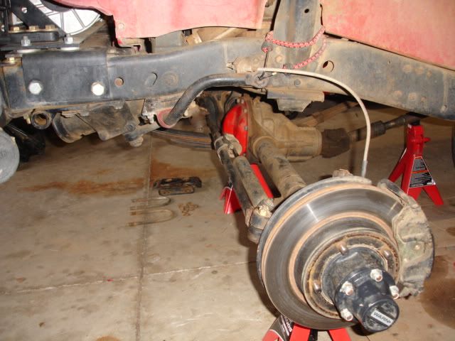

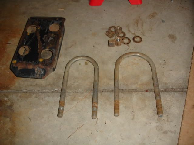

Next was to remove the U-bolts
I think I got all the goody out of these poor guys
Notice in this picture, one U-bolt is larger than the other. The large U-bolt actually fits over the diff housing on the front right hand side. There's only one this size, all the others are smaller.

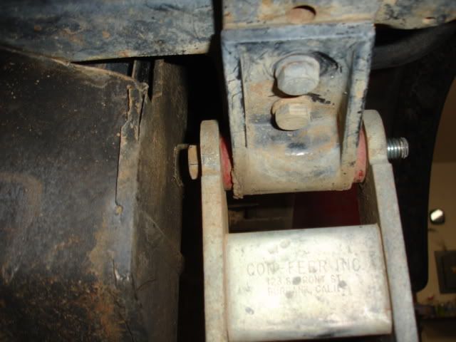

I pulled the front shackles, which are being replaced with shorter units, and pulled the rear spring attach bolts and removed the old front springs.

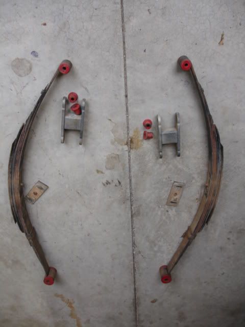

Here's a shot with the new and old springs laying side by side.

I was limited in my budget for this project. I am using a set of used 4 inch Confer shackles I found at a garage sale a couple of years ago. The set I removed where Confer 6 inchers.
In the future I plan install a set of Currie 4 inch shackles with the tow bar feature for the front set.

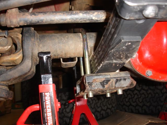

Got all the U-bolts in for the front. They hang down a little more than I like but we'll go with it for now.
Here's a shot of the one U-Bolt that is larger than the rest

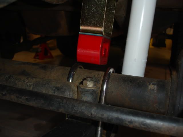

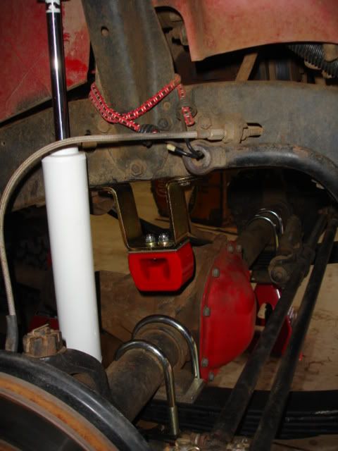

Installed the new shocks and bump stops and started to grow concerned that the new stops are to large.
Decided to leave the stops on and wait until the front end was on the ground

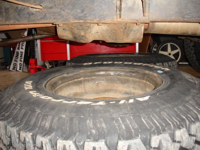

Sure looks like they are to big. Open to any feedback here, I am thinking I don't have enough clearance and I will be into them all the time. They are Rancho 3" stops. They are 5 1/2" overall.
I decided to press forward and made sure I have adequate clearance with the steering all the way to the stops

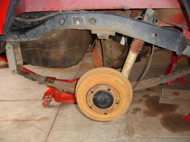

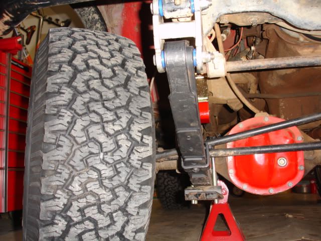

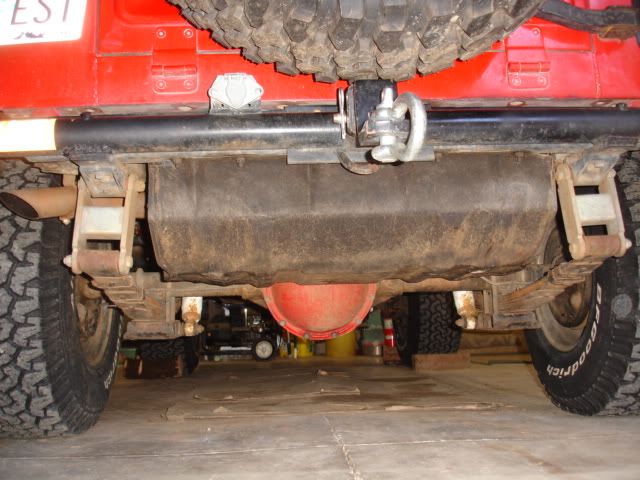

Got the CJ up on the stands and the tires off

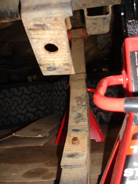

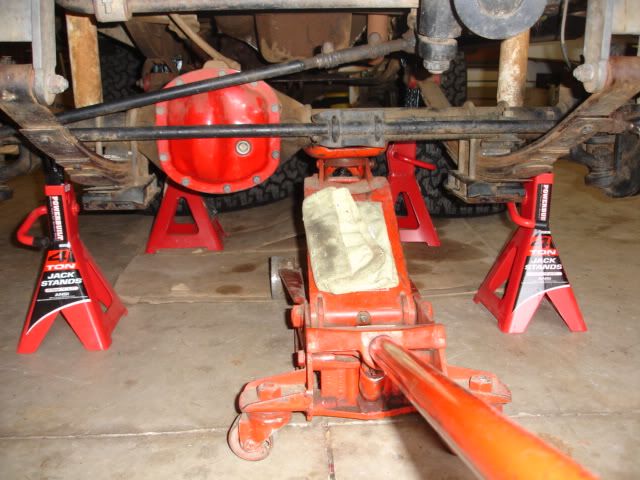

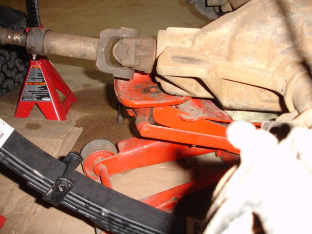

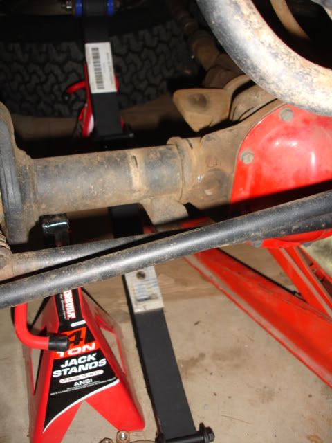

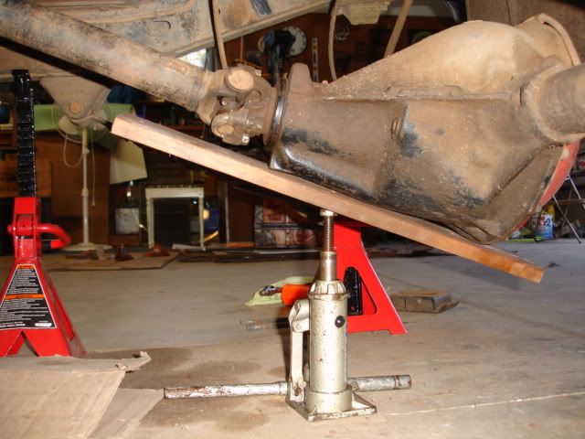

Ended up doing something different with the rear diff. Took a bottle jack and a piece of hardwood to hold the pinion angle.
The only unexpected item I ran across was with the right rear shackle. The PO must of either had the fuel tank out or installed the shackle on the hanger before the hanger was installed. There was insufficient clearance to remove the upper shackle bolt.

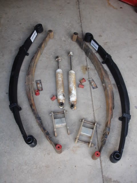

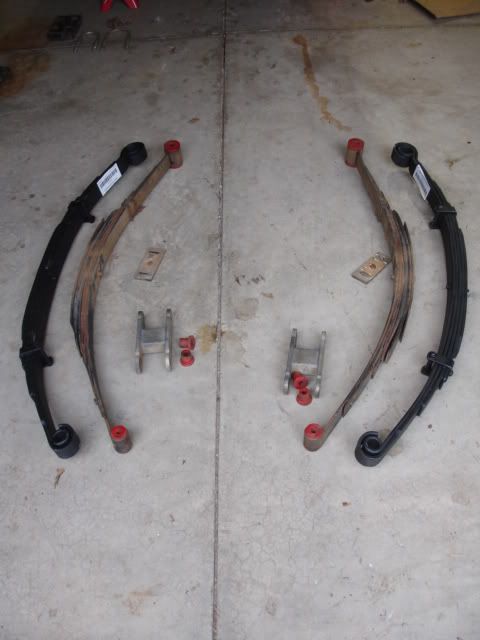

Here is the rear suspension removed and the new springs for comparison

Posts: 2,091
looking at the spring comparison it looks like you didnt gain anything? explanation?
Ben
benullman is offline
post #8 of 123 Old 11-06-2010, 07:53 PM
RobsCrawlin7
no balls
RobsCrawlin7's Avatar
Join Date: Feb 2005
Location: Triangle
Posts: 3,229
Ben
i would imagine the new ones are much stiffer
Ben
What are you expecting to see? My 4" lift compared to stock don't look dramatically different.
The springs install in the same location so they aren't going to be longer. It's more about how the leafs are made that give the lift.
Ben
I would assume that if he was keeping the same pinion angle that the old lift is 2.5 inches as well?
well, he didnt show a completed front pic. but it didnt look like very much of a gain. Maybe its to late for me!
Nice intall though!
Ben
His lift kit is a 2.5" lift, it's not a dramatic amount of lift. Once he gets it done and posts a picture of before and after you'll notice the difference.
