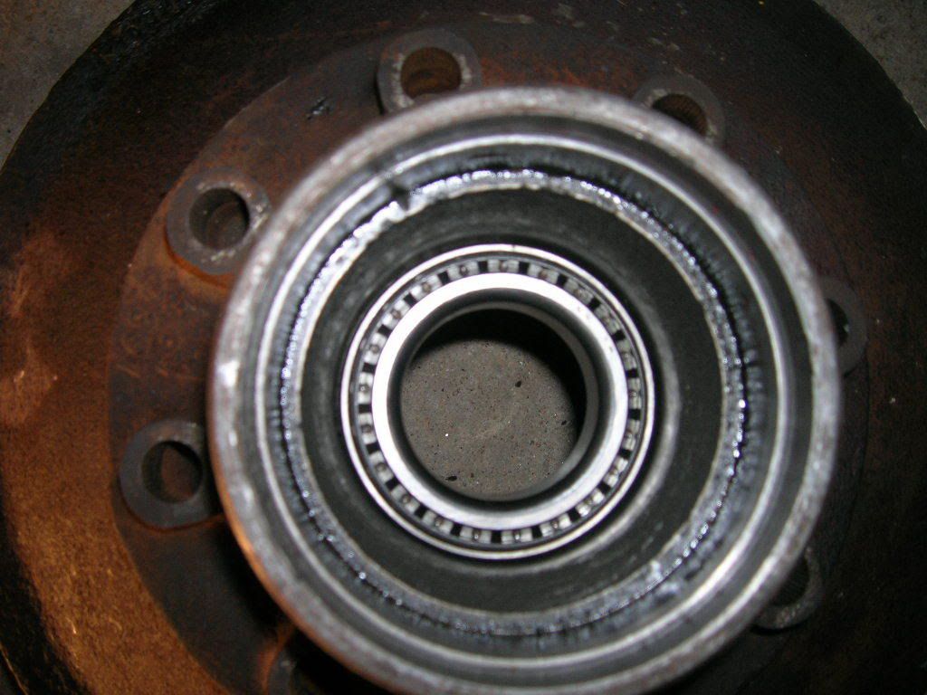

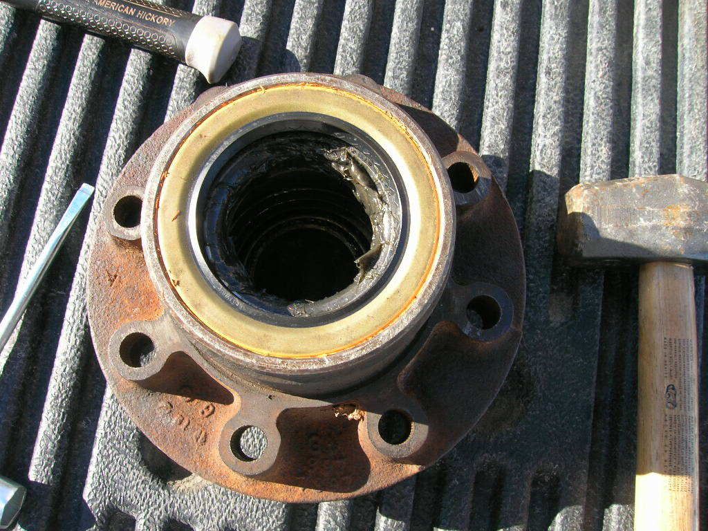

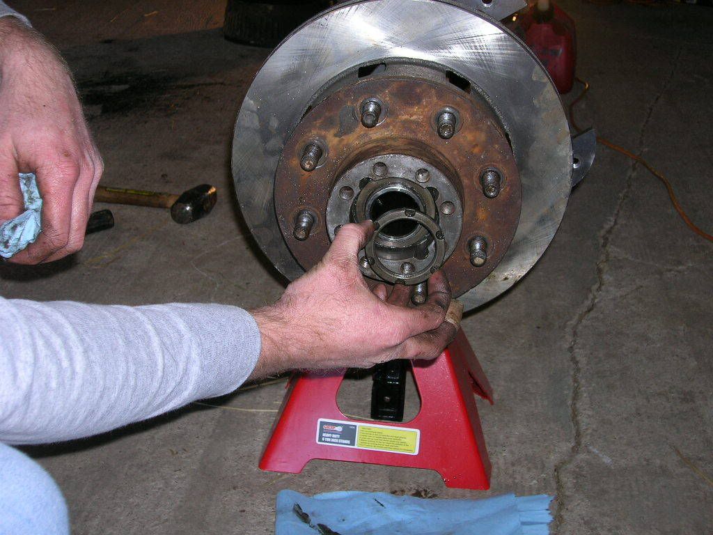

Here are the pics as promiced. After taking the
hub to the place that helped me take the large snap
ring out it was time to get the races out and pack the
new bearings. (below is the snap ring that they took out
and you can see the old race in there still)
This is what I used to tap the old races out. And the new
ones in.
(minus the large screw driver)

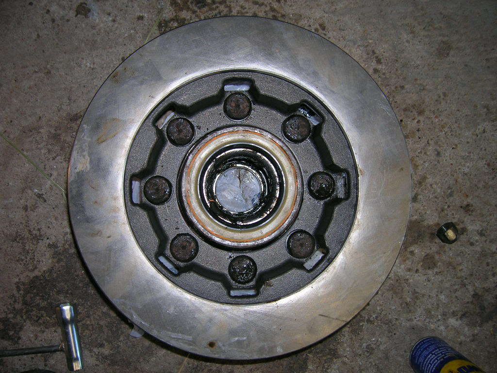

After new race is in and packed bearing
Time for the outer seal

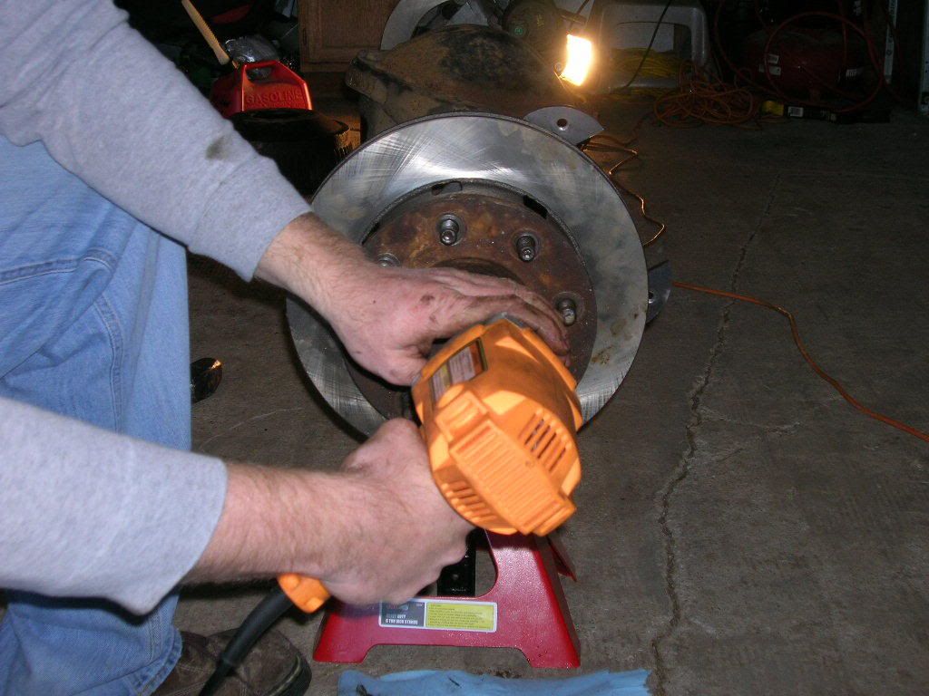

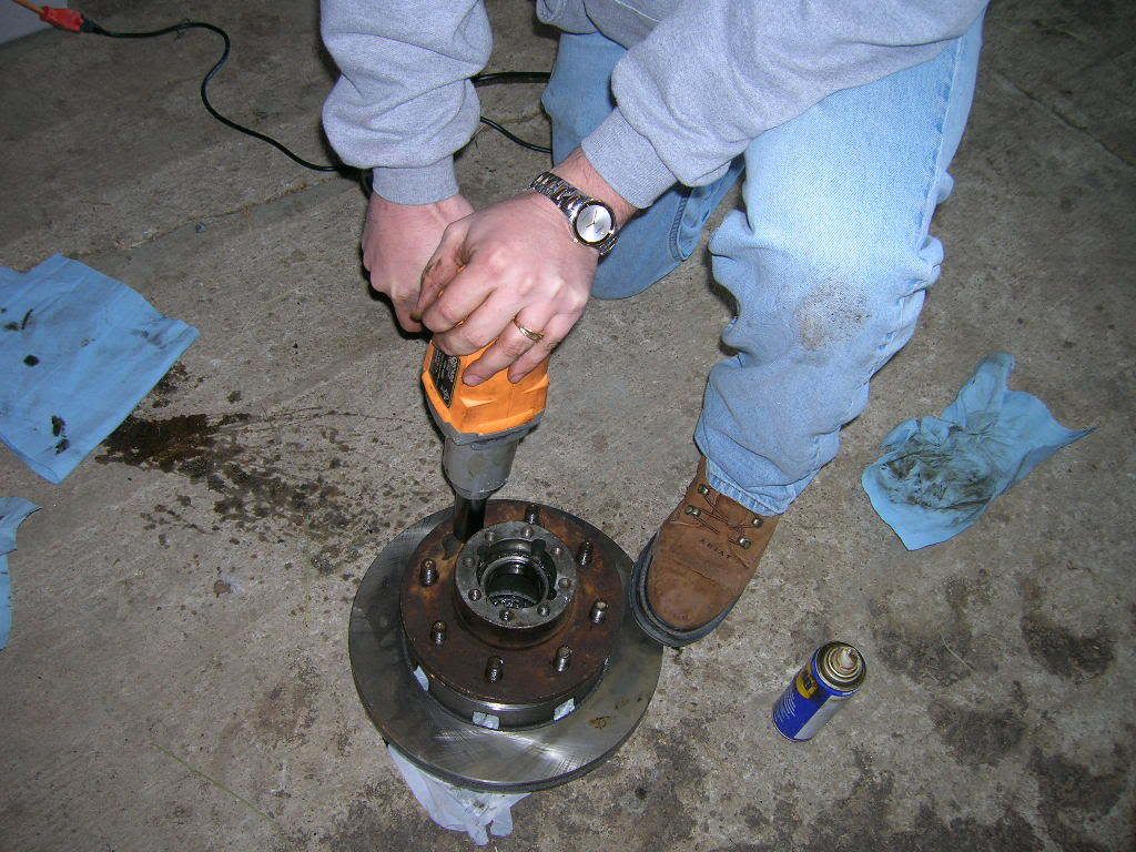

Time to put the studs in the rotor
Pounded them with a hammer first then went
to the trusty impact.
Time to slide her on

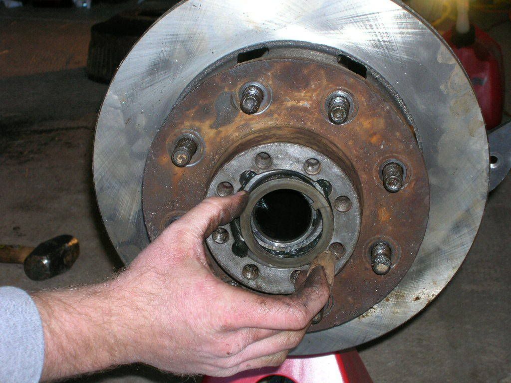

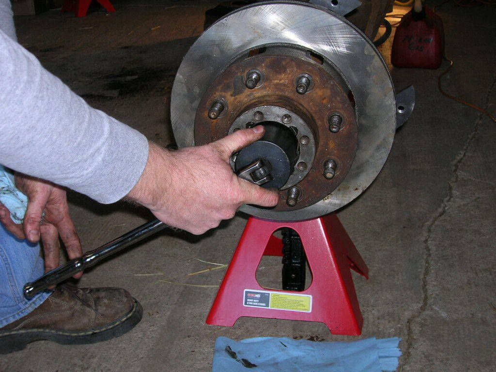

Then back to slaping all the outer stuff back on.
First the washer with the notch that holds it in place
Then the nut that takes that special tool
Then the new spider shaped keeper
One more nut
Tighten that dude up
And sign off

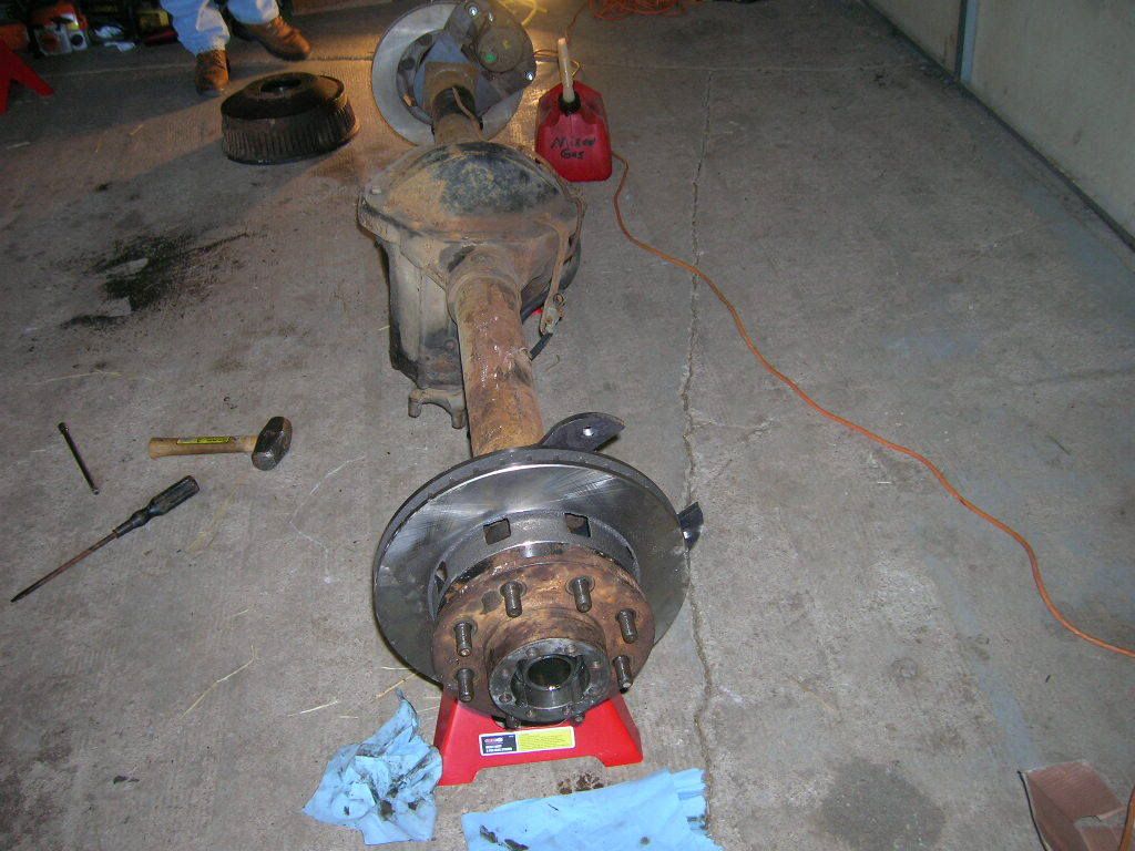

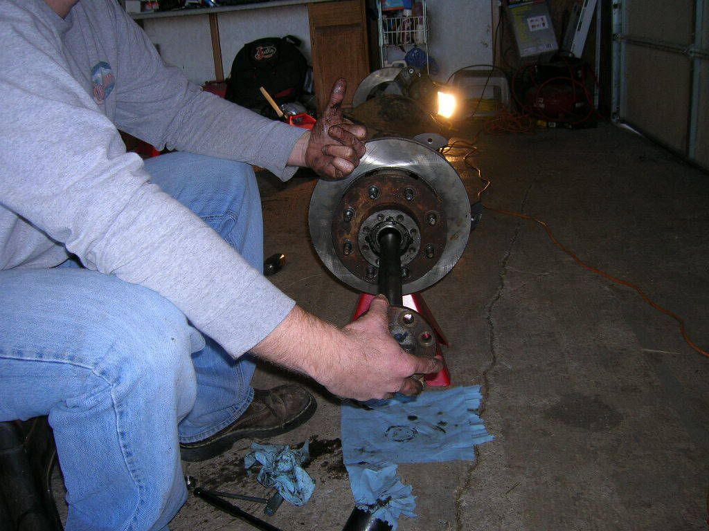

Then the Axle goes back in. It has to be just right or
the outside bolts won't match up.

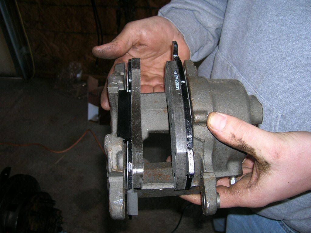

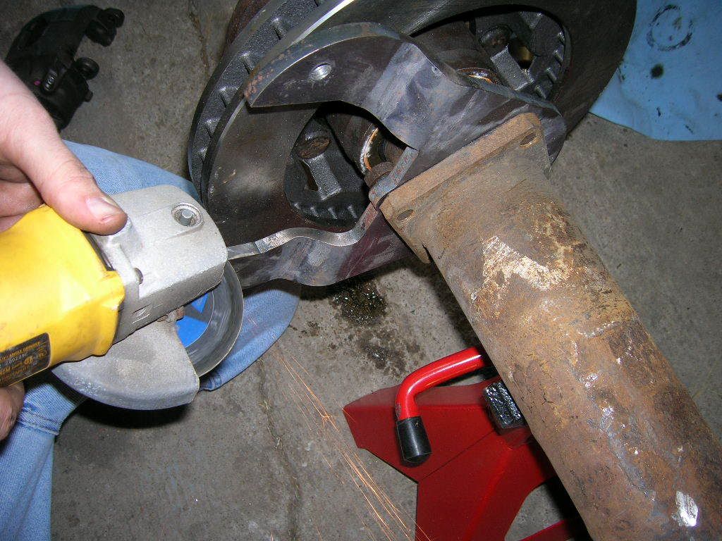

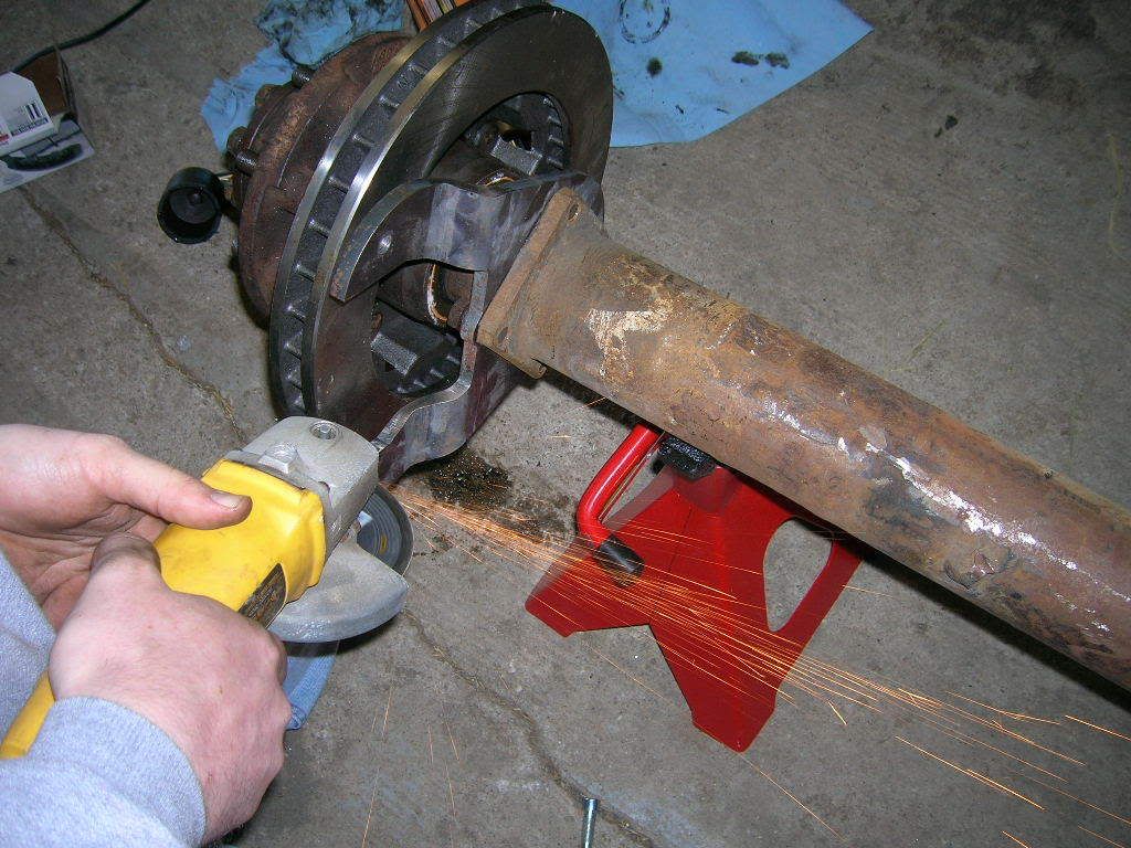

Now to puting on the calaper (pads were just thrown
in for the pic. You will notice the one on the right is
upside down =) )
Looks easy enough but I had to take the grinder out and
work on the hanger a little to get them to fit
All done

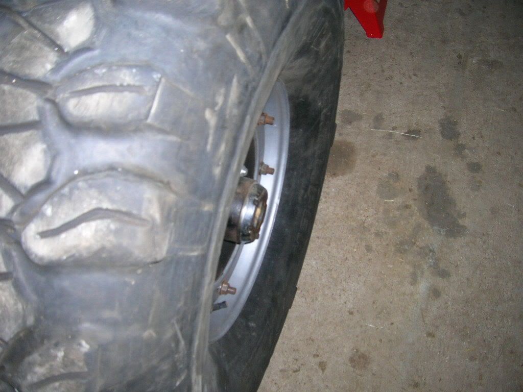

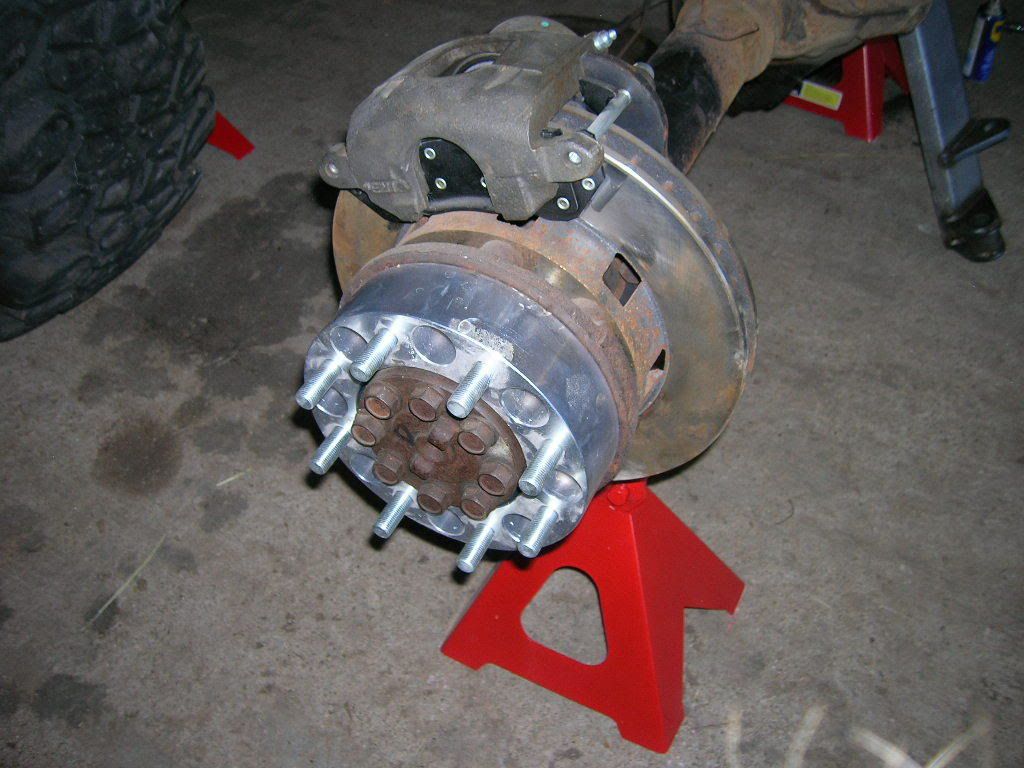

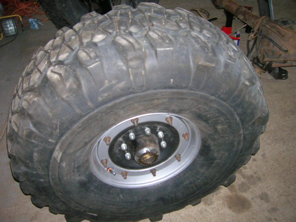

As for the comments about the hubs clearing on the
H1's in a previous post. You are very much correct.
However the 2" spacers help a lot with that.
You will see that there is no grinding needed even
with the stock tie rod.
I like what the spacers do for the rear.
I've never realy liked the way the hugs
stick out without the spacers

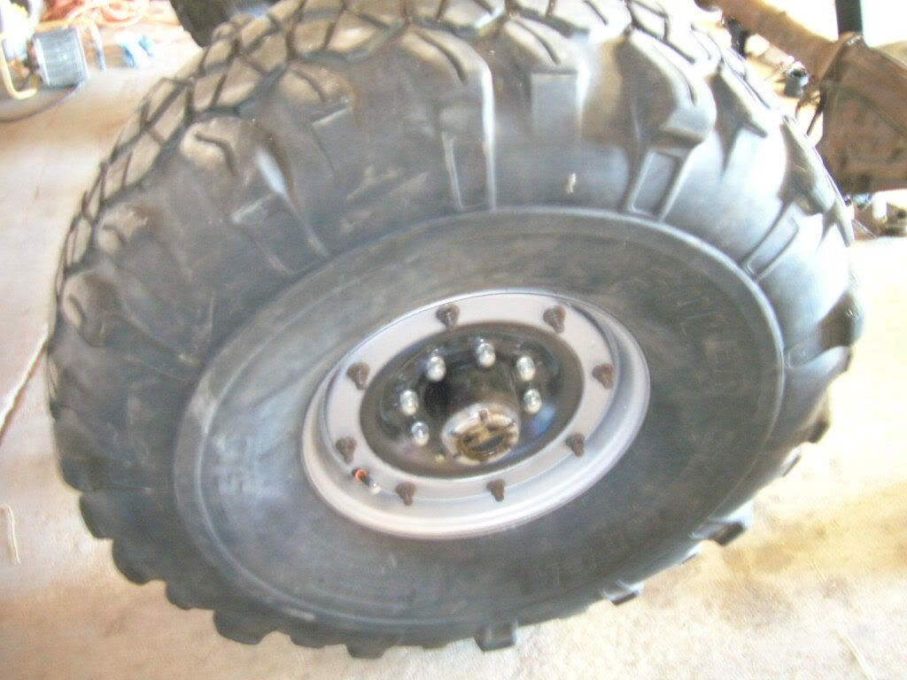

Here is what the lockouts look like as far as
them hanging out past the face of the tire.
I think they will work just fine until I decide
I need different wheels.
