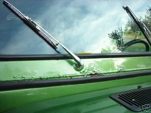

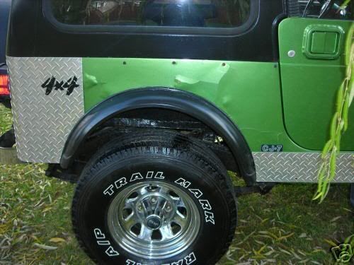

Here are a few more pics that show the not so nice parts of the jeep.
This will be covered up as I'm comp cuting it and running crushers with LED's.
Both sides are rusted and have the junk bondo flaked off
The windshied frame has rust. I'll be buying a new one and painting it when I paint the armor.

I was in agreement with you until I saw those recent pics... you never know what something looks like until you are right up close... it was a great 20 footer, but up close, it looks like it has more then meets the eye.

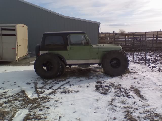

Here it is all dirty on the side of my barn. When I got the 42's home the first day I had to see what they would look like next to the heep
