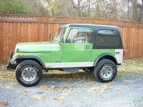

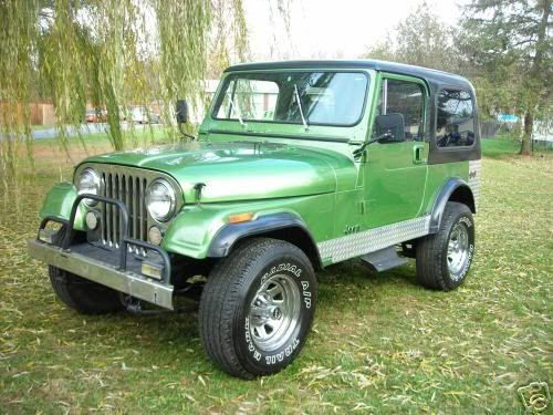

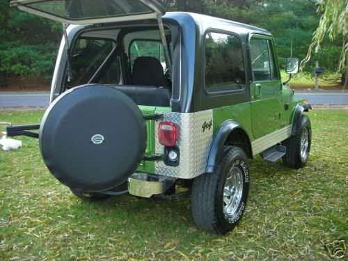

Well I thought it was time to start a thread for my CJ-7 build. I'm very open minded and willing to hear anything that others might want to throw out there. Here is what I'm starting with. A 1985 CJ-7 with an I6 and an Auto. Originaly that was what I was going to run. But things have changed. Here is how she looks when I rescued her from VA.

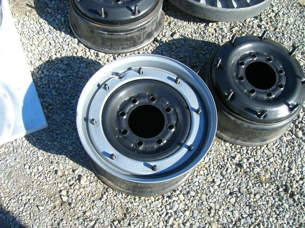

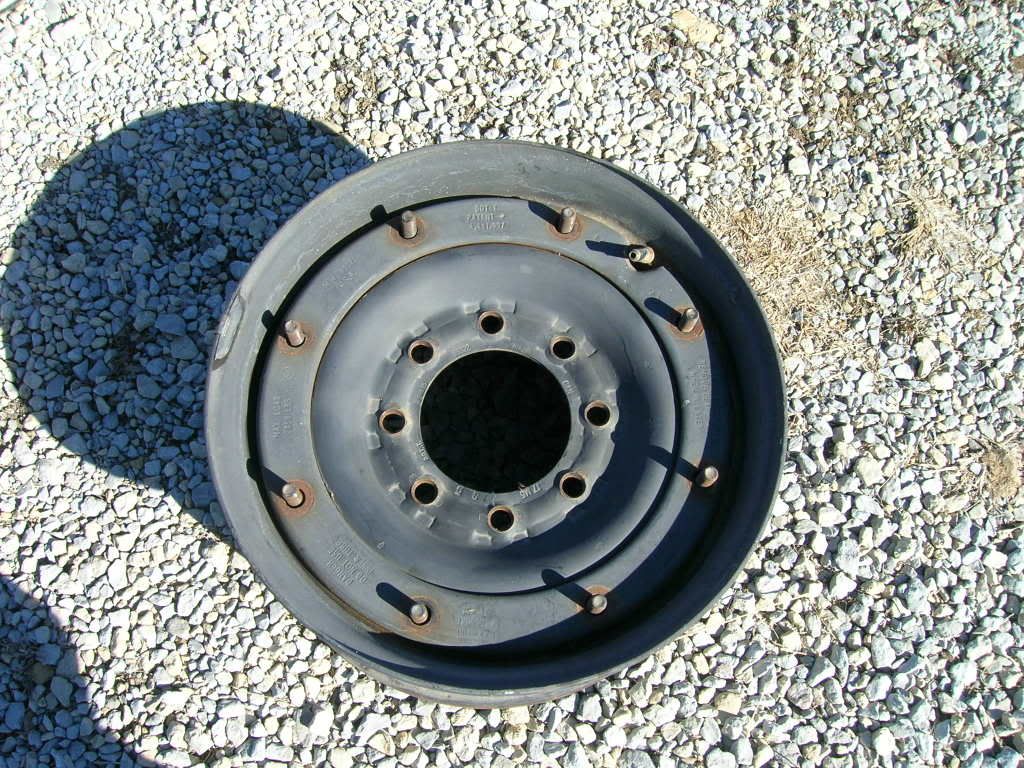

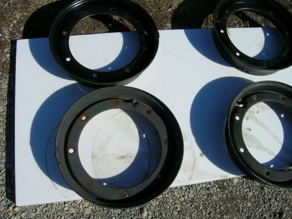

I picked up some things here on the forum from JeepNazi
that fit well into my build. I bought a set of H1 beadlocks
off of him that I decided to repaint and mount the 42's on.
Started out like this.
Preped them and used some paint I have had good luck with in the past.
Left main part of wheel painted
The right one is not (yet)

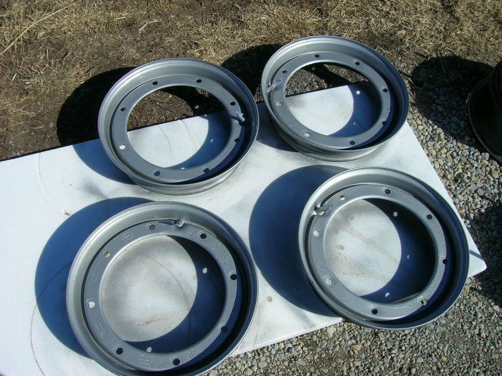

after paint
Used Balancing compound in each tire before install

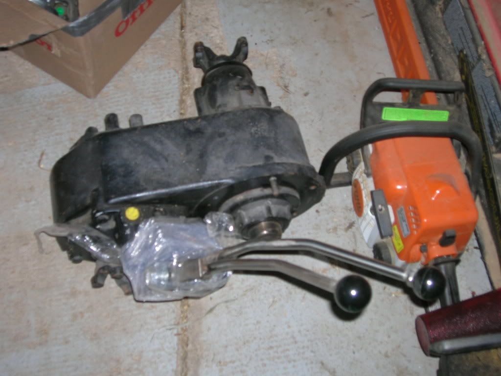

So I found a Chevy TBI 350 on Pirate. The guy
was in Tulsa. Made the road trip and picked it up
I will be straping it to a 700R4 with
a Twin sticked dana 300 behind it.

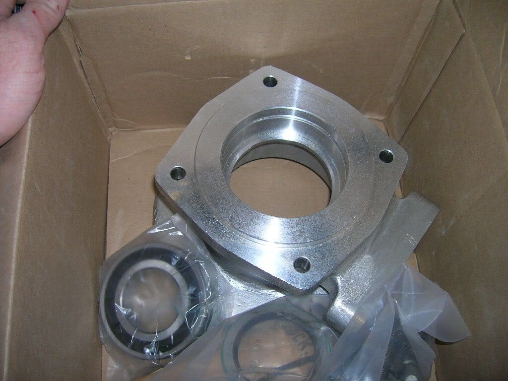

Got my adapter in from Advanced adapters.
I'll be changing the output shaft on the Dana 300 and
using it as a clocking ring as well

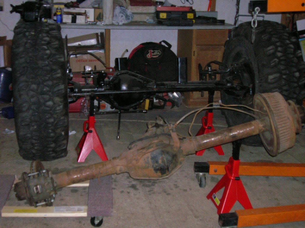

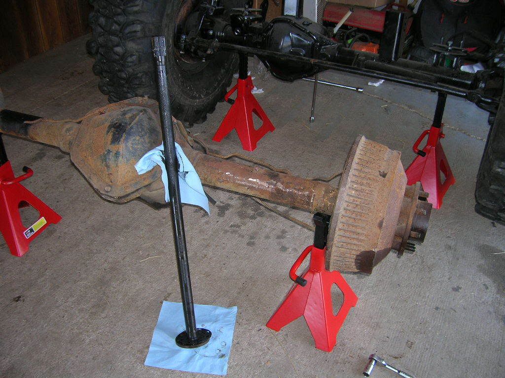

As far as my axles I'm going with a Chevy
Dana 60 up front
and a Chevy Full Floater 14 bolt in the rear.

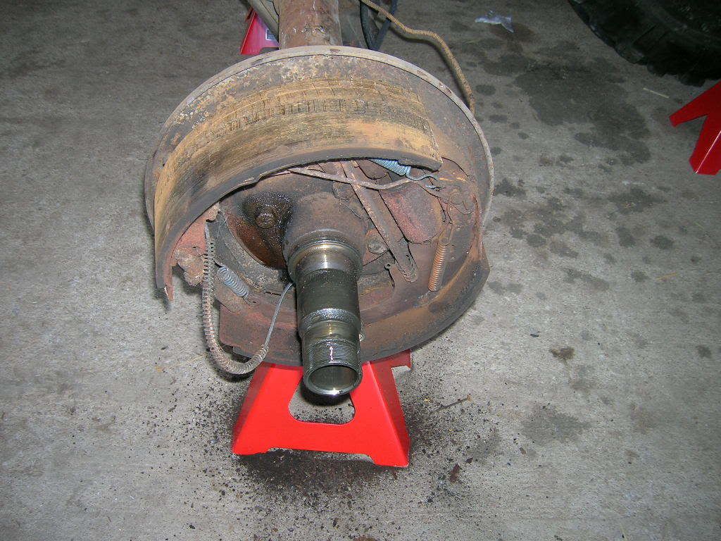

I decided to do the disk brake conversion on
the 14 bolt this weekend
This is no easy chore on a FF 14 bolt.

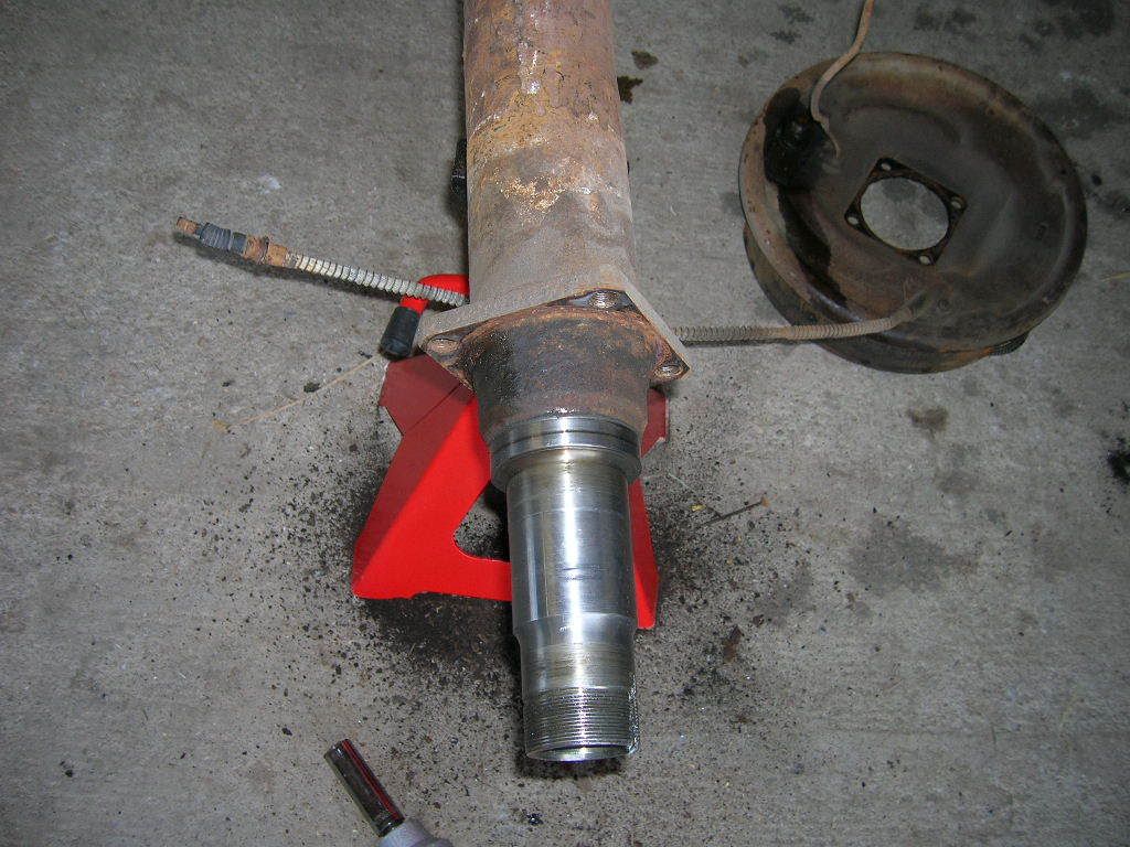

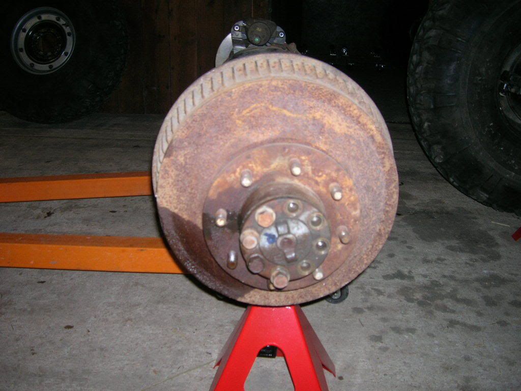

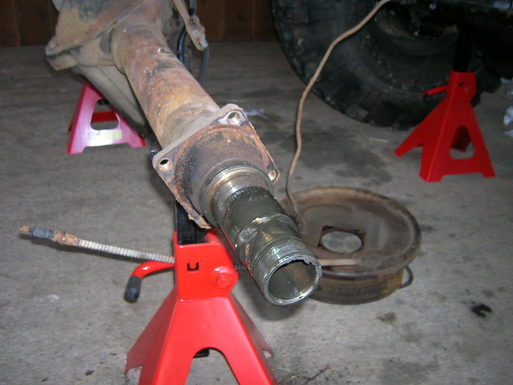

Started with this (drum brake set up)
Backed out the bolts on the hub and pulled the
axle. That was easy enough
Then the real fun begins. Here is what it looked like
When I pulled the axle out.

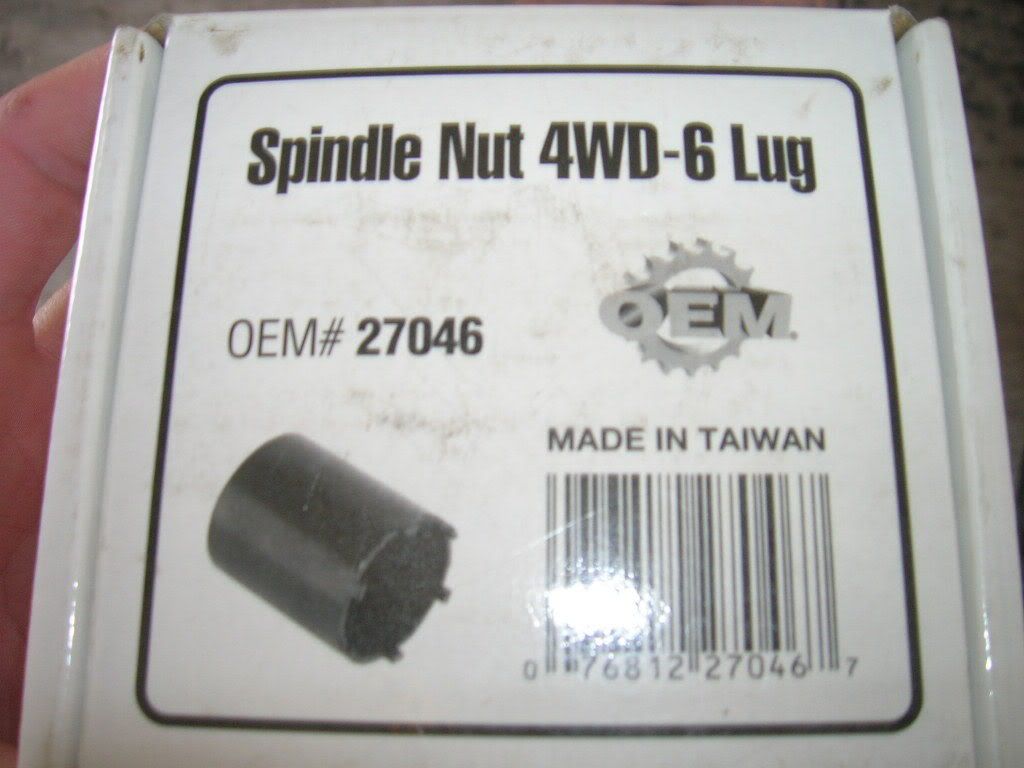

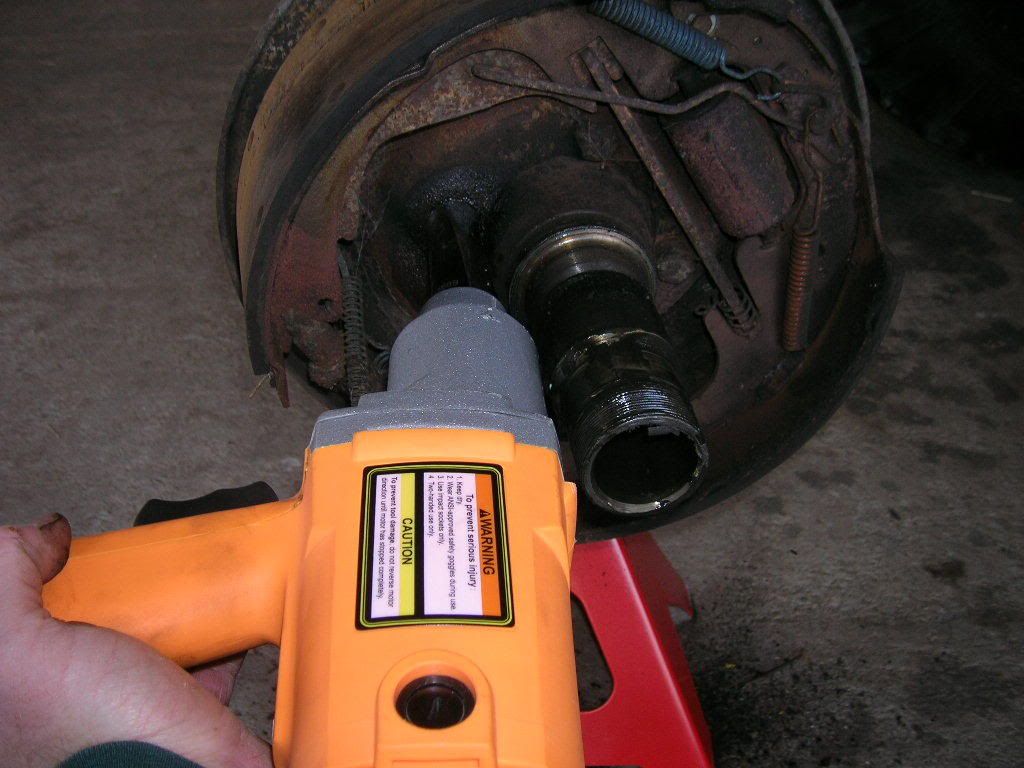

At this point I knew I didn't have all the tools
for the job. Ran to auto zone and picked up
a 6 prong socket to remove the spindle nut.
Got the first one off

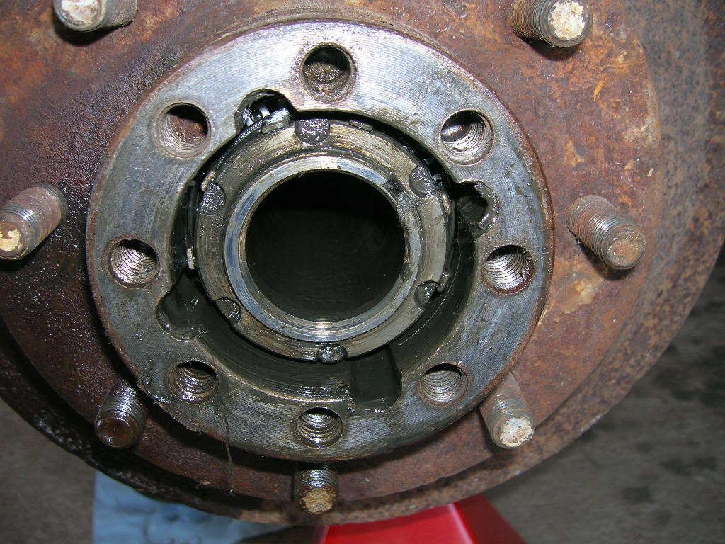

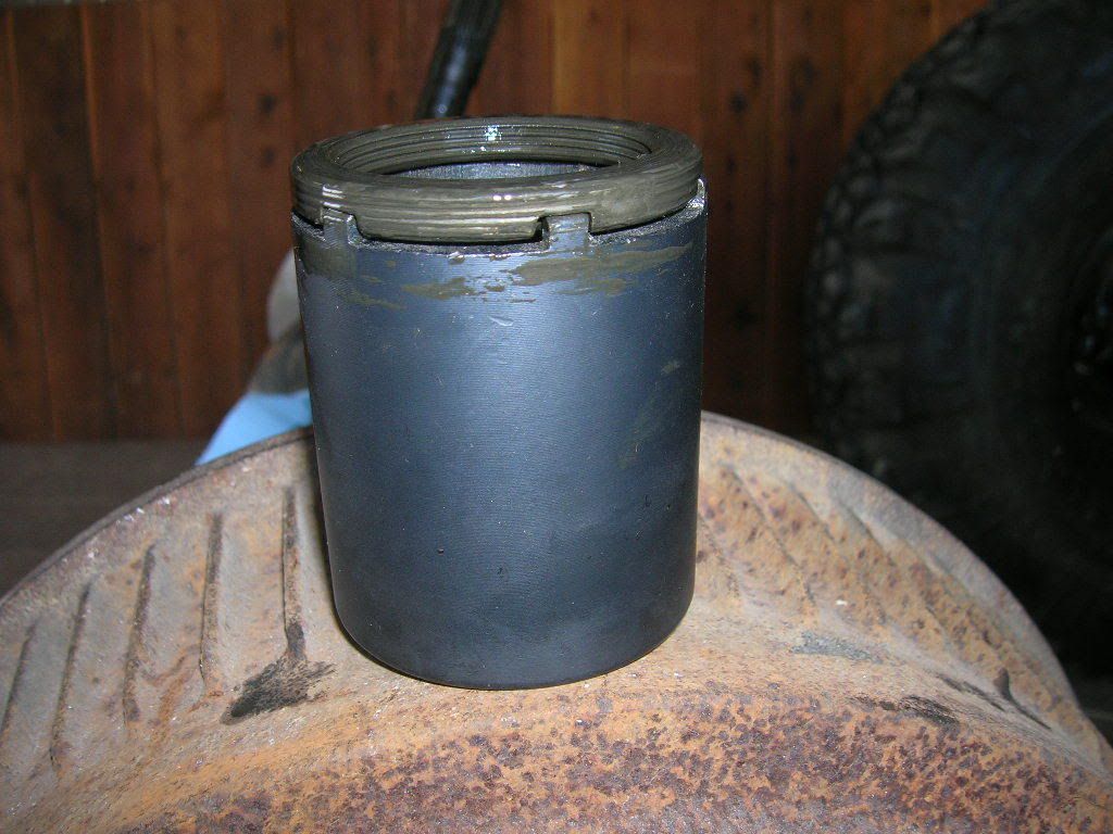

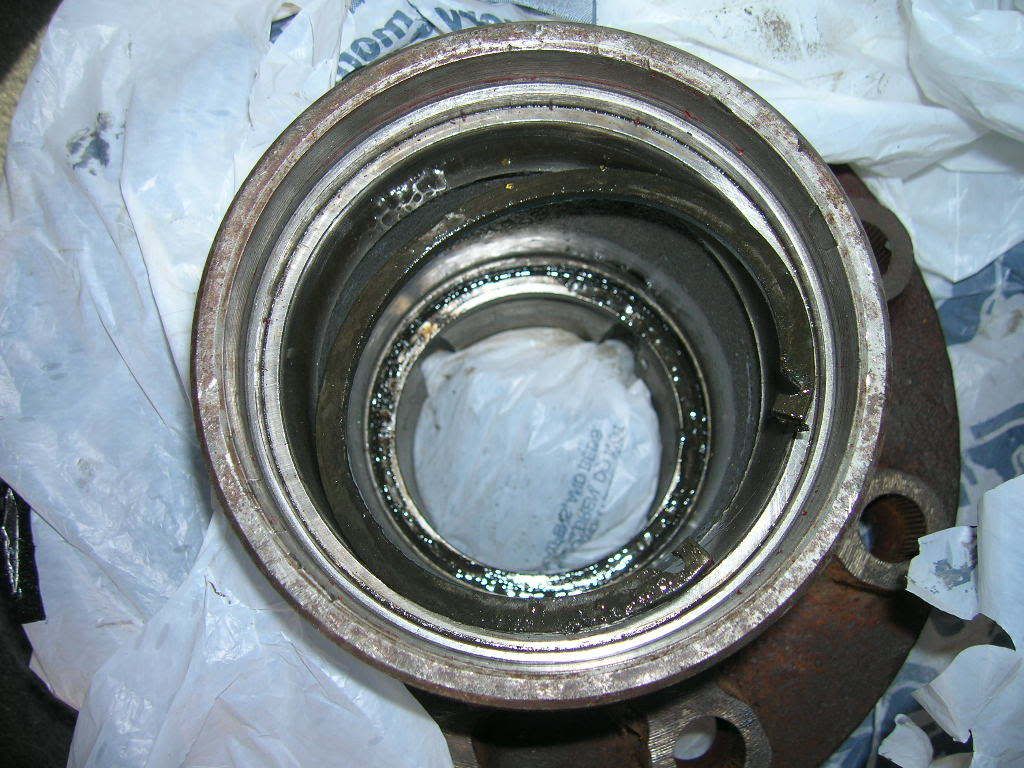

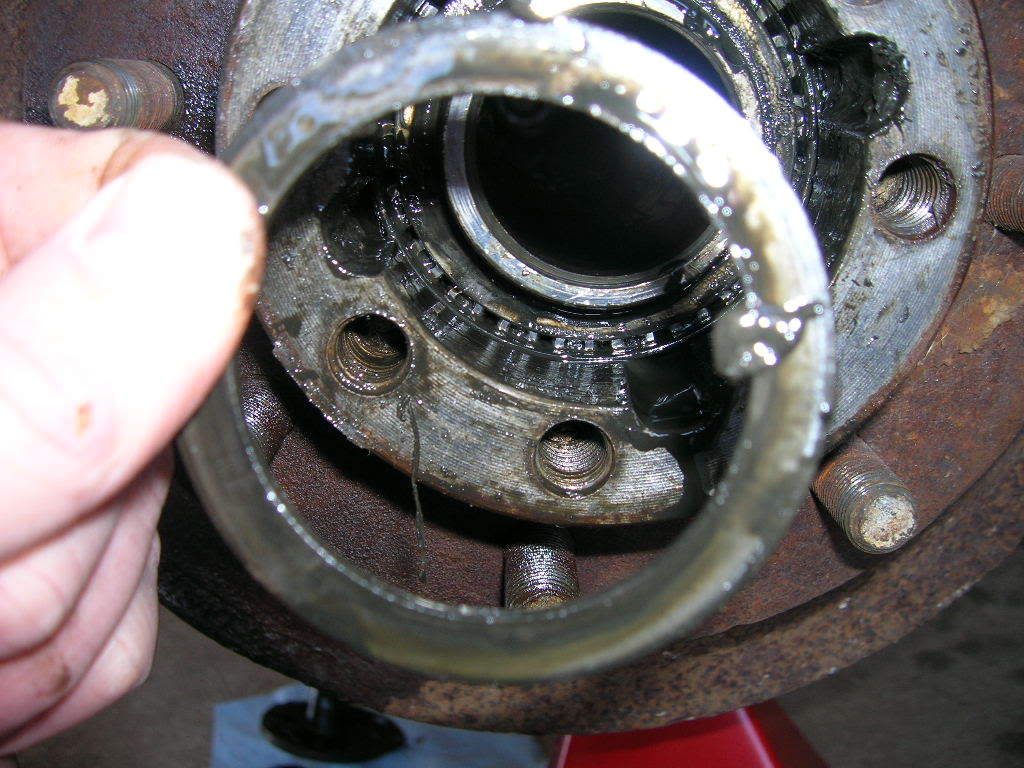

Only to notice that the retainer was jacked.
Pulled the last piece out

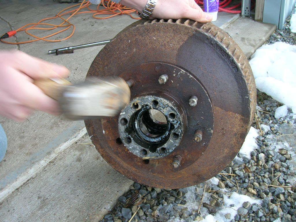

I had my brother in law come over. We took turns
cranking on that drum to try and get it off for over
15 min. This is what I had to say to it.

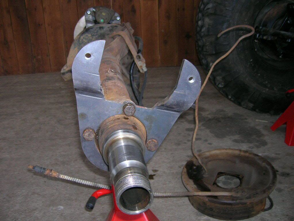

At last that POS came off
Took the OX out and un bolted the 4 bolts holding the drum on.
Bolted up the disk brake holder
BUY IT DONT' BUILD IT!! You will be money and time ahead. (Flip off)

Took the 5# sledge out and took the lugs out (that was the easy part)
The next part put an end to my day.
There was a keeper in and none of my tools
were big enough. I took it to a local drive line
place and they took it out for free for me today
