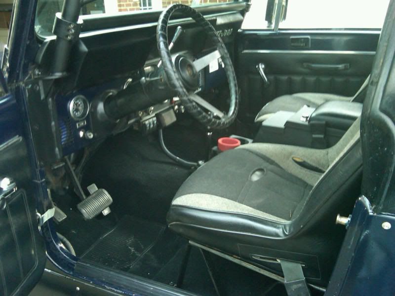

If you look at the upper left of this picture, you can see why you need the right pad to work with the cage. Plus, no room to open a vent window.
