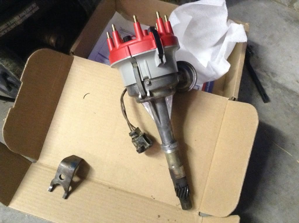

Cleaned the distributor up and installed the new adapt-a-cap

Just a note on the big cap and adapter for your Motorcraft distributer, in case you missed it in your research....
The V8 version requires a custom-made alignment tap to prevent the adapter from spinning on the distributor housing. Jeephammer describes how he makes them on post #2, here:

Thanks Matt. I had seen that - and was looking forward to an excuse to drink a beer. The adapt-a-cap seemed to fit perfectly without modification. I'll take another look, and probably another, and another... to just to be sure.

Yes, the adapter will fit fine, but there's nothing to keep it from rotating on the housing unless you make an alignment tab. Try it, you'll see what I'm talking about.

Actually, the screw and tab are factory, and in the correct position...
Hard to screw up the position, since there is only ONE screw hole drilled in the housing.
Looks like factory Ford tab in this picture of yours...
When I go to the salvage yard, I unscrew all the tabs off the Ford distributors since when I get a hold of a razor knife after drinking it usually involves stitches...
Anyway, I saw the tab/screw and knew it was 'Right' for your application, So far, you are doing one heck of a job! Keep up the good work!

Sorry about the confusion on the alignment tap. I didn't look at your pic closely enough.
Apparently, it's just the reman'd units that don't have the tap. I know neither of mine had them, which wasn't surprising considering the overall poor quality of the reman'd units, in general.
