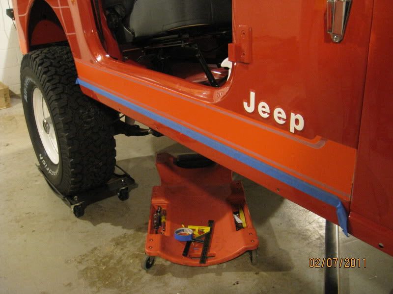

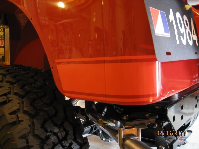

Thanks for the responses folks. I have a big red hood just yelling at me for the R word.
Don't know if I'll be able to squeeze in 3 beers and a couple of glasses of red this morning though Keith460 but I'll give it a shot. Might overshoot that mark if there are two of us.

Interesting the instructions said use no liquid at all because everyone here who's replied as well as my instructions say that I should use gel or weak soapy water on large decals then squeegy out liquid. I didn't use any liquid on the small rear corner one I did last night and even this morning it's a bit iffy.
I just put on the other side corner and will leave the backing for three hours as they suggest.
I have a sign guy who makes really nice "knife cut" decals for our business which I stick on our cars and all around our sea container machines and they never move. In fact they are a pr*%k to get off if you want to sell the car. They only have a weak waxy backing which peels off real nice.
The backing on these Phoenix graphics is so sticky it just wants to peel the decals right back off again.
I just don't seem to get it.

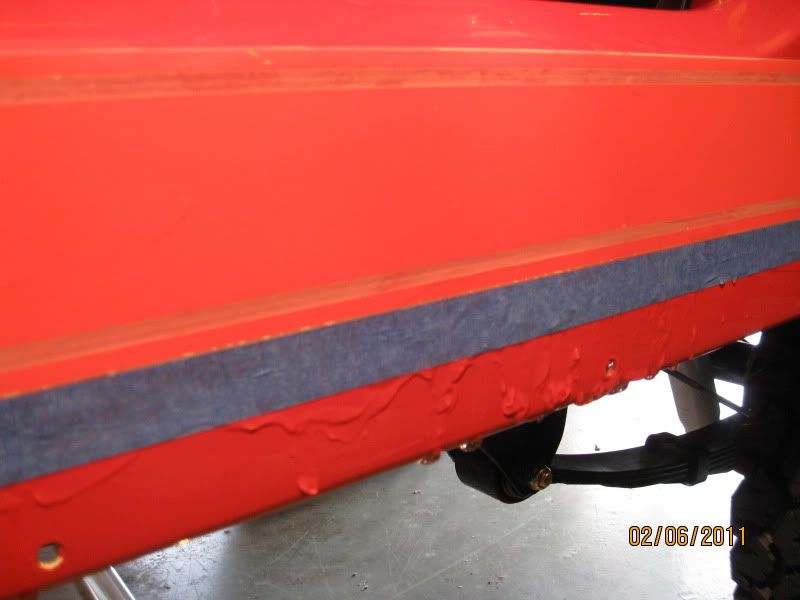

Right. So here I am on Friday arvo with number two beer in front of me. Back in my shop is a pile of sticky orange plastic and "backing". I am one pi$&ed off mother [email protected]/ker right now. I will post from my computer later and show some pix.
Man that backing plastic stuck like ****e to a blanket and pulled everything off with it. I followed all the rules.
I stick knife cut decals on my work jobs and cant understand why these things aren't as easy.
I'll talk later when I've had a hundred more beers
