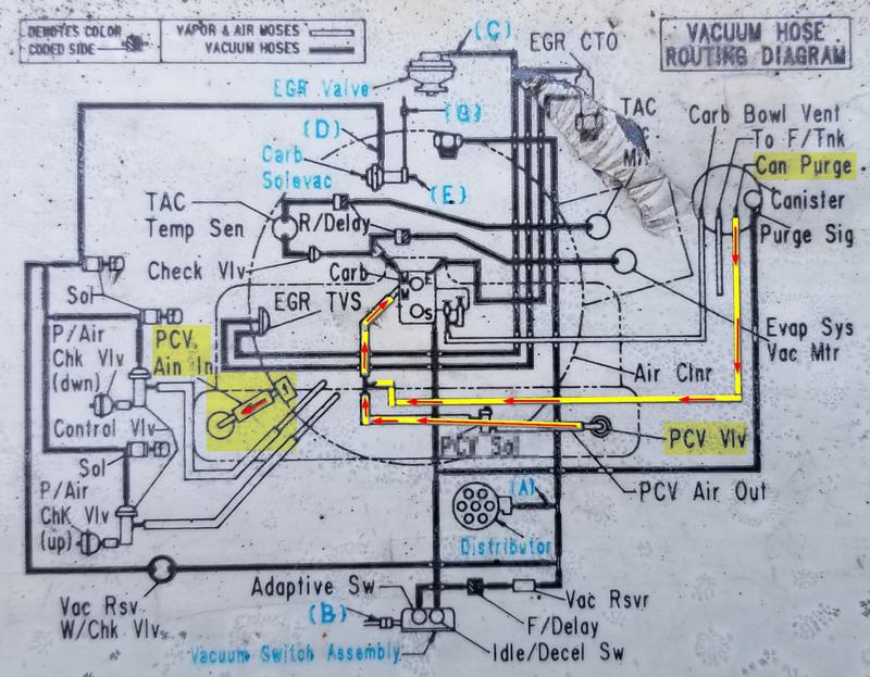

On my year, 1984, it's a T from the manifold split between Vapor Canister and PCV.
And, yes, I tried to removing the hose from the Vacuum Canister with a vacuum gauge rigged up to the back of the Valve Cover and nothing. Didn't make a bit of difference.
Thanks

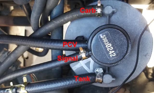

Exactly like this:
Thanks
CJ7Guy1 is offline

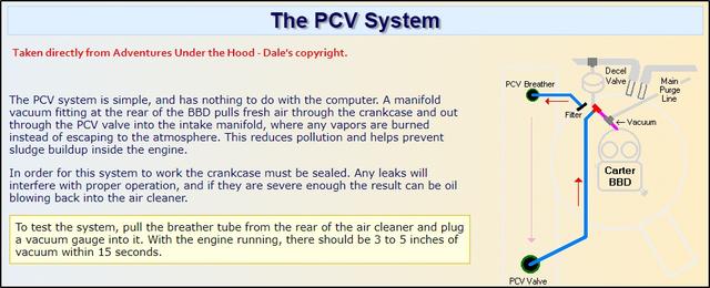

Actually, there should be very little vacuum at the rear hose at idle, or at any non-loaded RPM. PCV valves work opposite of what most guys think. They flow the least when the vacuum is highest, and the most when vacuum is lowest. Vacuum is lowest when the engine is under heavy load. You aren't loading the engine when you are just revving it in the driveway.
I know Dales website (Adventures Under the Hood) says there should be 3-5" of vacuum at the rear hose within 15 seconds at idle, but I haven't been able to confirm that in any TSM I've read. The TSM recommends doing a flow rate test on the PCV valve using a specialized testing tool. Then they give the flow rate specifications for each type PCV valves used in different displacements.
Here's the deal, if your engine has excessive blowby, it serves to close the PCV valve even further than it usually is at idle. That could very easily explain why you aren't getting any vacuum at the rear hose.
Why are you so opposed to doing a compression or leak-down test? Wouldn't you rather rule out bad rings than continue chasing ghosts?
Matt
