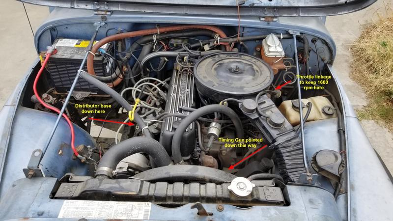

Anybody have a good One Man Tune-Up Strategy?
Meaning, the distributor is on the other side of the engine bay from where you can possibly shoot your timing light at the crank notch not to mention, you have to maintain a 1600 rpm.

Regarding the timing light and setting the distributor, stand in front of the vehicle. You don't need to reach the bottom/base of the distributor, you can set it by holding on to the distributor cap. Loosen the holddown bolt just enough to be able to turn the distributor, but not so much that it turns due to the rotation of the motor.

This is from my hood.

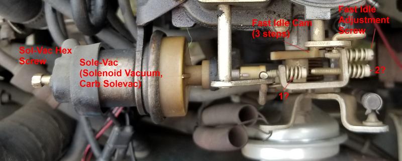

Keith, which adjustment screw do you use to temporally adjust the idle to 1600?
