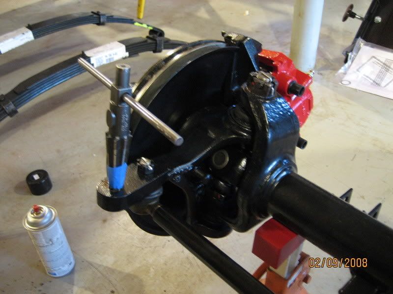

I am going to be doing the tie rod flip on my cj7 tomorrow. i been reading alot of old posts on here and reading the instructions over n over. So let me see if i got this right . you insert the reamer from the bottom and put a piece a tape on the reamer as a guide but move it down 1/64. then ream from the top to the tape and insert the insert at top to check if it 1/64 from going all the way in. if so insert the insert from the bottom and it should sit flush. if not take very little out of the bottom till it does. hope this sounds right

Just a note about the instructions from OKFWD, the bushings should seat flush at the bottom when you are finally complete. They say to have at least 1/64" protruding from the top when fitting but I found this to be misleading. You actually want this to stick out the bottom by about 1/64" and let the castle nut pull it in when tightening the ball joints up. I also found that you get a much better taper joint if you use the reamer chucked in a 1/2" drill and use cutting oil to assist in removing the material needed. Go slow, and check taper bushing for fitment often.
