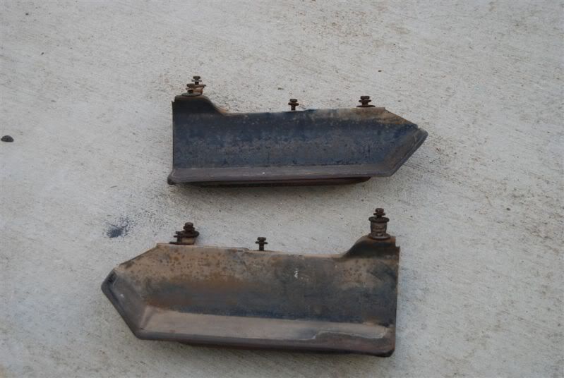

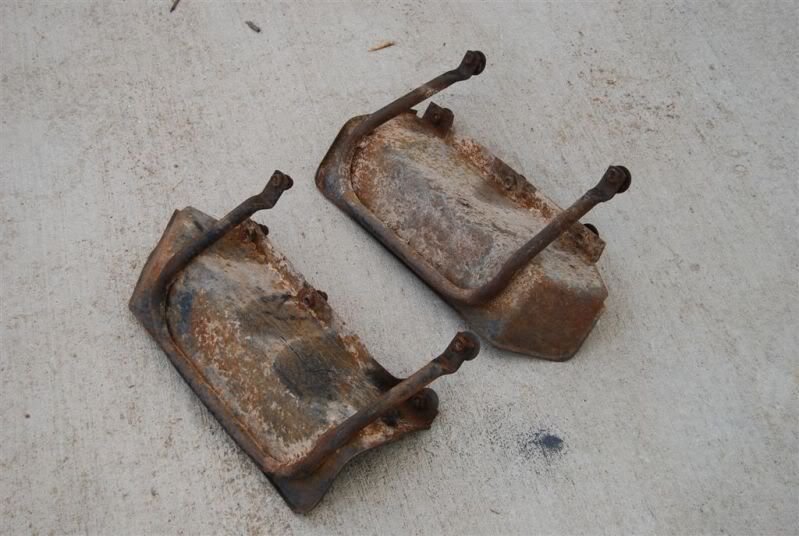

Hey guys,
I'm thinking about getting some OEM side steps for CJ and just recently started searching for a decent pair. I found a set on CL and the guys is asking 100 for the pair. Below are some pictures he sent me. Is $100 a fair price, if not what is the fair/going price for these steps? Here is the description and pics he sent me:
The black ones have all the bolts and they are free (not frozen). One of the weld nuts is loose though.
Thanks!!

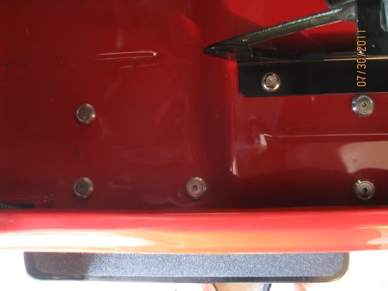

My 84' had original side steps on them as well, but got mangled up so bad from wheeling that I took them off and scrapped them. During restoration I acquired another pair from a forum member who took them off his tub and didn't want them anymore. Paid $40.00 for the set shipped. Sandblasting and powder coating is all they needed and then made a template for the non-skid tape like the originals pattern.
The deals are out there if you have patience.
Then you will need to install them in the OEM location.

Just sold a set in similar condition as the one you have pictured on ebay. Two guys bid them up to $130 shipped.

I like those mounting bolts for your steps. What type are they?

The bolts are S.S. Flat Head Allen 3/8-16 x 1"L
The washer are JEGS Billet Countersunk Finish Washers for 3/8" Flat head Bolts and can be found here: http://www.jegs.com/i/JEGS+Performance+Products/555/83503/10002/-1
They are much nicer than the OEM large flat washer and hex head bolts that are used for part of the step mounting. 1-1/8" OD is plenty of displaced support for the floor sheet metal and they don't protrude up so much.

Expensive little buggers, aren't they?

Yes they are but you get at least two in the pack. Good chit cost money and Jeeps CJ's are always begging for funds.
