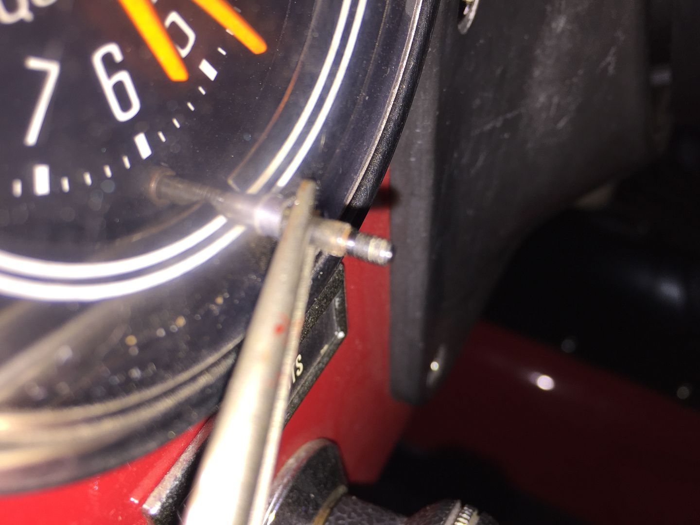

Originally Posted by Matt1981CJ7 View Post
Ernie,
Thanks. You are correct, the adjustment rod is splined not threaded. I had to break out the magnifying glass to see it. It's rare for Keith to be mistaken.
Matt
And Iím not mistaken. At least for the 1984 model year clock. I just took my knob off, while holding it out with a pair of needle nose pliers and the knob unscrews.
Not a clear picture like I hoped but it is threaded.
Sent from my iPhone using Tapatalk

Originally Posted by keith460 View Post
And I’m not mistaken. At least for the 1984 model year clock. I just took my knob off, while holding it out with a pair of needle nose pliers and the knob unscrews.
Gee, Keith, you didn't have to go to that trouble, but thanks.
It appears we were both correct, and the clock supplier changed the design at some point. I managed to take a clear pic of mine, and it is definitely splined.
Just another nuance that makes these CJs so unique, I guess.
Matt
