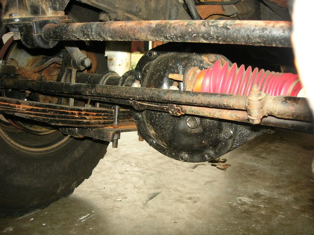

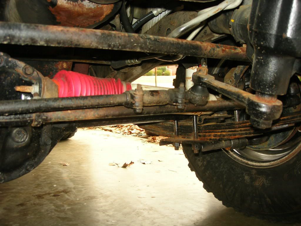

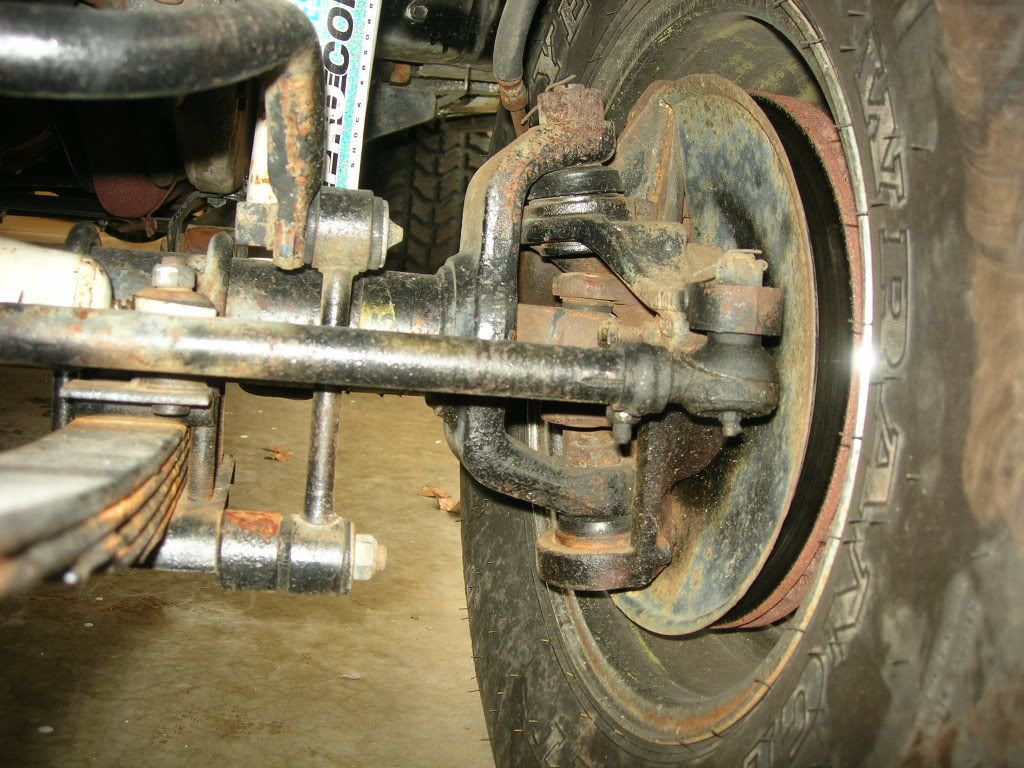

Now I am on to the steering. I have read the article on bump steer (thank you James) and have measured my caster angles, they are at 4* which is right. I haven't had a buddy turn the wheel yet while I look at all the steering components for looseness but will be doing that this weekend.
The problem I am having is not extremely severe but enough that it warrants some kind of change. My steering wheel has between 1-2" of play, the tires move by themselves a certain degree when hitting a bump or dip in the road and when riding on an uneven surface at, for example, 40-45mph I fight with the Jeep to keep it straight which can be difficult. There is no knocking or any other noises when the steering wheel is turned.
After looking at all the pictures in this post https://www.jeepforum.com/forum/showthread.php?t=509963, I looked at my Jeep and my components are at severely different angles than his. I tried to take the exact same picture angles as MuddyMules. My questions follow pictures.
My questions are these:
1) How can I tell if there has been a lift and how much? From ground to bottom of frame is approximately 18". From ground to tub is approximately 23". I don't know if that helps.
2) From looking at my pictures, can you tell if anything is wrong with my steering component angles or anything else that may need to have an eye kept on it while searching for reasons (seems the drag link should be angled up more and steering stabilizer at a more parallel angle to the tie rod?)?
I don't do rock crawling or anything extreme and don't want to spend unneccessary money if I don't need to but if you can see anything that would make an impact, please let me know. I be getting an alignment soon but would rather do it after any repairs.
I thank everyone in advance for your help.
Brian

Looks like a 2-2.5" lift from what I can tell. I fit 33" skinny BFG All-Terrains on my stock CJ with only a 1-1.5" lift and it didn't rub at all. You can probably fit 31" on a stock CJ with a little rubbing during extreme flex, and 33" with a 2" lift.
As far as steering goes, everything looks normal to me. CJs are notorious for having loose steering, so get used to it. Look through some of the threads in this forum. Loose steering is the most popular issue with CJs. Every situation is different. Make sure your tie rods don't have any play, and check your ball joints to make sure they aren't worn out. You can also adjust your steering box but make sure you know what you're doing before you attempt to do so. Some people have even ended up replacing the steering box, which is a pain.
Also, I don't see the point in getting an alignment unless it's pulling to one side. Getting an alignment job isn't going to fix sloppy or loose steering.

Thanks. I know it seems to be a pretty re-occuring theme and I have read ALOT of threads about steering. Just when I saw the pictures from the other thread and saw the difference in mine, I thought maybe someone would see my pictures and have a bright idea.
Thanks for responding...I'll be checking for play in tie rods this weekend. I'll check out the ball joints too.

When I got my jeep, I thought the same thing. It has 33s so therefore it has a lift. Mine does not have a lift and the 33s only measure 31' tall. Your steering looks very straight to have a lift. 33s will fit on any jeep without a lift. You just don't want to flex them. Great looking jeep.

You should also be sure that your ball joints and axle U-joints are greased and not binding. You'll have to pop the drag link off the steering arm, but its worth checking. A steering box brace is a good idea too. Check for broken or loose steering box mounts, its a very common problem.

luckycheesehead - I will take some pictures after the new tie rods are installed this weekend and then you can take a look and see if I have a difference from my current tie rods and the new ones. You may have a 2" lift, I cannot tell, but with 33's, I would think that there could be. I also have YJ springs on my CJ with a 1" Shackle. This could be the difference in our tie rod angles. Anyone else have an opinion on this?
