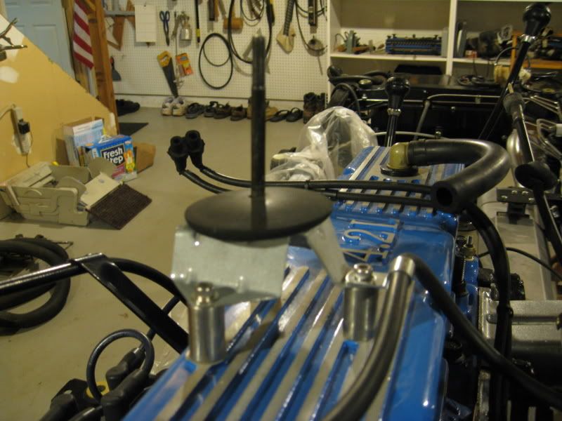

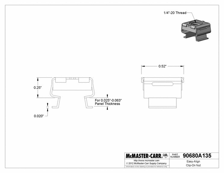

Once you have the bracket, you can get the correct OEM hardware from website vendors.
Here's the nut that slips into bracket and is able to slide back and forth for aligning the air cleaner lid assembly.
The correct stud, which is 3-1/2" and has 1/4-20 threads, can also be had from McMaster-Carr. Part #90281A092
Two OEM wing nuts to hold it down can be bought here: http://www.amarkamc.com/product.sc?p...&categoryId=43
But I think Ace Hardware stock the same type of wing nut in their stores.
Still working on where to find the dome shaped pad but i have seen it before.

What dome shaped pad? I may have it laying around also.

The one pictured that sits on top of the bracket and slides over the threaded stud.

Don't have it.

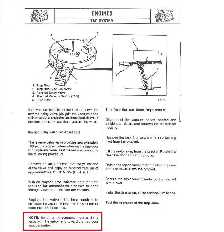

Well, the OEM air cleaner will get you fresh cool incoming air and not half baked heated air from the engine compartment.
It will deliver heated air to the carb for faster start ups via the heated duct work coming off the exhaust manifold.
The vacuum motors control the mix of air coming into the air cleaner and only delivers fresh cool air after the carb choke is no longer needed.
When the engine is shut down and parked, the vacuum motors close the system and prevents mice and other unwanted varmints from entering the air cleaner.
Provides clean air the the engine PCV system.

What Keith said. ^^^^
Also, air filters will last about 10 times longer, if you regularly drive on dusty roads, due to the "closed" design.
