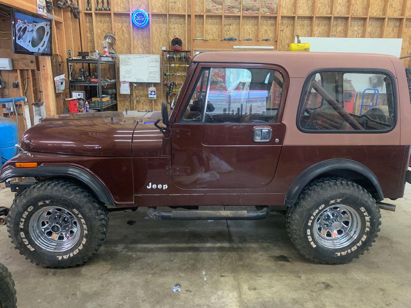

post #111 of 116 Old 09-28-2019, 11:35 AM Thread Starter
dn101009
1984 CJ7
Location: Medford
Posts: 301
Well after what like 5 years, I finally have my jeep up and running and on the road. Still have some stuff to do. Need to finish some wiring cleanup, get it all in loom, get a new oil pan, and a few other odds and ends. However, I have been driving it a little. I i continually make improvements on the tune, it builds 10lbs of boost and is very fun and zippy to drive. Does not feel like a little 4 cylinder. Overall I am pretty happy and I'm sure it will be getting driven by my wife and myself quite often.
