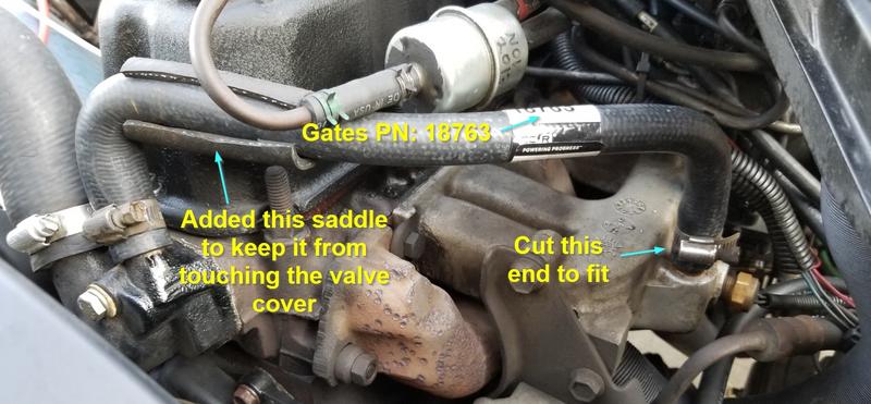

Here's the retro repair job I did because this amazing site and either John or Matt or some other amazing fellow Jeep nerd supplied the part number for the hose that comes pretty close to perfect to the original:
Gates PN: 18763 Coolant Hose - $7 (a/o this posting)
Yes, so, hope that satisfies your curiosity. Sounds kinda lame as I proof read it, but, there it is.

So tell me, what is the source and part number for this hose that is very difficult to find? Not that I don't have the correct one, but it is always a good idea to have a future source for this hose if the need arises. And, I have two of those straight coolant nipples in my parts inventory if you need them.

Here you go:
https://www.napaonline.com/en/p/NBG1...ordInput=10763
JS

Gates PN: 18763 Coolant Hose and I updated the original image and added this same info below the image.
