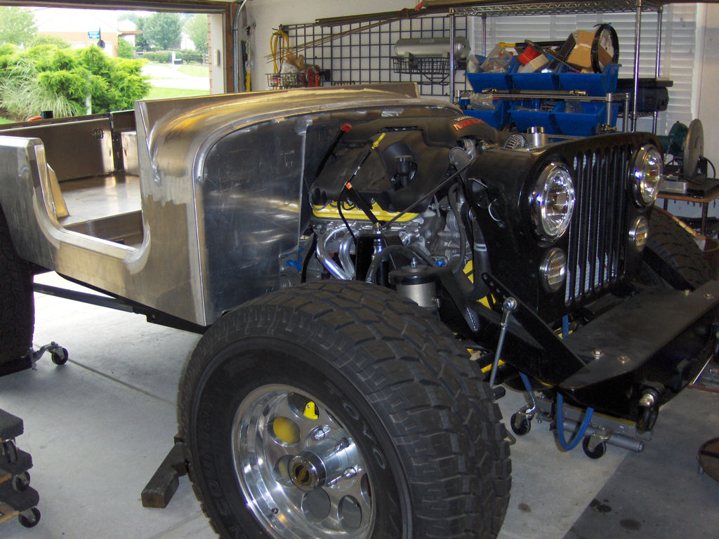

Just a couple poser pics!
I had a grade 12 student come over and help me vapor barrier the other 1/2 of the garage. Had to roll the Scrambler out and Karen, my wife, snapped a couple pics!
Holidays start in ONE day!! Woohoo- should have some shop time coming up!!!!

After I got over just how small the tires are on your rig , I turned my attention to the view behind you. That's some pretty country you live in there Jim.

Man that thing is lookin awesome!

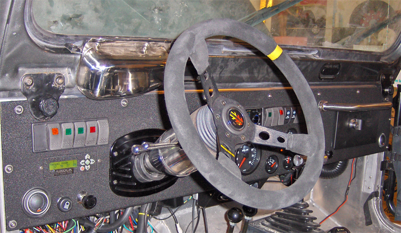

I mounted the ORO controller in the dash, so it's actually a full auto air system.
It may sound dumb, but the primary reason was to use the full droop setting to get the WTF-J to clear a standard 7' garage door with the cage. The fact that it is a great on/off road setup is gravy.

Oh, I thought those were schrader valves on top of the coil tower. Darn, I put in an 8 foot garage door, so I can't use your reason for the Airocks as an excuse! Oh well.
Got another question for you. What steering column did you use?

Flaming River stainless tilt.
