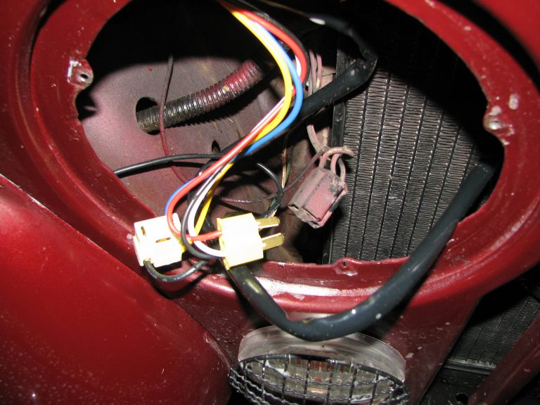

Ok, I'm resurrecting this thread with another question. I just received the wiring upgrade harness from Rodtiques LLC. Everything on the harness makes sense for installation. My question concerns the existing wiring under the hood/firewall of my jeep.
I can't seem to find where the new harness plugs into the old harness wiring. The new harness has the male end plug, so I would be looking for the female end on old wiring. Can't find that. Was wondering if there is no plug on old wiring, will I need to splice into old wiring and add the female plug where I splice the wire?

Usually it plugs into the old headlight plug.
