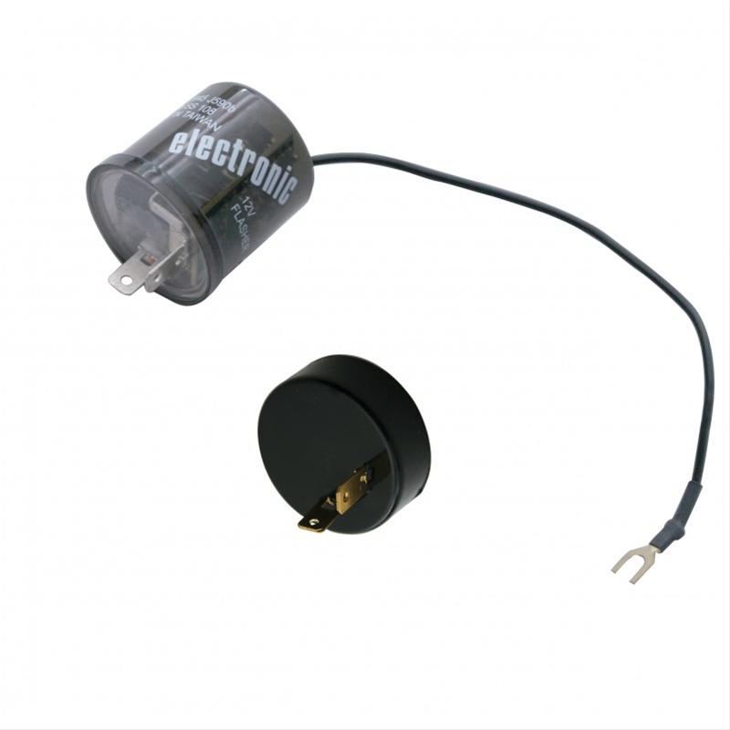

Yes, that is exactly what I did. The company calls their little plastic puck a "Reverse Polarity Base" but essentially I just reversed the feed and the load. If I had one of those little connector tools that is made to release the terminal from the sockets it would have been easier, but a jeweler's screwdriver does the trick and it is much cleaner not to have the adapter installed anyway. The best part is that the old style flashers do not care which way those two wires are connected so you can sill use the old flasher after the mod if needed. The worst part of finding a flasher was determining what I needed. Some people say one will work and another person says the same model flasher would not work with LEDs. The local chain parts shops acted like they had never heard of anyone needing such a thing. It is not like LED tail lights are some type of new upgrade or something.
OK I see, You swapped the terminals in the socket so that the power goes to the correct pin and grounded a wire from the flasher? Or something else. The extra socket allows you to swap the terminals without removing any of the original wiring. Clever.
OK that makes sense. I wouldn't actually call it polarity reversing but I see their point.
Pictures please.

I changed all of my lights on my 85 CJ 7 to LED's this past summer. I used Quadratec LED tail lights and installed LED bulbs in the remaining external sockets. The electronic flasher that came with the Quadratec tail lights kit would not flash with all bulbs installed no matter what I did. I noticed that it was rated for 20 amps. I finally found an electronic flasher that was rated for 25 amps, installed it and lo and behold, now all bulbs and flashing speeds work perfectly.
I understand basic electricity fairly well. But I don't understand how increasing the amperage rating of the electronic flasher could solve my problem. But it did! So, once again, it appears that magic and voodoo won out.
In my advanced age, I have learned not to argue with what works. It may or may not work for your situation, but now all my LED lights work perfectly with an electronic flasher rated for 25 amps.

Care to supply the brand name of the electronic 25 amp flasher you used that functioned correctly? Otherwise your post is kinda just for your pleasure. I'd say you simply got lucky and found a high amp rated electronic flasher that some smart electronics engineer designed to operate off very low amp flow. That way it can handle just a few, to all the LED's a fully decked out 18 wheeler uses.
Doesn't surprise me at all to hear Quadratec supplied you with one that wasn't correct for the application. Lot's of ignorance out there in the world. I'll add that the electronic flasher that is talked about above by Stonetower and John Strenk is also rated at 25 amps. You probably ended up with the same exact flasher, which is designed for LED applications and that is why it worked.

No confusion here on my end. Took a look at the part # flasher crusty supplied. It came out of the same factory as all the rest, just marketed as CEC brand.
So it doesn't get lost in the background noise, the most important thing to take away from this thread is be aware of the polarity issue and purchase a flasher that says LED compatible.
