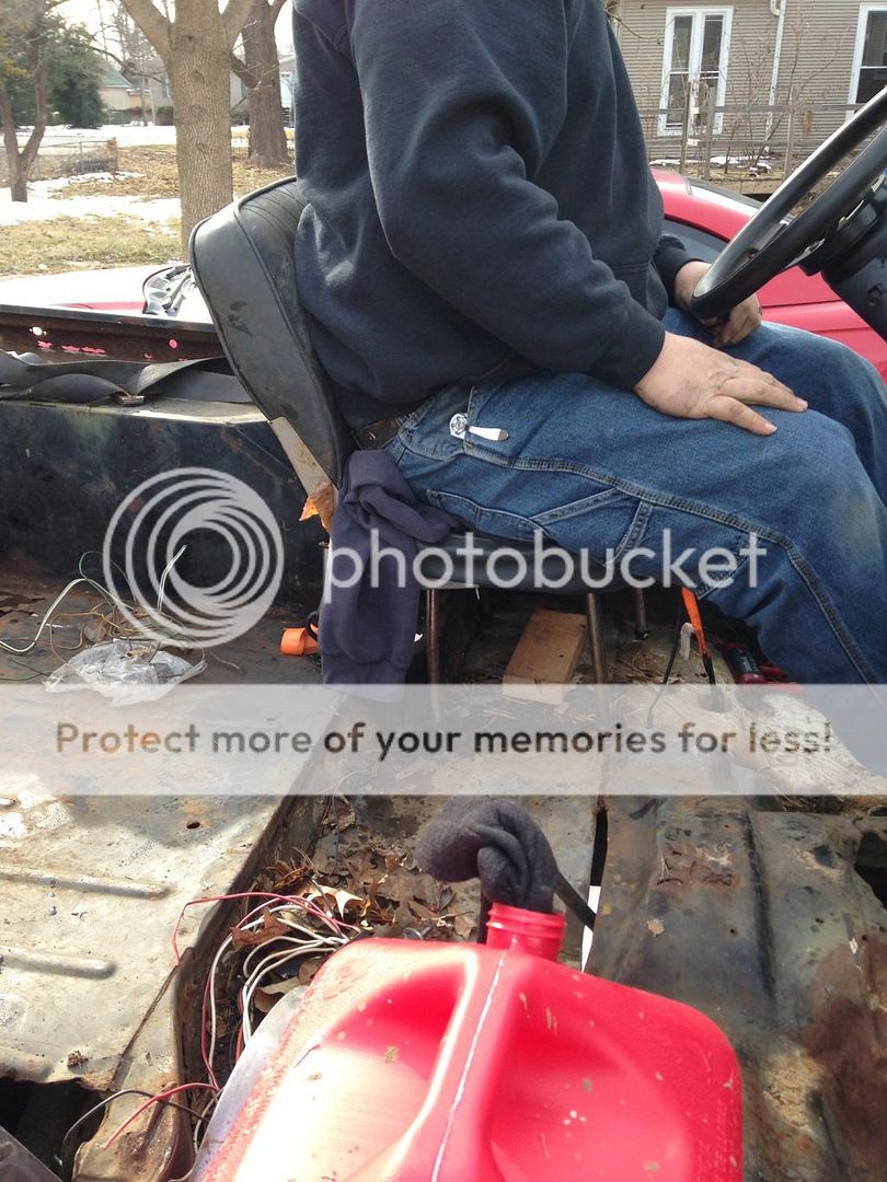

The seat
Old stool, boat seat, and rachet strap!
