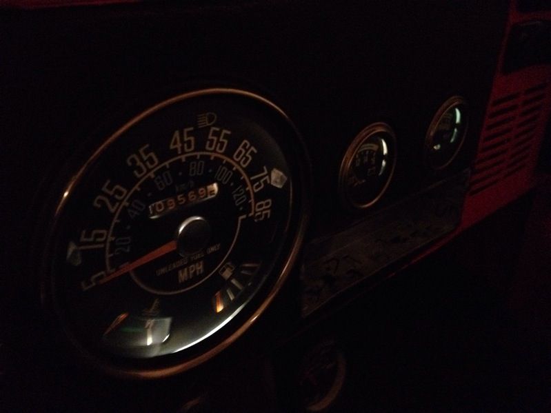

Let there be light! Swapped out the switch and voila... Dash lights work. Two of the lever lights are out (fan speed and vent/heat), but everything else lit up like Christmas.
