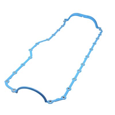

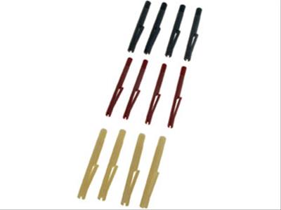

Also, if you drop the pan, get a one piece gasket for the oil pan and those 'thingies' that hold the gasket in place when you lift up the oil pan.
https://www.summitracing.com/parts/f...xoCufYQAvD_BwE
https://www.summitracing.com/parts/rnb-45722
Those look super useful. I will be sure to get a set!
