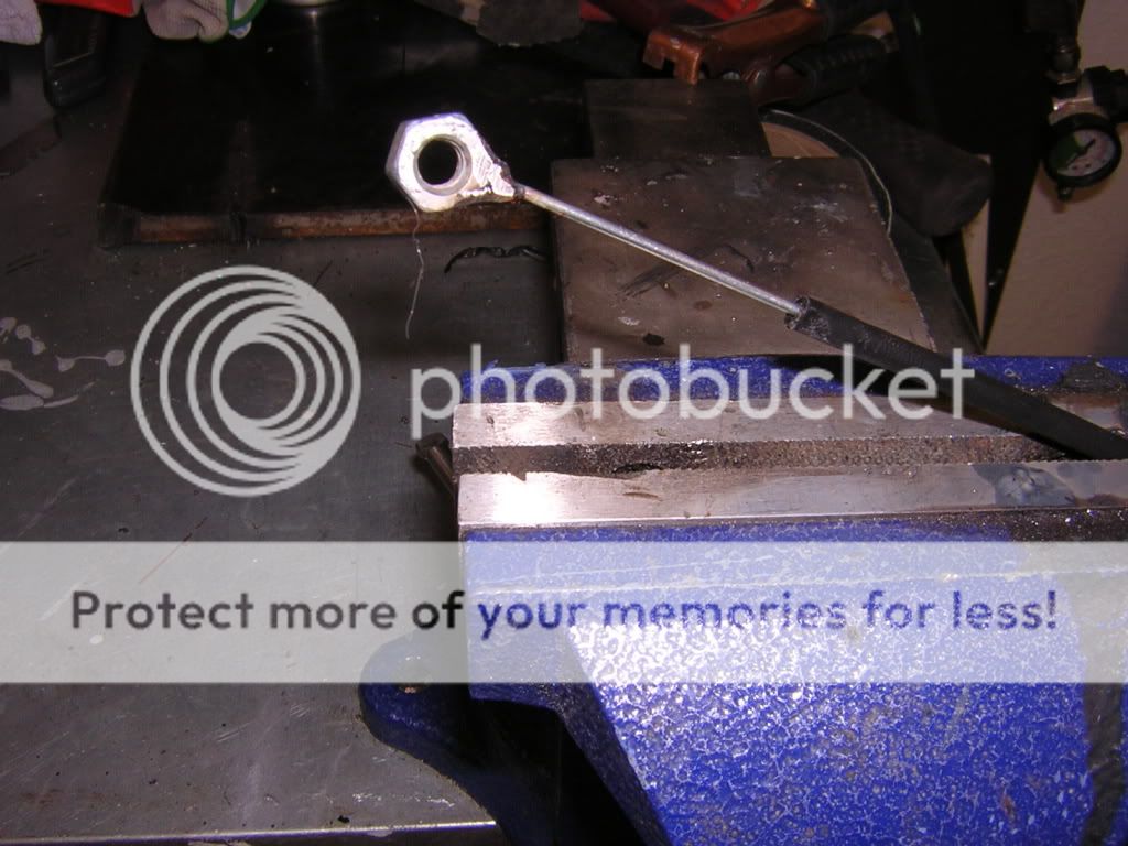

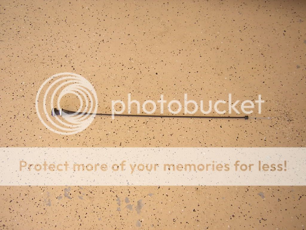

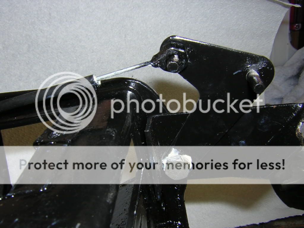

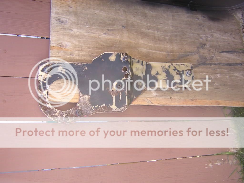

Temp Internal Cable

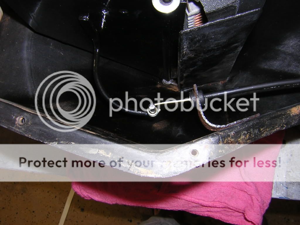

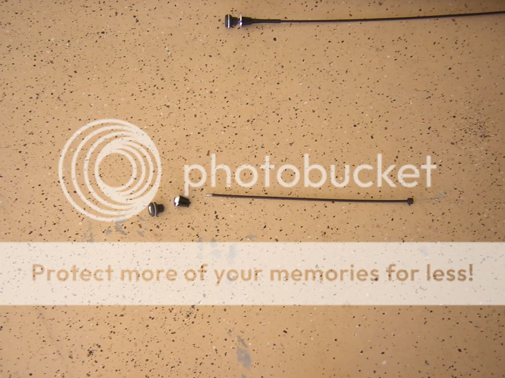

I started with a dash 21" cable
Then cut off the knob and snap in section
Then welded nut to end of cable (a better way, is to use the long cable and create the factory loop configuration)
Attached inside
Attached external side, outside of cable housing has an attachment clip when installing cover
Tomorrow will post some pic's start to finish
Attached inside
YEP!!! THOSE kinds of pics!!

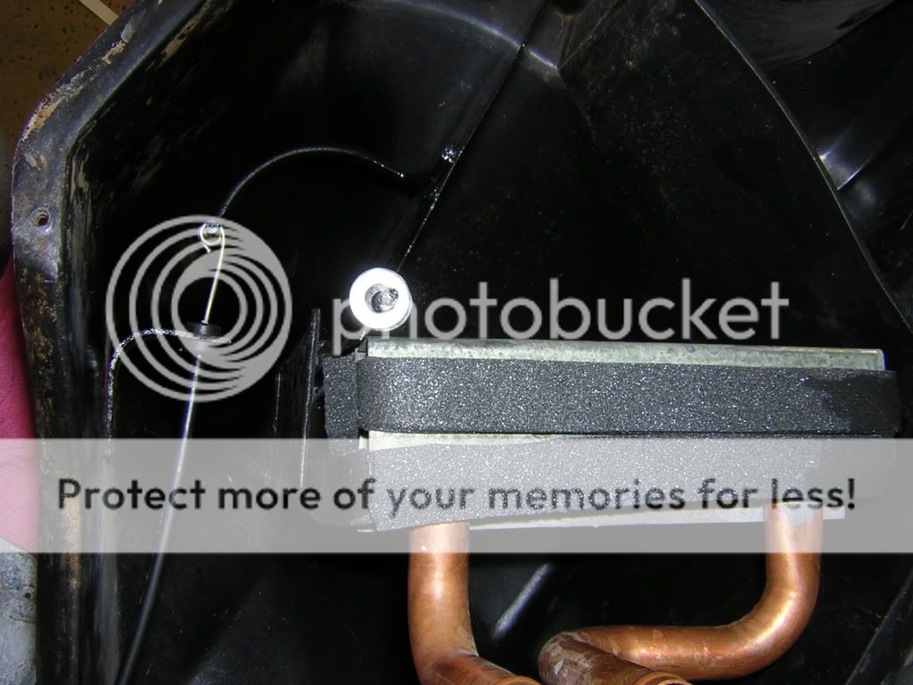

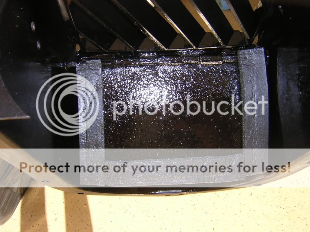

I used home depot , Frost King, foam weather strip.. comes in different configurations,, or review others post ,

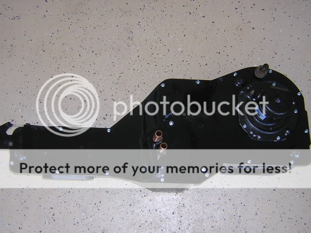

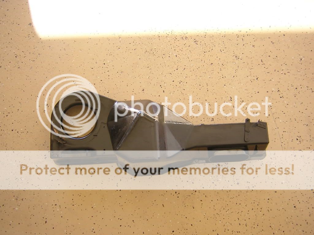

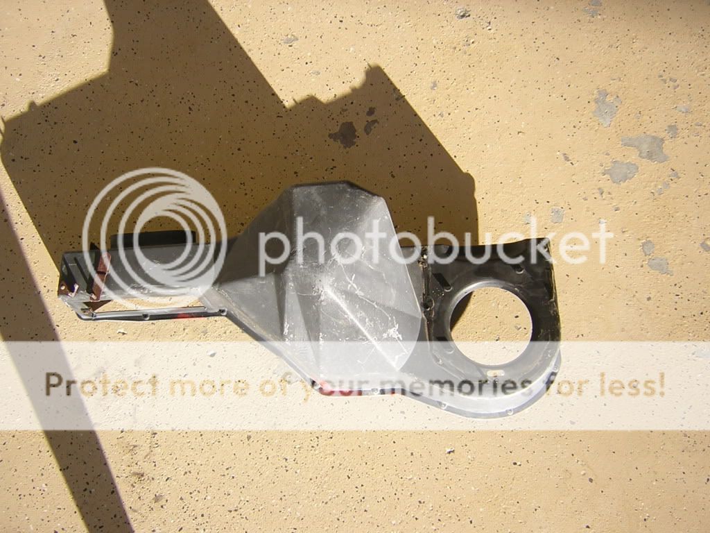

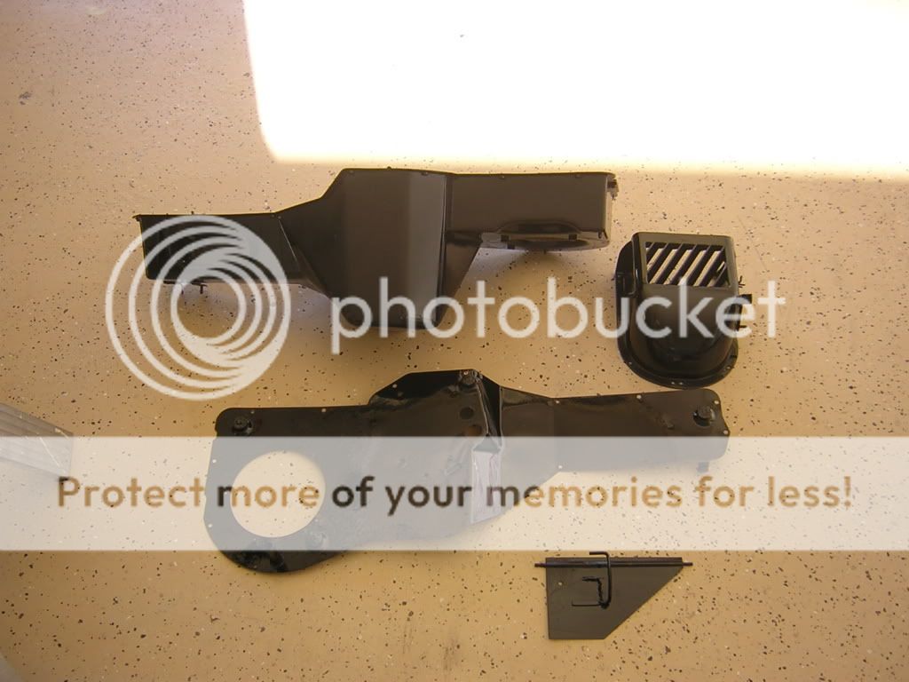

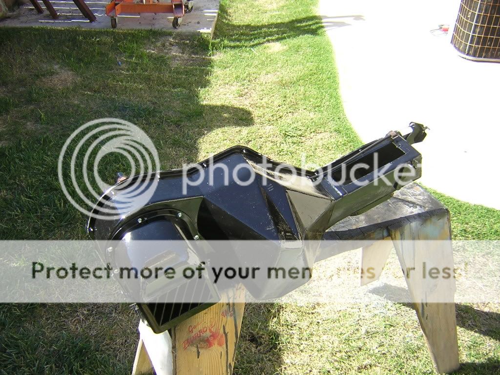

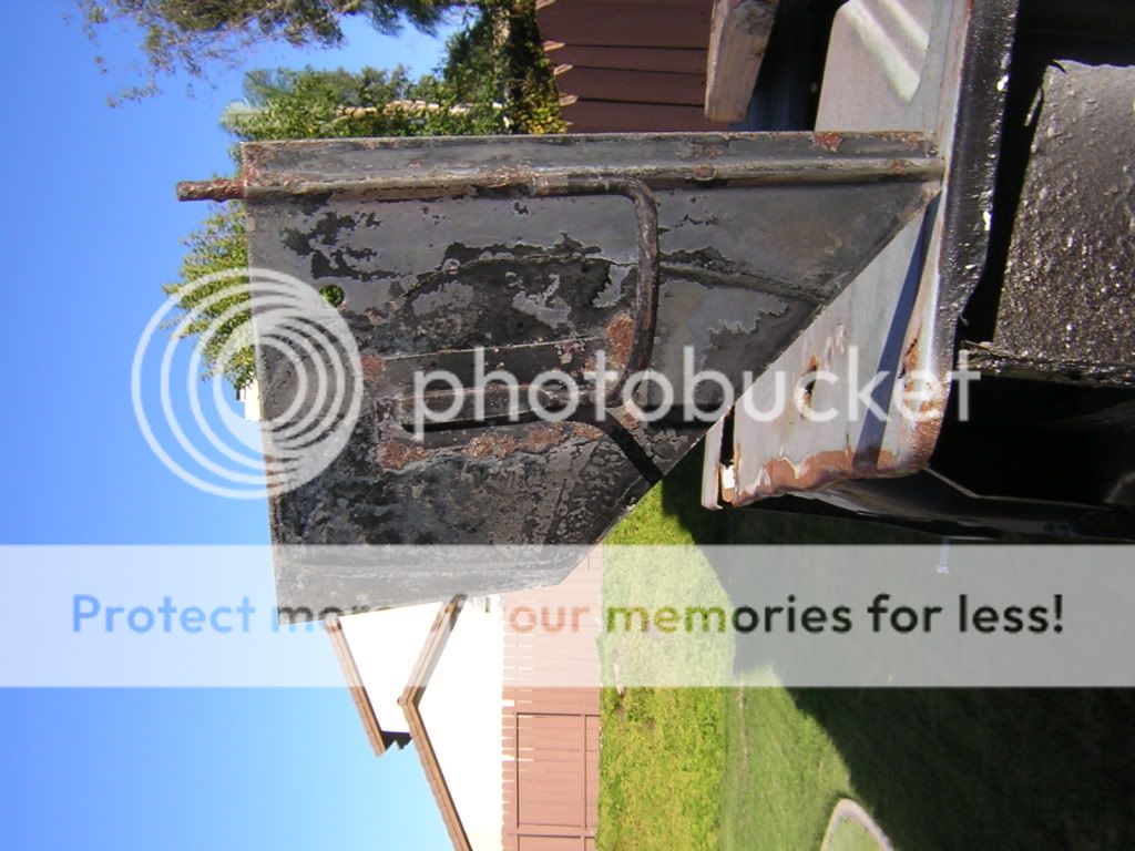

My build
Disassembled everything
Cleaned box
Painted box and metal cover
Used foam weatherstrip for seals
Completed Box
79 CJ 5 Frame up Build
