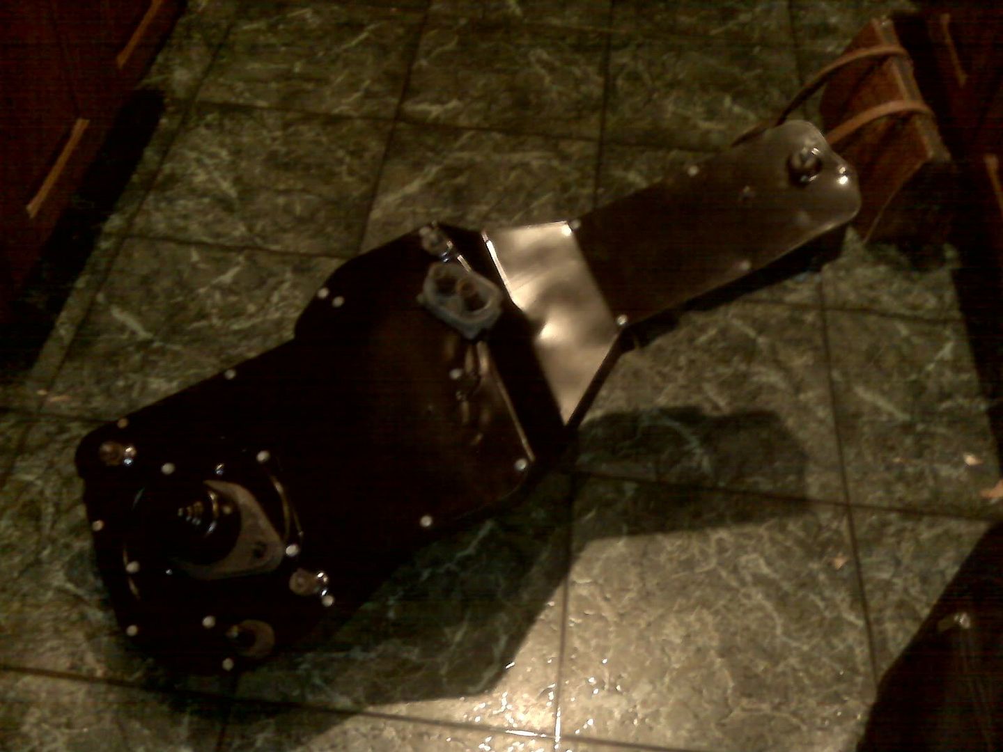

I just finished mine and installed it yesterday, although I wish I would have seen this thread first
I customized mine a little too though
°lllllll°
way_of_life is offline

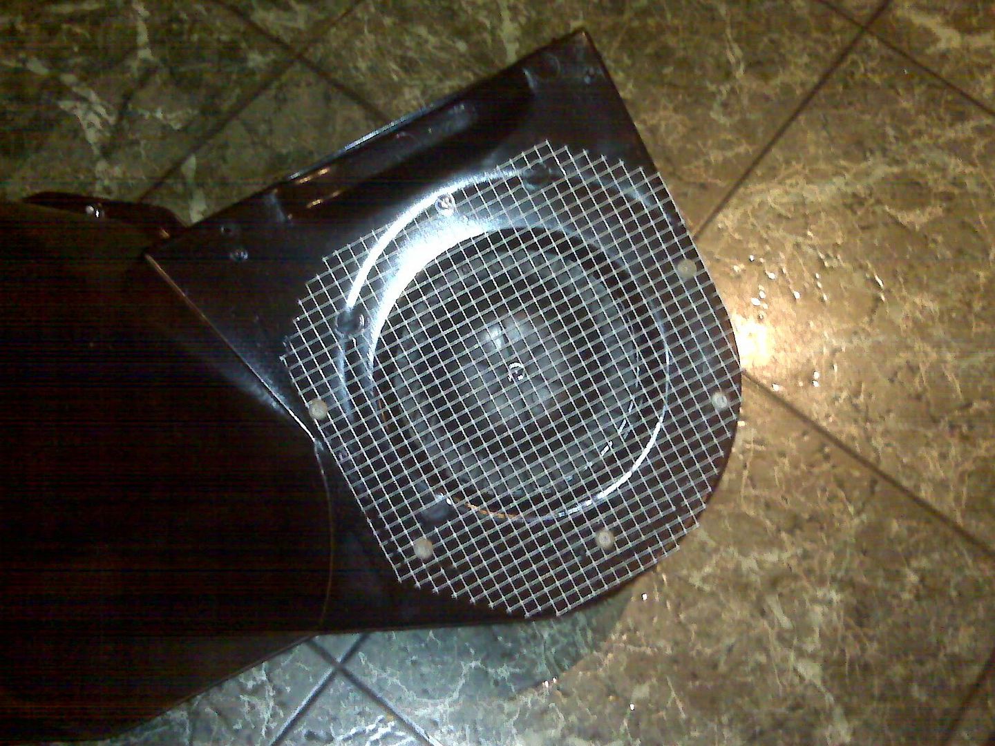

way_of_life
way_of_life's Avatar
1978 CJ7
Location: West Chicago
Posts: 270
Originally Posted by supersport126 View Post
Customized? Sounds like pics to follow...hint hint
Sorry to disappoint, but the most custom part of my heater is inside and I forgot to take pix of the insides before I sealed it up and installed it, and I'm definately too lazy to take it all apart to take pix.
Here's the basis of what you can't see in the following pix--
The outside vent (in front of the windshield, looks like a floor grate) I completely sealed off and removed the tube coming from it
The rounded piece in front of the fan (where the hardware cloth/screen is on mine) has been removed too.
Then, the bypass vent for the heater core (to switch from heat/vent) has been epoxied in place to heat only and a new heater core added. The floor vent/windshield defroster vent switch thing is still in place, and is now lever activated
Therefore, it is now full heat on (circulated) or off completely. I only ever have it on full or off anyways so it works for me. Plus the new paint makes it look nice.
°lllllll°
