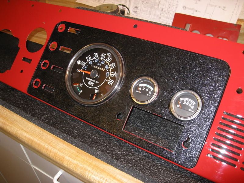

Keith, Is the radio bracket original or did you fab it. I had been wondering how the rear of the radio was supported.

Yes and no. I had an original like that one but have misplaced some time ago. So I made a new one out of stainless based on memory

Originally Posted by keith460 View Post
Next we installed the voltmeter and oil pressure gauges using original hardware. Would have liked to have taken these two gauges apart but they proved to be to difficult to separate the glass bezel from the gauge housing without fear of breaking them. You can't get originals anymore unless they are NOS or used and their was nothing wrong with mine except the faded florescent orange on the needles. So back in they went after a little cleanup.
I got mine apart, and proceeded to break the needles off when trying to paint them. Went through 2-3 sets of used gauges before I finally got some done and put back together!
