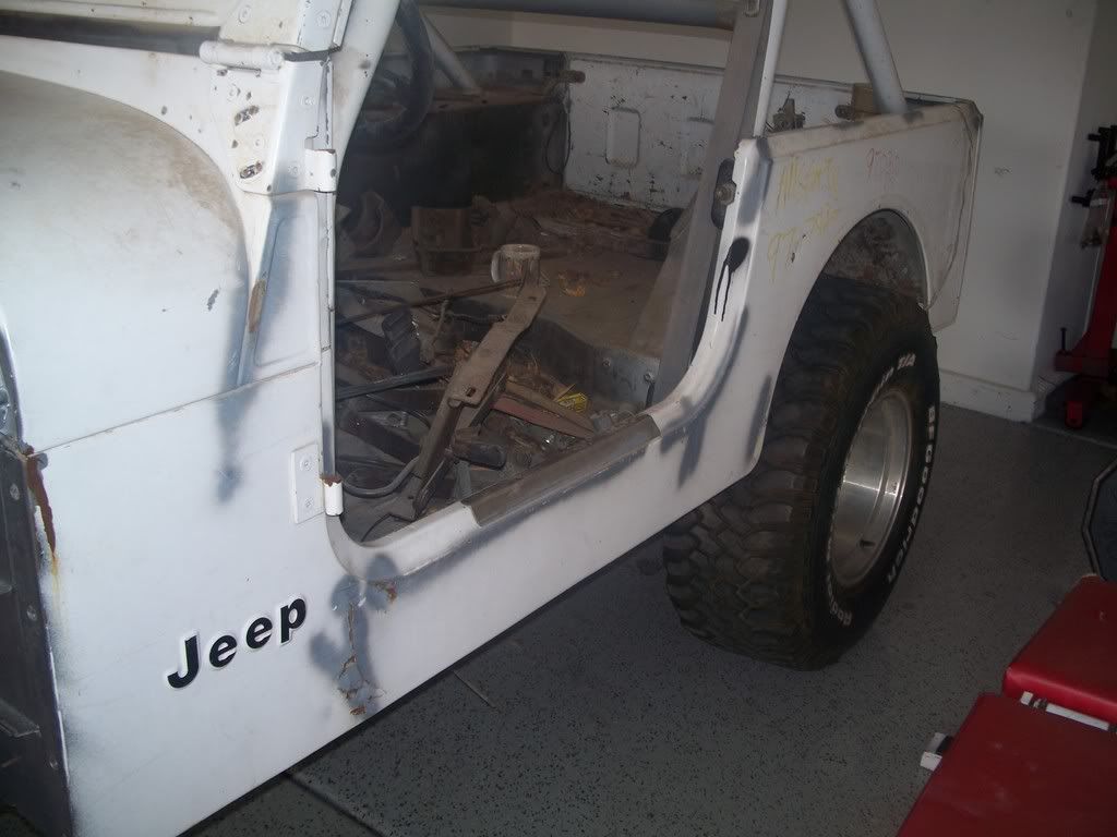

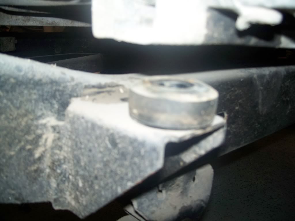

Had some time today again so I dove back in. I got out the stuck door hinge torx bolt by drilling out the center and hammering an allen wrench of near equal size into the center and unscrewing it. That left me with two more stuck Cage Torx bolts. One came out easy after a few days of lubing it. The other, well lets just say my grinder took care of it. All FN' Torx bolts will definately be replaced with hex head bolts on this project.
Anyway I pulled off the cage and stripped the rest of the tub. I unbolted the tub and checked the mounts again to find that they are solid all around. The floors under the cage mounting plates are solid too, just some minor surface rust.
I found a repair weld on the front right frame rail. Doesn't look bad, if I grind it down to smooth it out will it weaken it?
I took a deeper look at the left rear corner bondo spot and chiseled away at it. It is alot bigger than I thought but the metal underneath seems workable. looks like I'll learn some metal work on this one. The driver side kick panel under the door is the only place I found that is rusted through, about the size of a quarter.
The left rear wheel tub seems separated from the body panels at the seams in the damaged area so I'll have to work that out also and weld it back up.
I've been kicking it around and I think I'm gonna pull the 350/muncie/dana 20 and put in my 304/th400/dana20. I just don't want to shift in the 115 degree heat we get here during the summer, I like my amc's and my autos.
The 350 has an edelbrock performer intake, aluminum valve covers and what looks to be an HEI distributor. It's been sitting for some time out in the desert climate without exhaust manifolds and I can see the valves have just as much dirt inside as the motor has outside. It will need to be torn down and freshened up anyway, the muncie and the dana 20 look newly rebuilt but I haven't looked inside of them yet.
