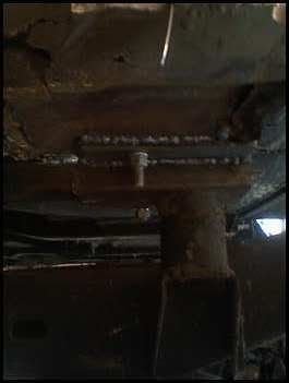

I did a piece of 1" x 3" box channel and cut sections to fix mine. I hole sawed the top and welded a nut inside of the channel sections, bolted it and welded the nut and then welded it all in. Works great. I should have some pics somewhere like this at the home pc. I should have just found a tub, but had the steel and time. You can see the sections.
[IMG][/IMG]
[IMG][/IMG]

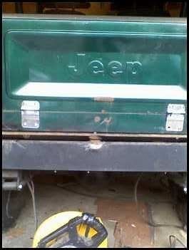

For the rear mount, I tried something new and went center only. No issues yet.
[IMG][/IMG]
