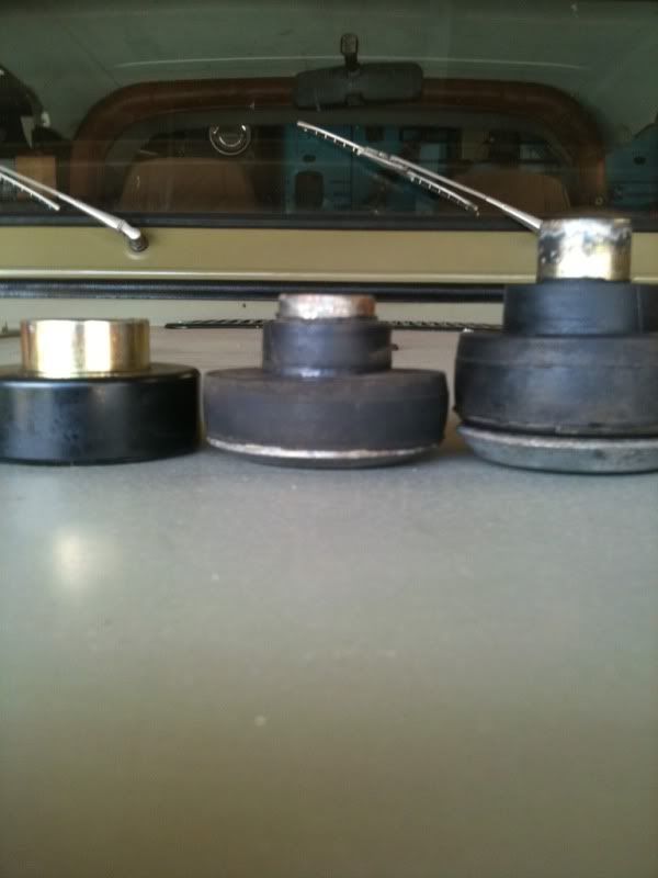

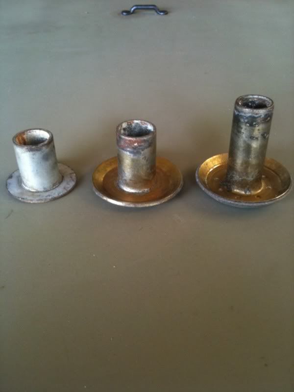

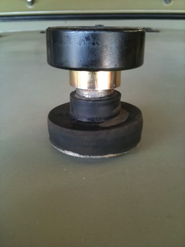

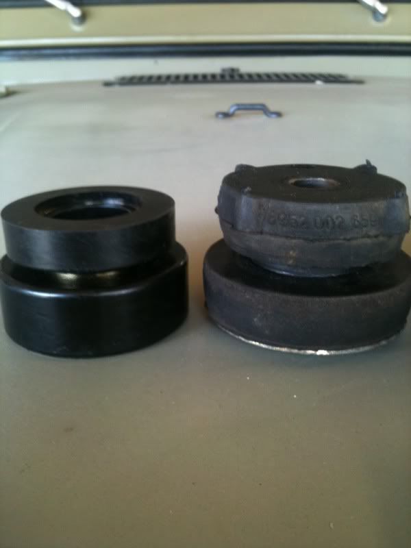

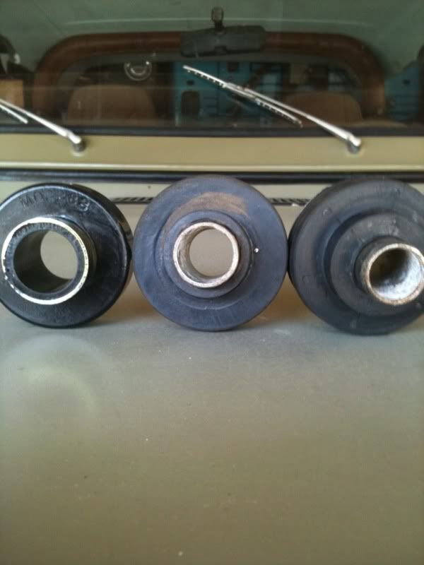

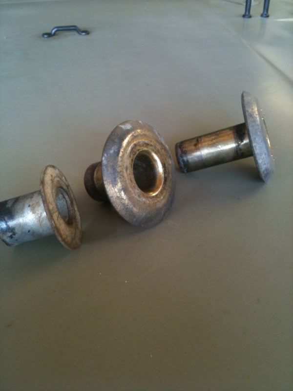

You may want to look into the smaller of the two sizes used on the YJ/TJ. The design, fit and quality are FAR better than the CJ type. They are the same size as the CJ mount in both hole used and height. They use a one piece domed top to cup and hold the rubber better. Ive seen almost very little splitting in the rubber vs all the old CJ stuff splits. The inner sleeve is encased in the rubber and the bottom bushing has a built in bottom washer for the correct preload. Here is some random pics from another thread. I used a poly CJ bushing to compare next to the smaller of the two TJ bushings.
As much as I want stock and original parts on my CJs, unless I'm going for a FULL correct restoration, I use them all around. 10 on a CJ-7 and 12 on a Scrambler.

Where the CJ uses the same size mount all around, the wranglers use two sizes. The larger ones are the 6 under the main floor. These do not fit a CJ frame unless you want to die grind the mount holes slightly larger. I did this to a hunting camp jeep (read as not a rust free or perfect frame) and it gives about a 3/4" body lift. The other size of wrangler bushing is the smaller size located at the rear section of the tub. These are located at the same place as the CJs with two in front of the gas tank and one each at the back corners. It is these mounts that are the same size as the CJ mounts.
Buying a new YJ/TJ set will NOT give you the total bushings you need. You would need to gather the smaller bushings from several wrangler part outs or call a Jeep dismantling place.
They may be confused and not understand what you are doing. Just tell them its a special project and you need 10 (or 11 if you do the front grill) of the smaller of the two sizes. You dont need the bolts. You will be using a different size thread that fits the CJ tub. Each mount will be 3 pieces consisting of the metal shell, the upper rubber, and the bottom rubber/washer combo. Unlike the CJ, this part of the mount is fused together. The last set I bought came from out west so they weren't rusted. With shipping, just under 100 bucks. I showed the customer the difference in the two styles and he was pleased with them.

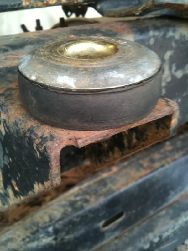

Wait until you discover that two or three of your mounts have rusted out or severely pitted out holes where the bushings rest. They may look perfectly fine from the outside but utterly destroyed on the inside. Even the dryer, salt free areas of the country can experience rusted out mount holes.

That's why I went with the bigger sized bushings on this one budget Jeep. It was easier and faster to die grind and clean up the holes to the larger size than repair them.
