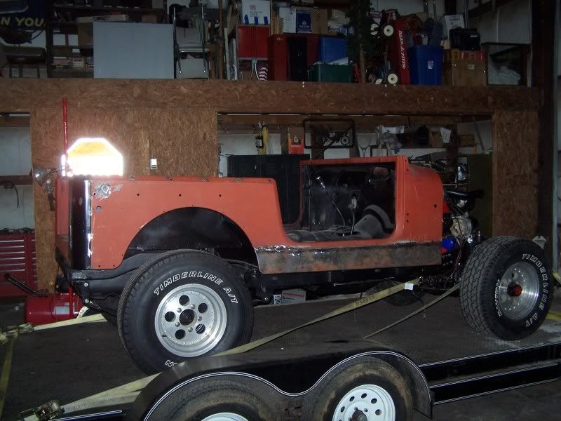

This is my somewhat DD BDS 4 1/2 lift. I love the ride and the warranty is the best. No bull**** replacement. Had it on in 2.5 hours!
